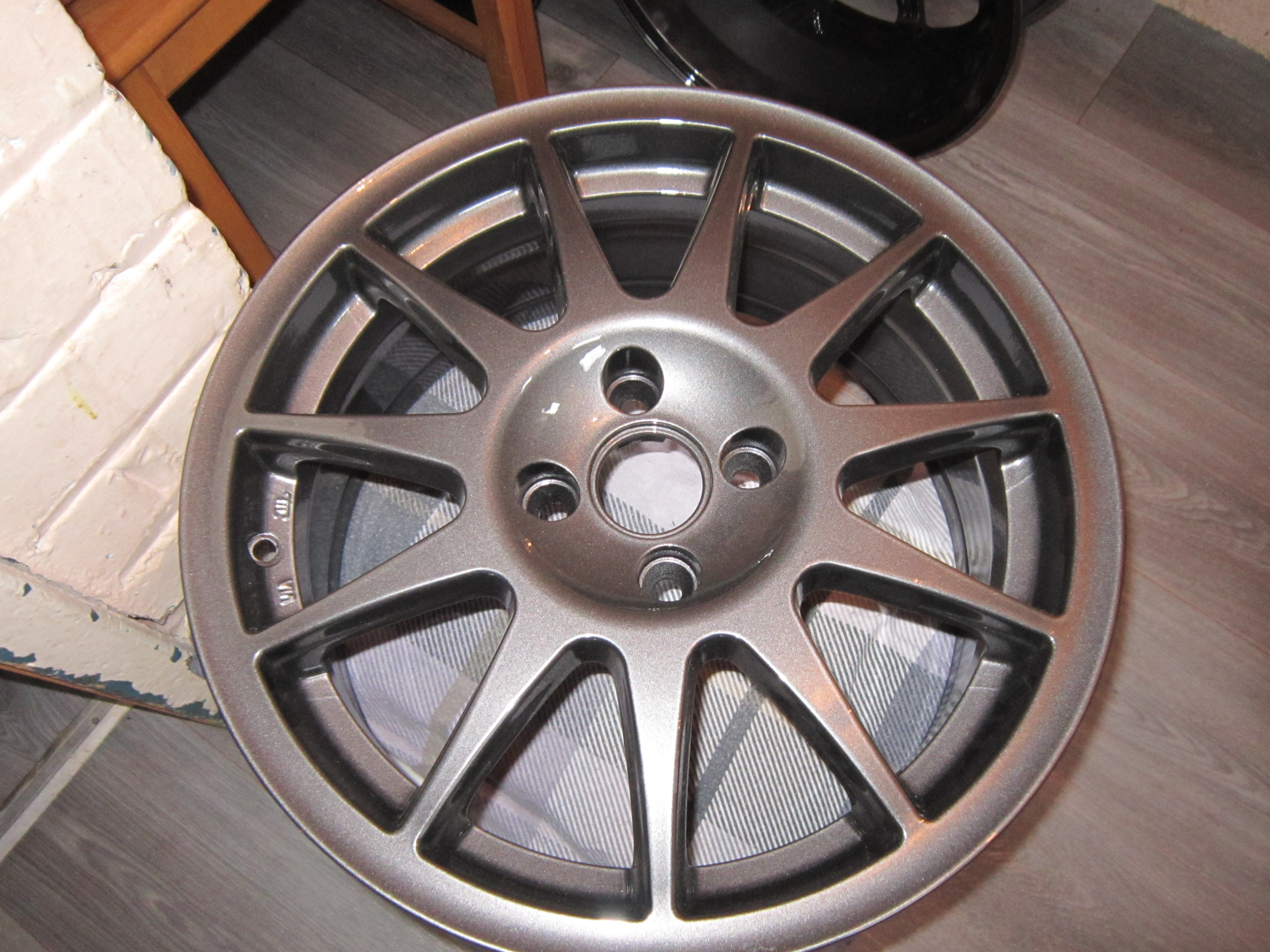

Hello chaps, I have had a set of Turini's powder coated... I say a set but they are not the same, two are off a trophy (larger centre caps and wider wheels) and two are standard off a normal clio.
The tyres I have are on the normal 182 wheels.
Can I use the tyres I have already on my new wheels? Where would you put the trophy wheels, front or back? Will the trophy wheels need different tyres? Will the narrower 6.5" wheels need diff tyres?
Hard to explain. Basically the tyres I have are PS3's all pretty new still, I need to know if they will be good on diff rims, or do I need to save for new ones again. £140 a boot is no joke.
The two sets of two turini have diff offsets, diff widths, but all came off a clio.
Had them powdercoated six months ago and they are just sat in my boiler room wasted. I want them on the car now.
  2014 Clio 200t edc

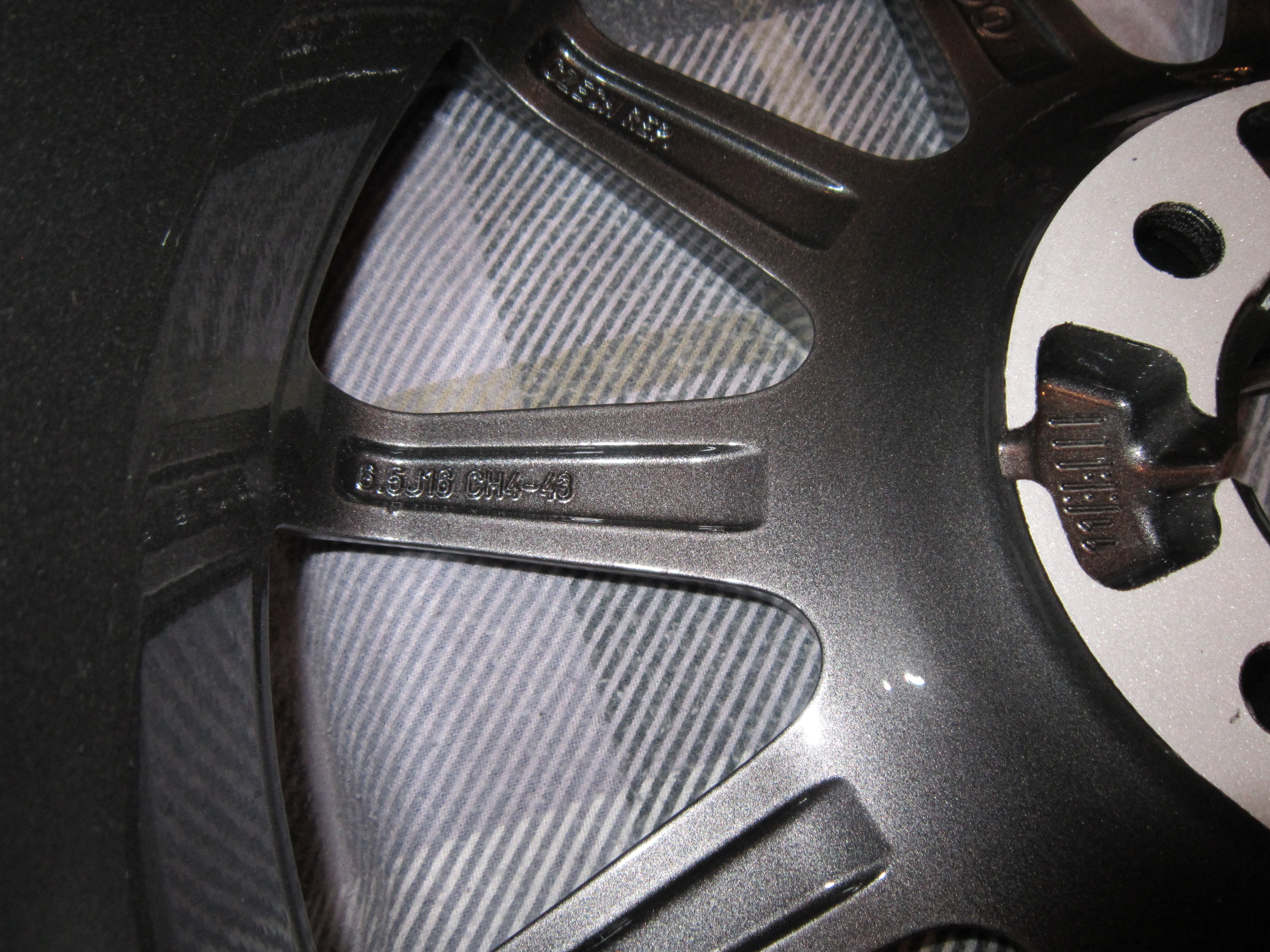

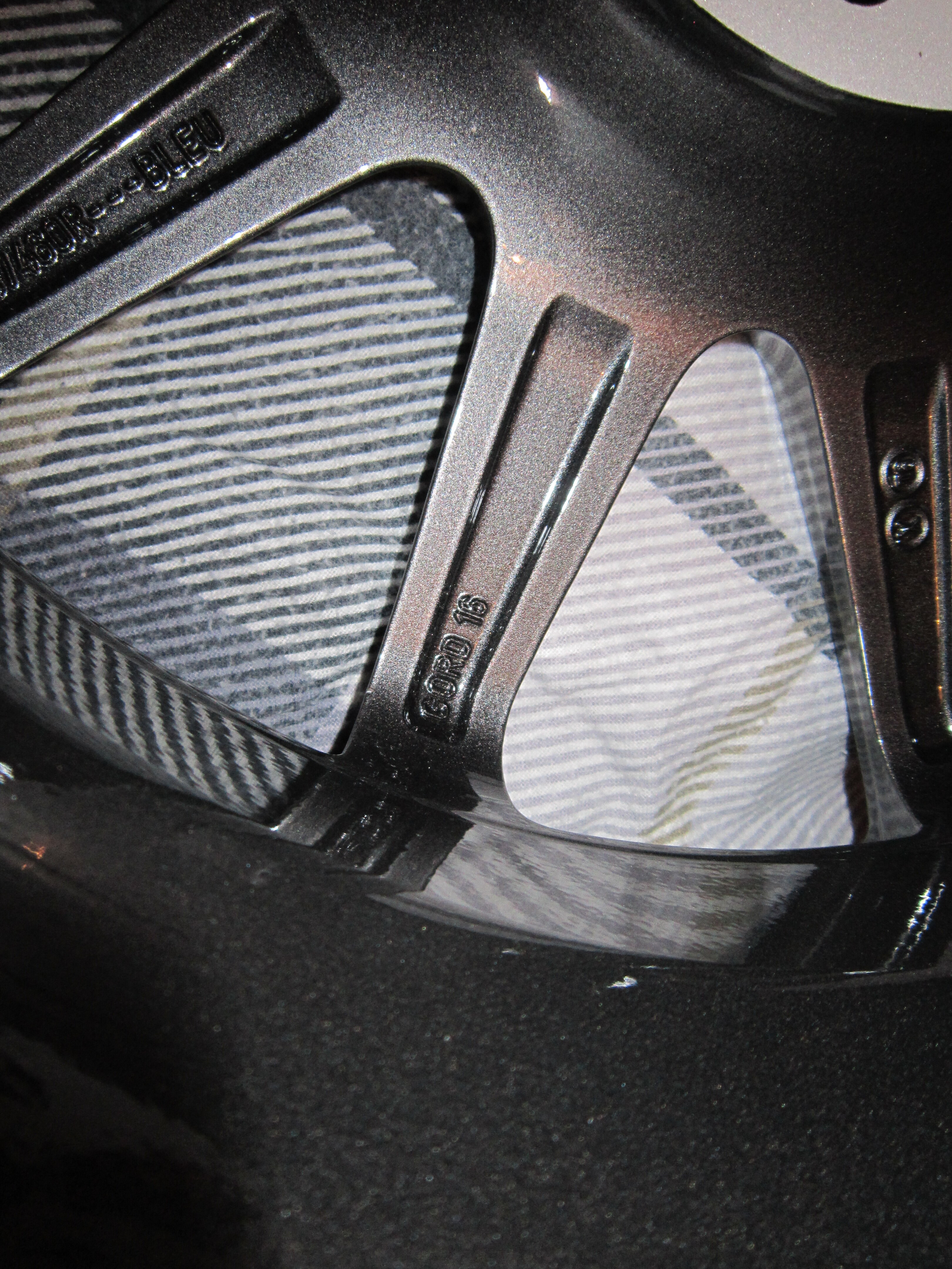

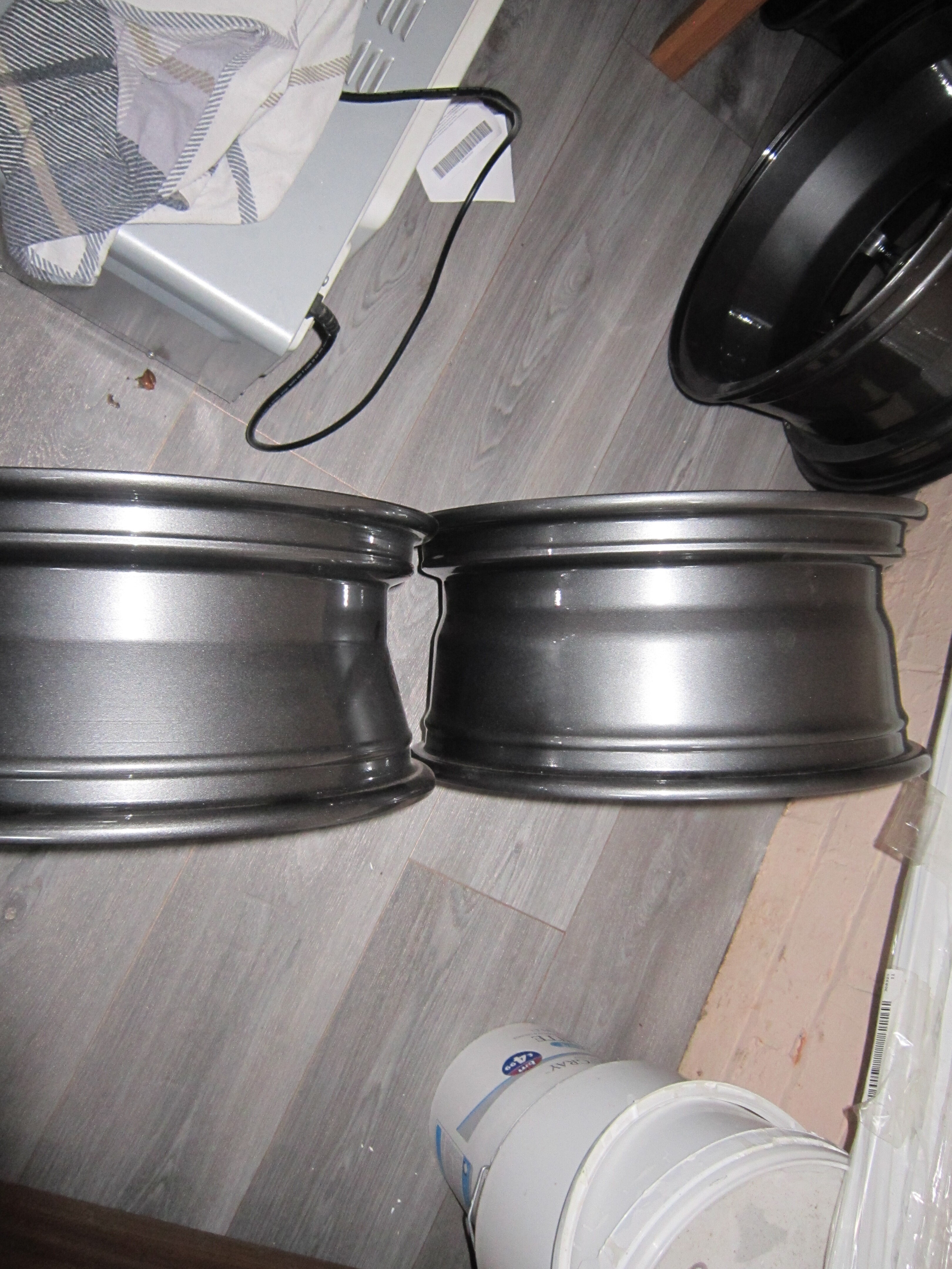

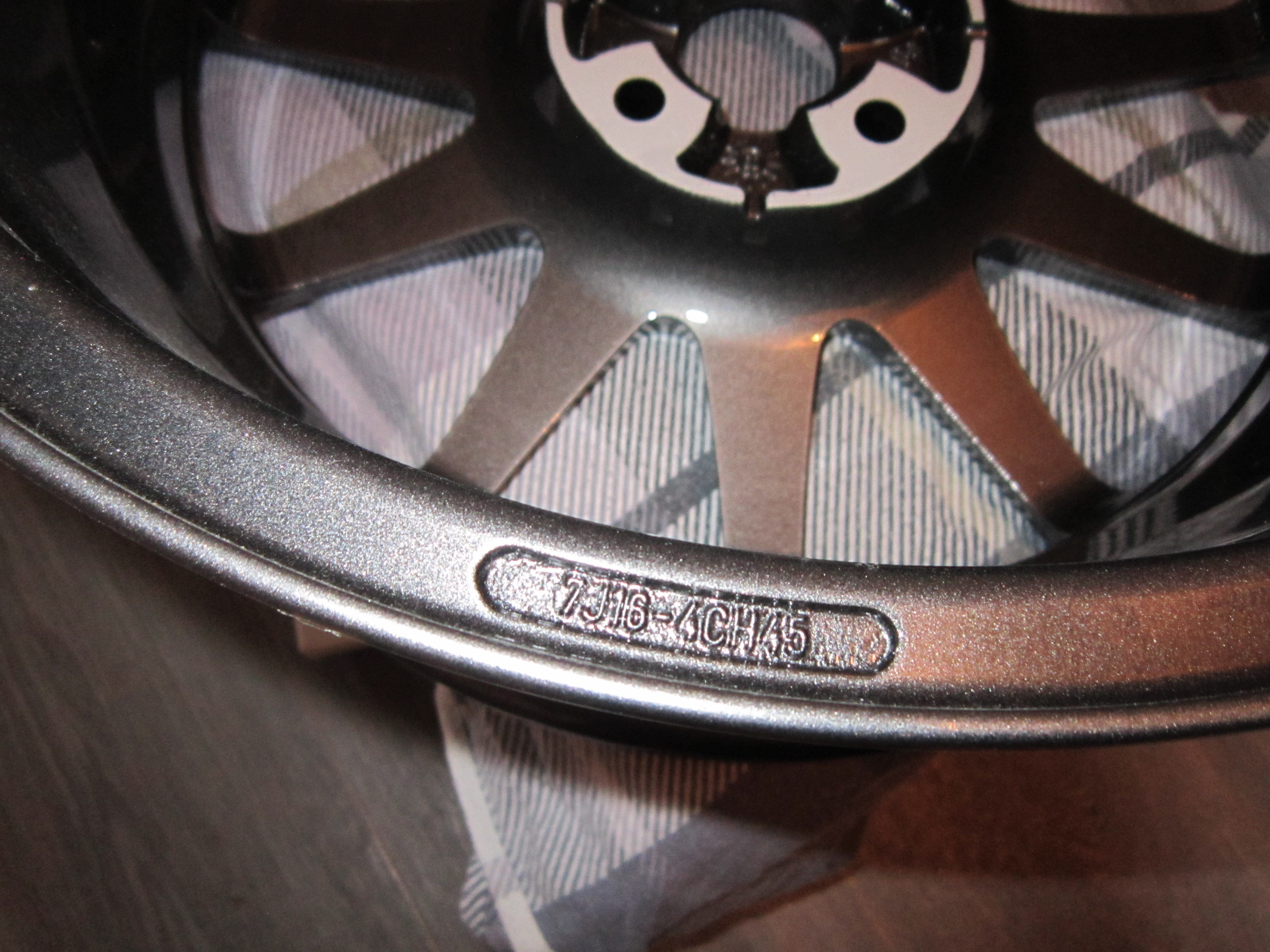

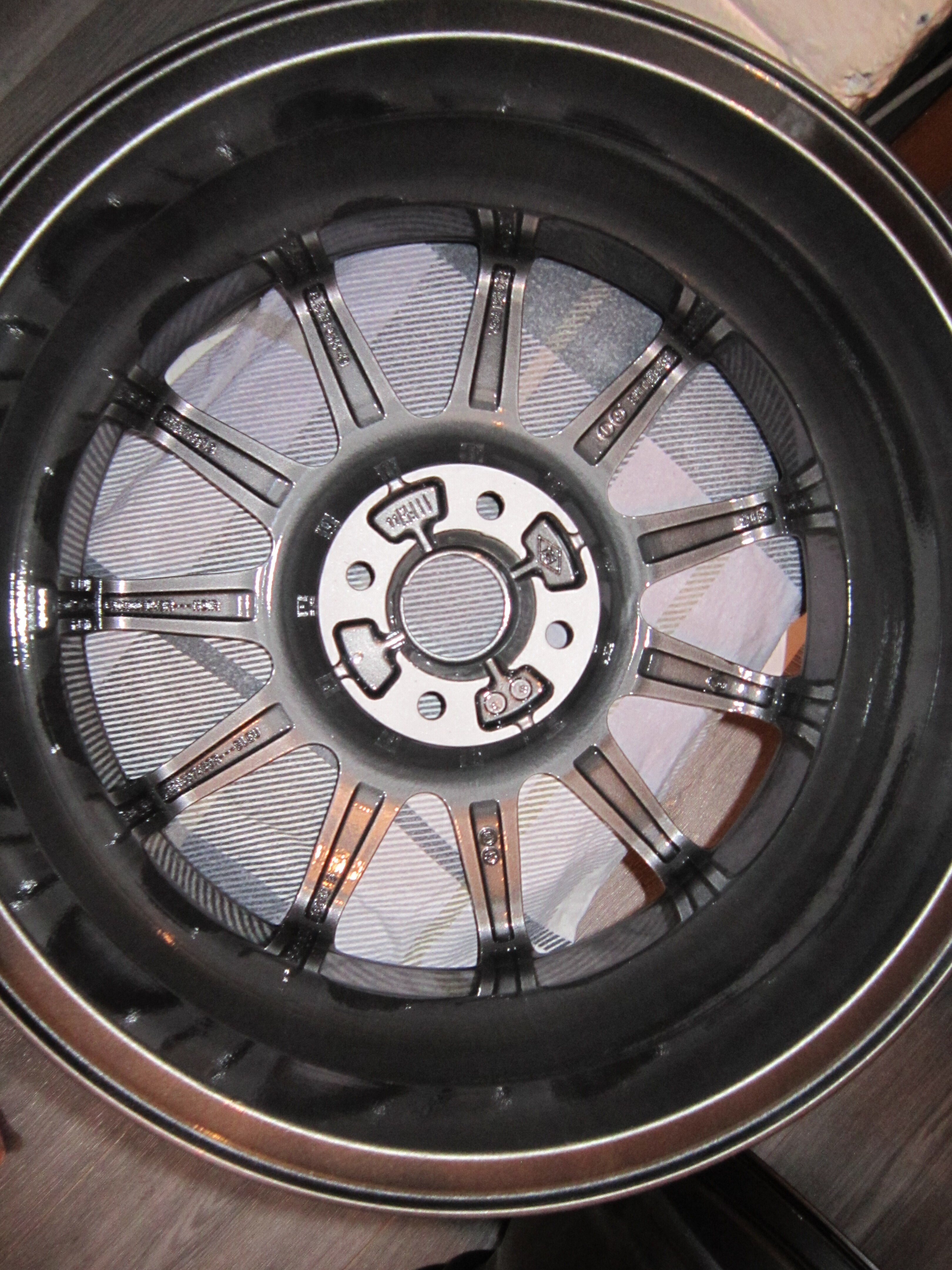

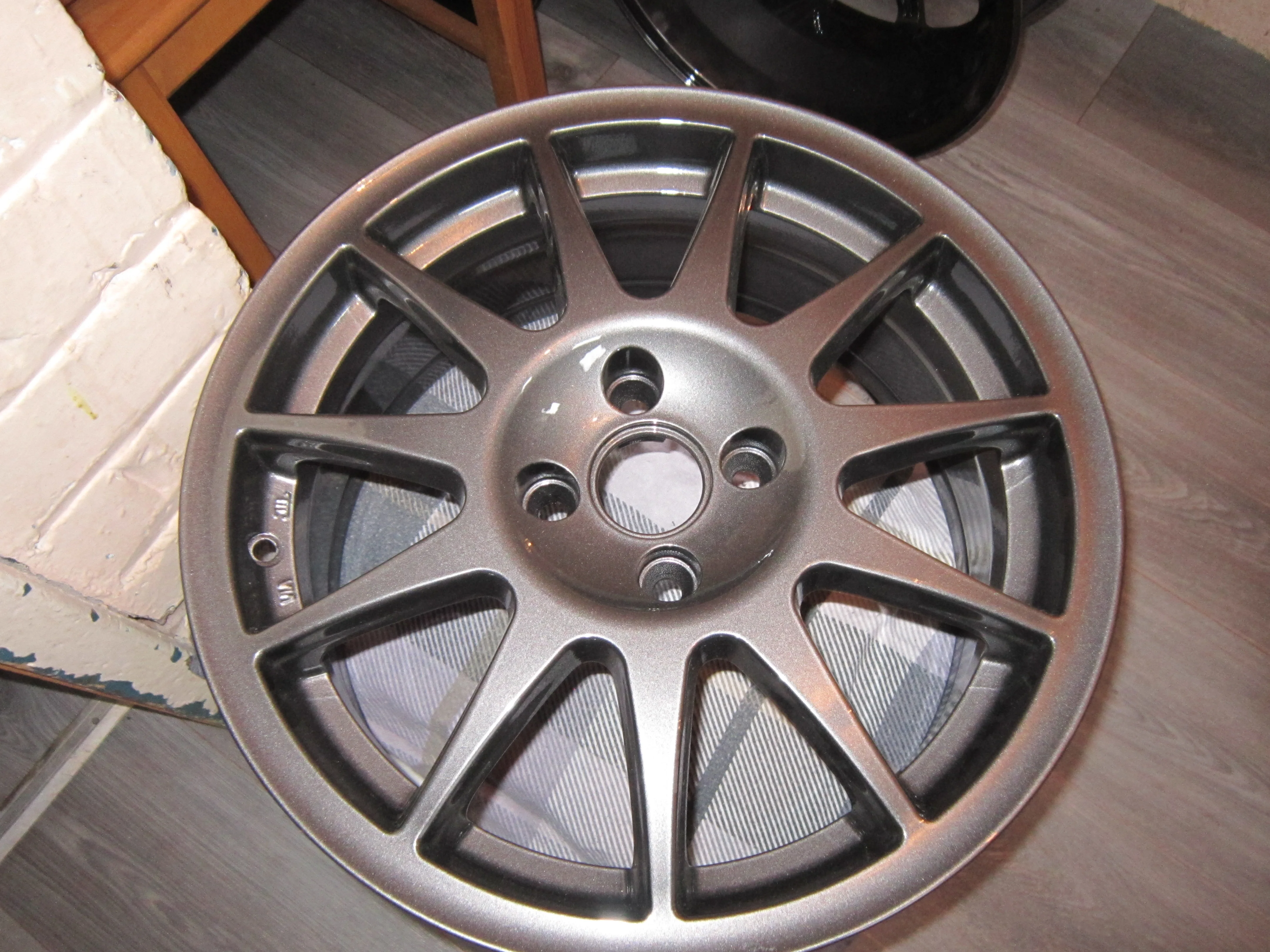

Definitely two diff widths. Pics for proof.
I don't know mate. There is a renault diamond on one of the spokes, also GORD... Off a Gordini of some make? Could they be off a twingo or something? Are they going to be good on my car? Still none the wiser to be honest.
  2014 Clio 200t edc
They might be Renault accessory parts having a Renault badge on them, because I’m sure the twingo wheels were 15”.
So where for what then? 6.5" et43 and 7" et45. I always thought the wider trophy wheels would be better on the front. When I think about offset and width together it melts my brain.

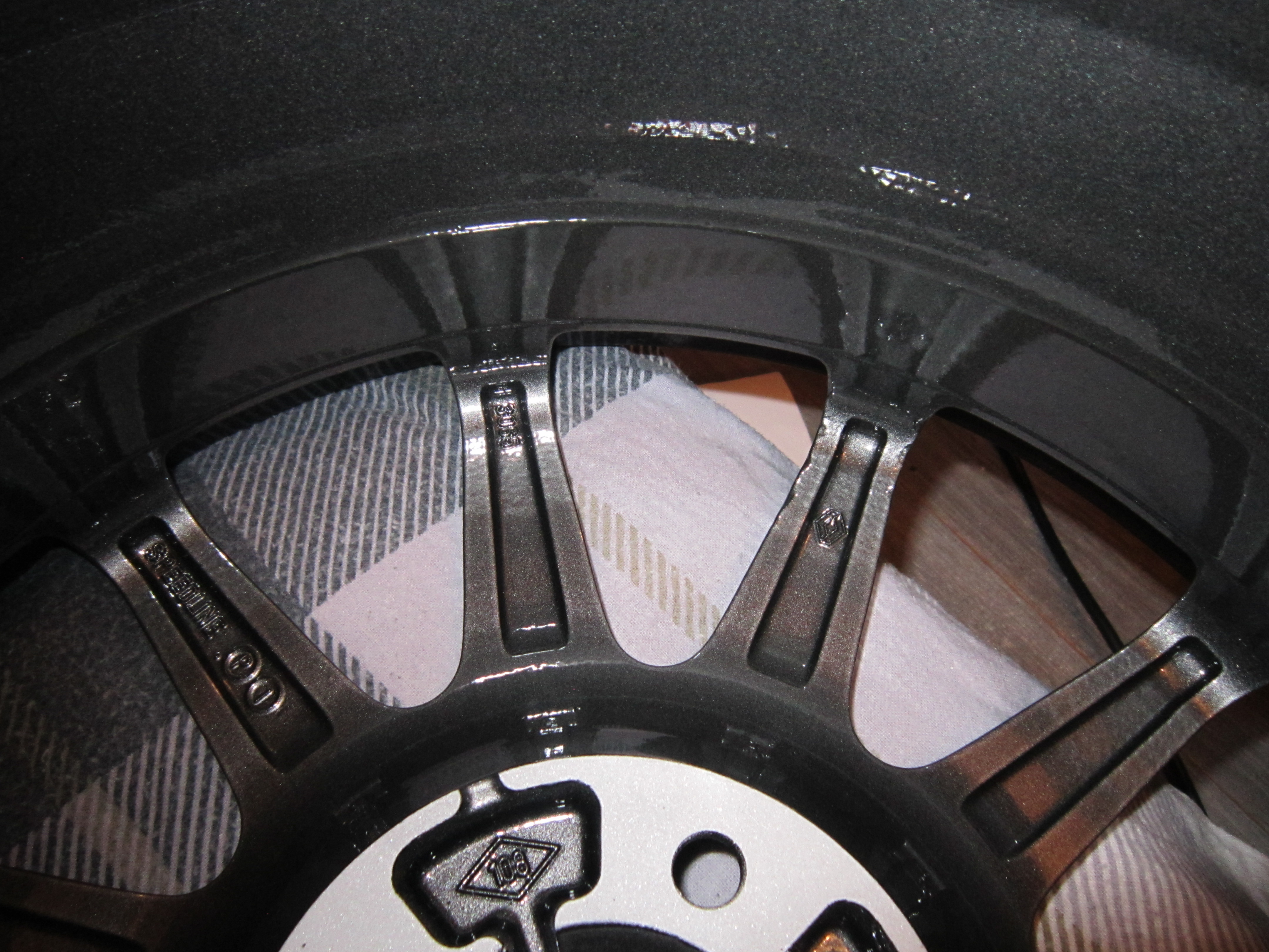

Also, the centre caps. The trophy caps are noticably larger and with larger diamonds. I painted them black/gold same as the car. Really I want them the same as the wheels so the size difference is less noticable. How would I go about matching the colour? Or how much would a paintshop charge?

Matching pairs per axle. I doubt you will notice a difference where either are fitted.
Id start looking for a matching set so you have 7j all round. See the occasional single trophy wheel come up
