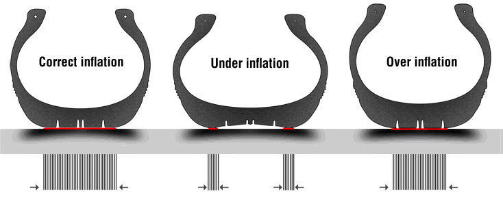

50psi isn't exactly recommended due to reduced contact patch & increased wear but if it's the only way to get a balance that you're happy pushing on with then fair enough. Maybe a benefit specific to track days (relatively short runs) and cold places is that high pressures promote movement of the tread block and generate surface temperature quicker.
