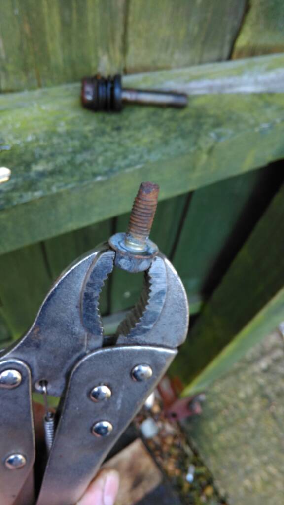

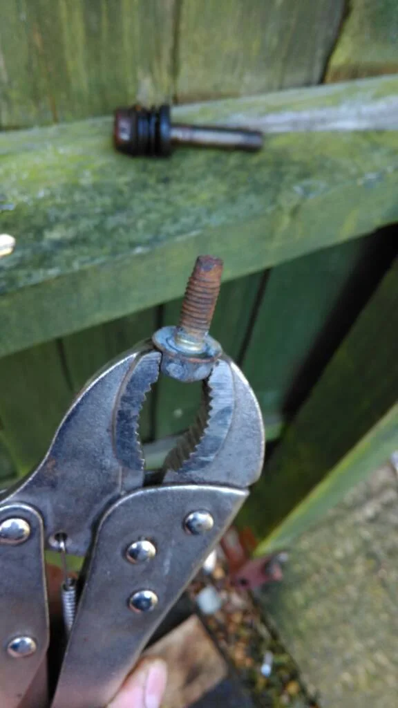

Possible culprit I think found on the earth strap, which is turns out to just be a battery strap.
