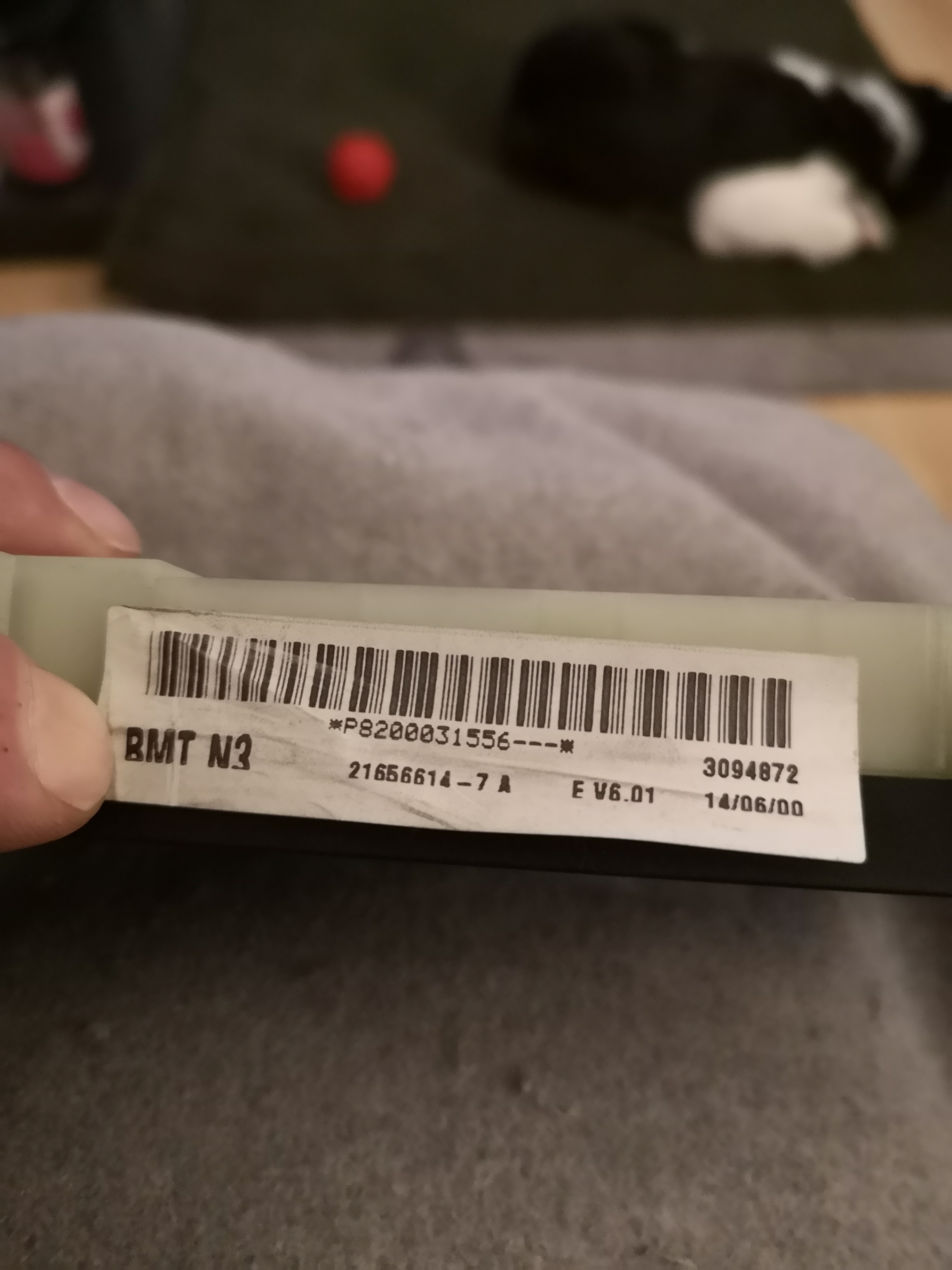

My son has been given his grandads 2000 1.2 8 v clio well looked after from new,to learn general mech etc etc.
It seems to have developed the usual fault uch issues damp or possibly wet over years.
I'd say ours is a white cassette type white in colour which I can't seem to find anywhere to repair it at all.

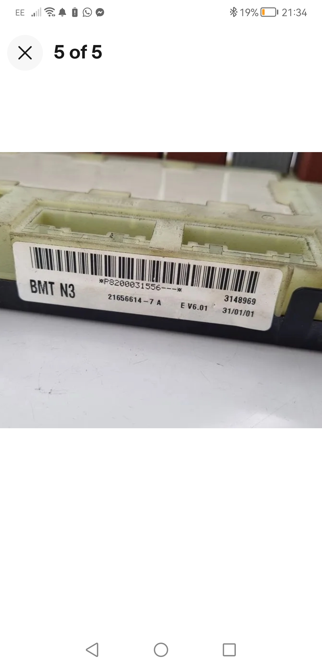

Pic attached. Found one which matches all numbers except one. Been told the n3 is the most important part as that's the level of what it does.
Anybody know if I get the one pictured I would still need a rewrite
Thanks Jeff
Mine is the one on right number above date is only difference

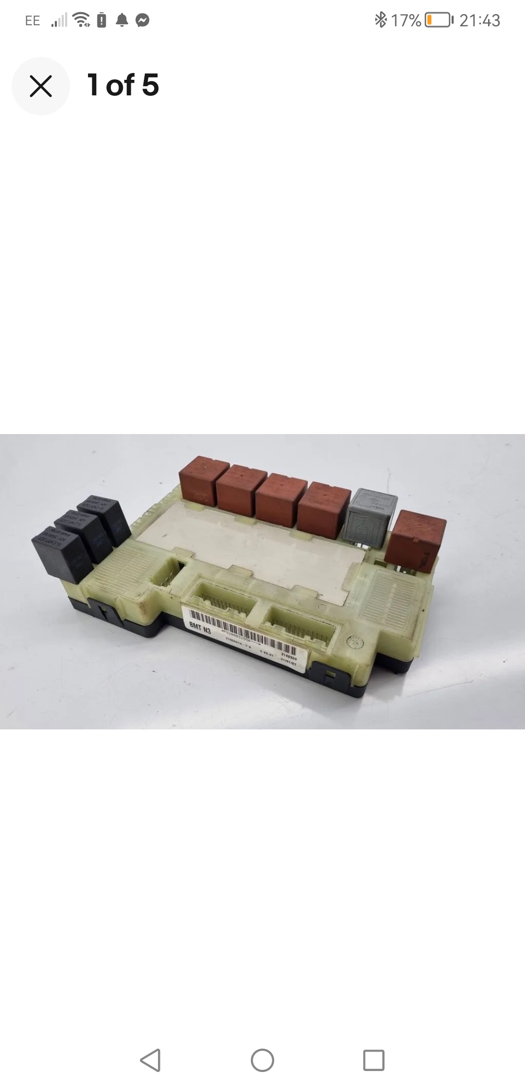

I'd send it off to dieselpumprepair2 on eBay, highly recommended on here and from his eBay listing he repairs the N3 units.
Thanks for the reply I messaged them with number and they can't do it.
Looks like only do the complete black euh mine is the white box which slides out of the holder leaves wires on holder this type

My ph1 172 also has that type and they told me the same, if you do find a repair person please drop into the thread

Would anyone know if the number avouve date of manufacture is important or even what it represents.
I've now found 2 exactly matching numbers except the date made and number above it.
Cheers
