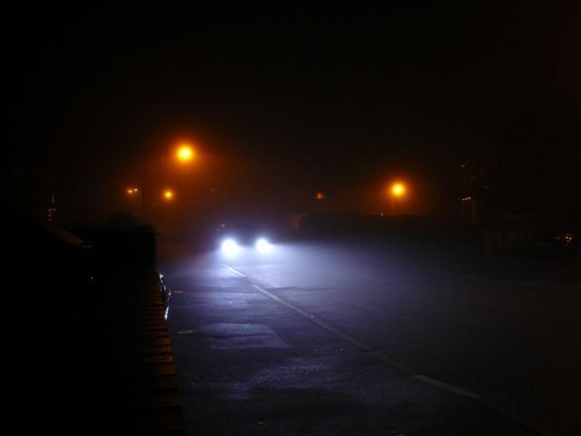

my 6000k philips ultinons

it also makes a difference with the kind of lights you have...for example me and my bro both have the same HID kit but his lights are reflectors mine are projectors. Projectors make the light less blue but i like it to look a bit more OEM.

Does anyone have anymore pics?
