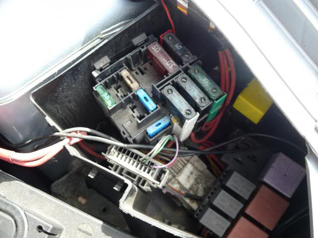

Just bought my 172 n luv it! Windscreen washer pump is dead, is there a fuse for this under the bonnet? and does anyone know what fuse/relay is for what in the engine bay as i have no info. Any help is appreciated, thanks!!

I know this is an old thread, but thought id give it a try. :eek:
The small 30amp fuse under the bonnet on the top left of the box. (pic below)
Any idea what this operates (on a 172 / 182 )
