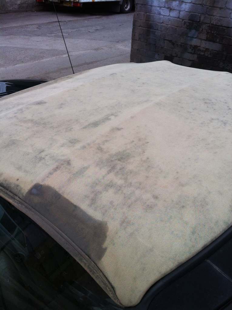

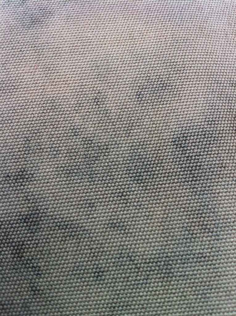

Guys, I've just taken on a job I wish I never....
Got an Mgf with a tan mohair roof. It's been stood under a tree and is mired in mould and s**t.
I've had interior cleaner, basic TFR and extra heavy duty (neat!) on it, scrubbed it, had my 90c 1600psi steamer on it and nothing is shifting it.
I've promised the bloke I'd get it clean and it's a good earner for me so I need to sort it.
Any ideas???

What about thinners?? Or will I f**k the hood good?
Bluebeard
  Whichever has fuel
Excuse the dark patch. That was thinners.....

f**k me! That is quite far gone!!!!!!!!
A wet vac would at least extract from the pores!

Wet vac hasn't touched it. Just tried it.
I've just soaked all again with neat anti bacterial stuff from the snap on man who was in next door.
Stay tuned...

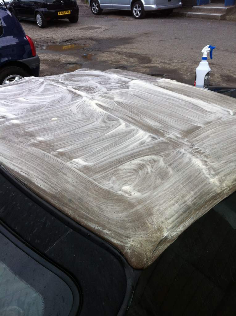

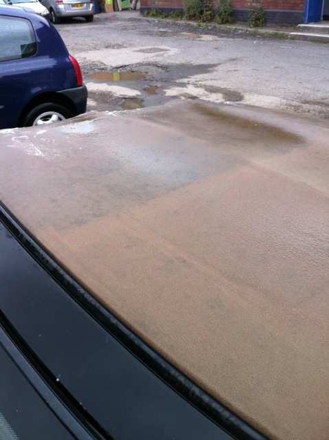

Boom!! Chappers to the rescue.
Chemical guys stuff.
During scrub;
And after a session with the steamer set to 100 degrees...

Chemical guys stuff. I tried it neat, but it made no difference diluted, it still worked the same.
I've left it in work with the heater on low so it should be bone dry in the morning. See what it's turned out like.
