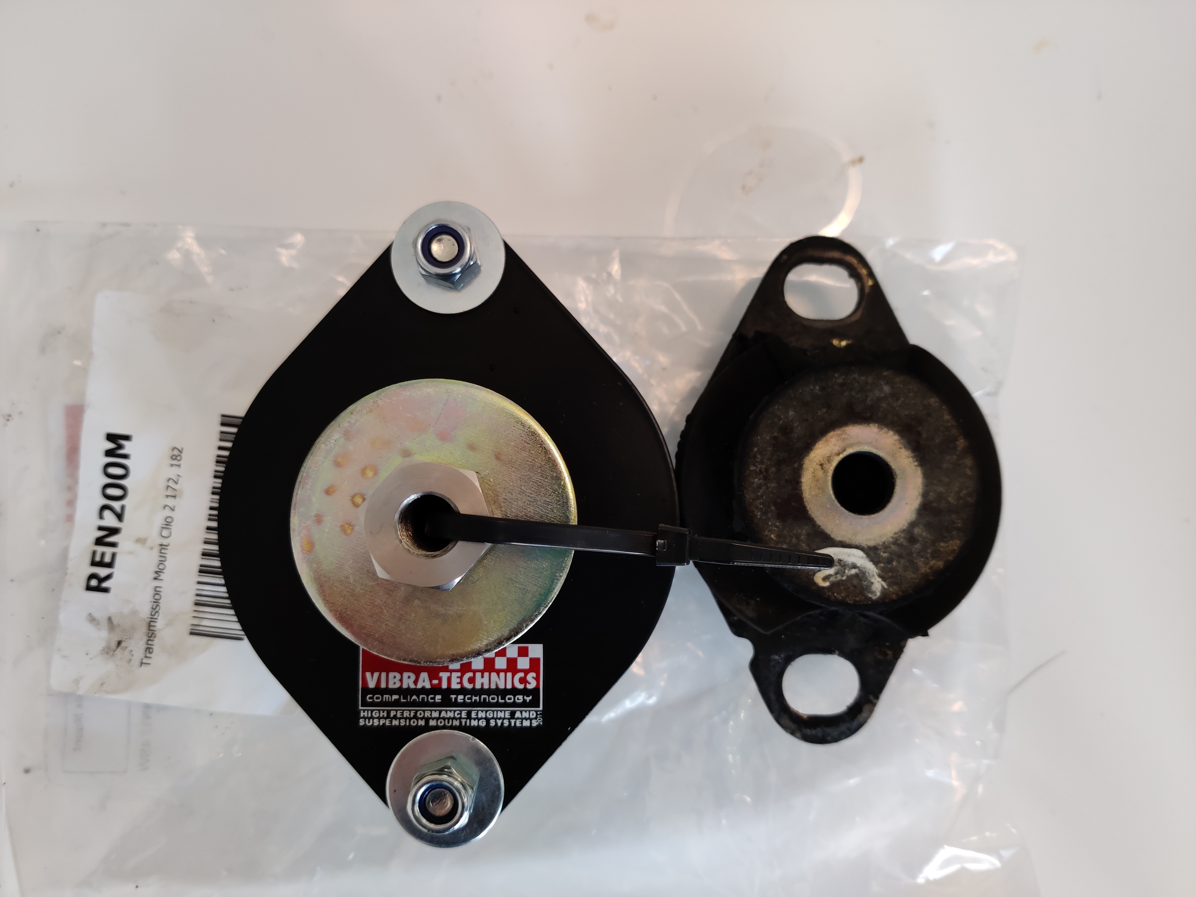

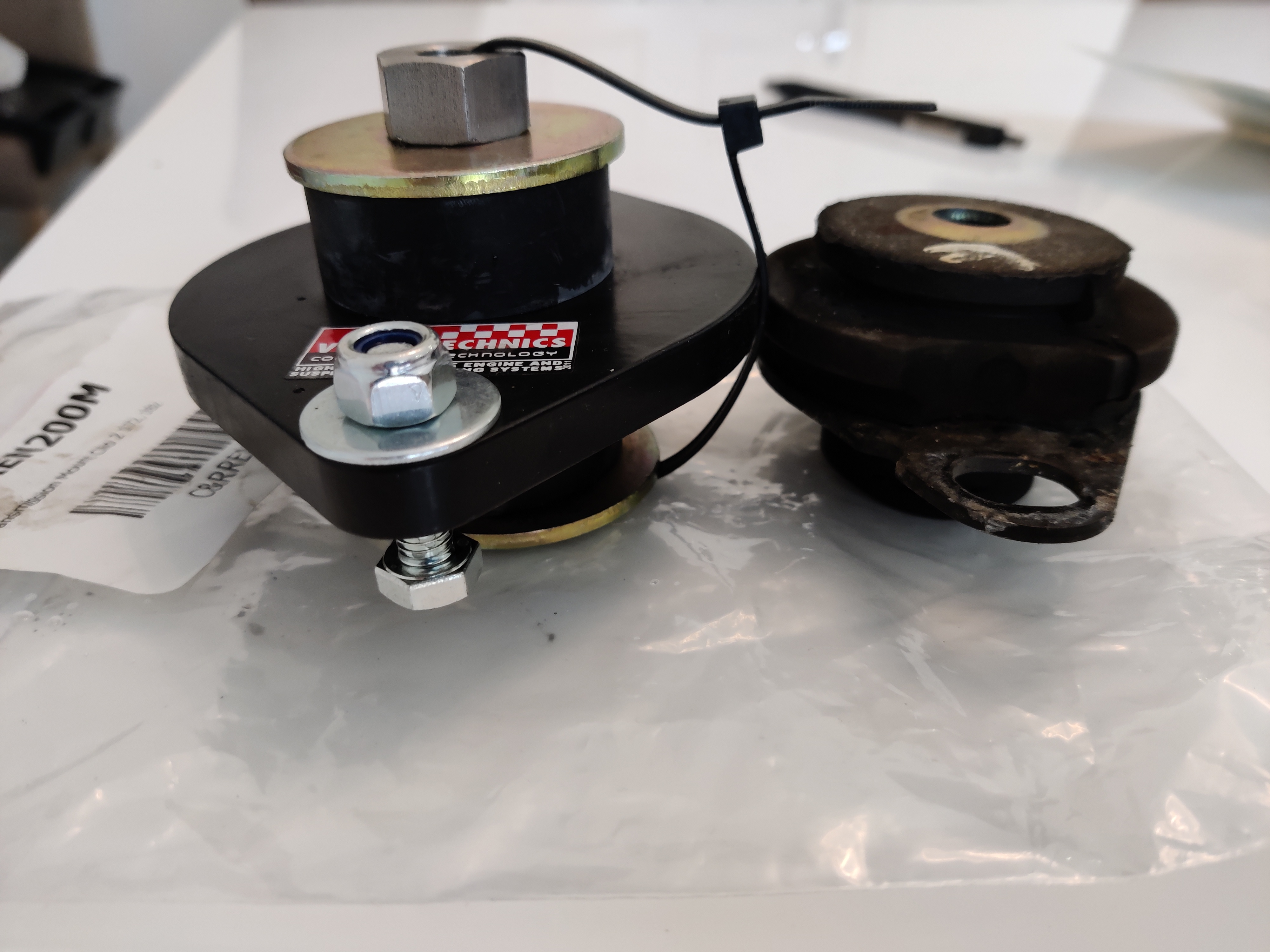

So I attempted to change the gearbox mount this morning, with a vibra technics mount.
It seemed large when I received it. But didn't think it'd be an issue and it didn't register that it was different to the picture advertised.

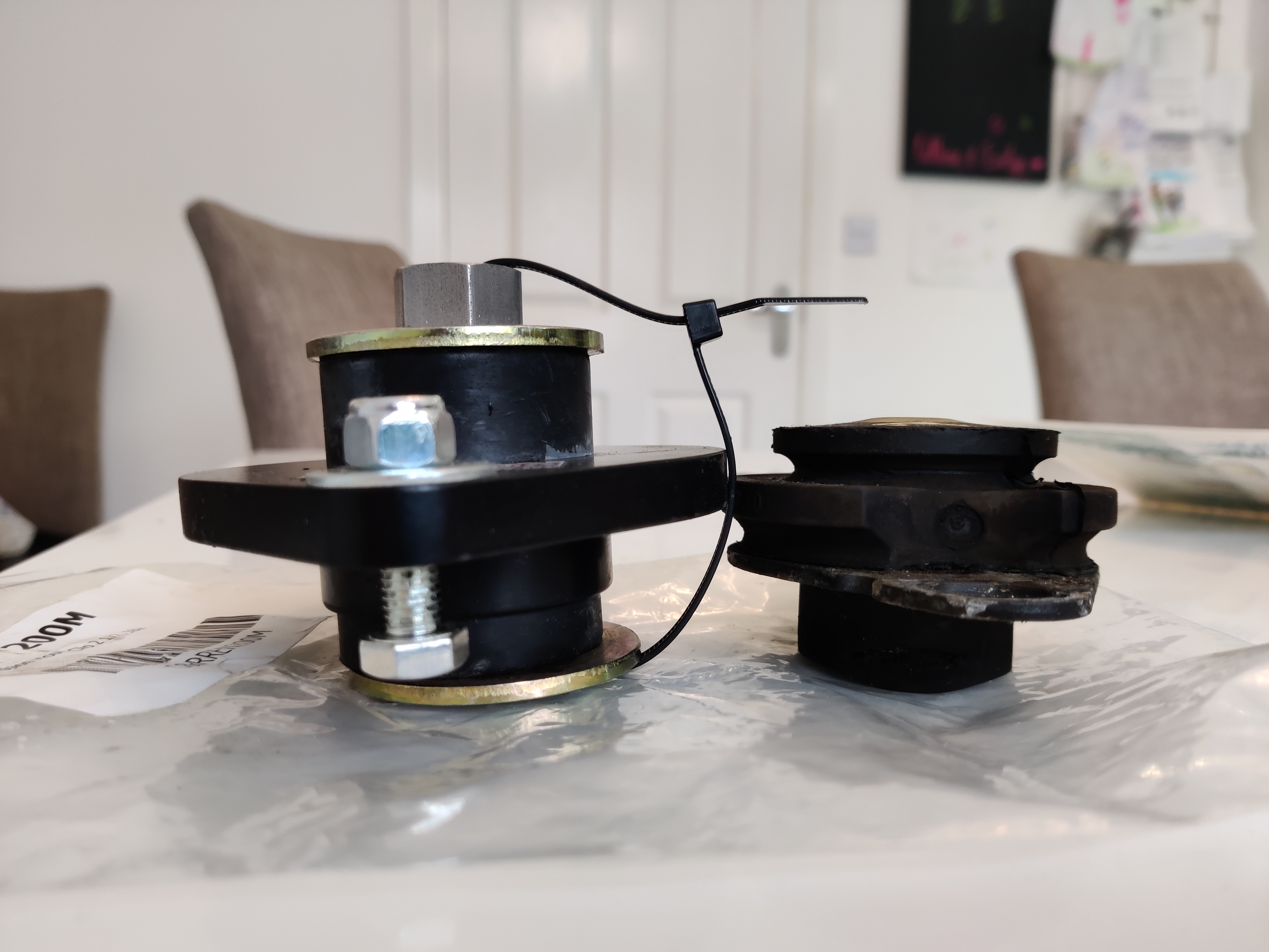

Anyway, it doesn't physically fit. Can anyone confirm I've definitely got the wrong part. The part number was correct on the packaging so not sure what's happened.
Original one next to it for size comparison.

Cheers guys for confirming. I know designs can sometimes change, and advert pictures aren't always of the actual item.
Weird that the part number is correct though.
