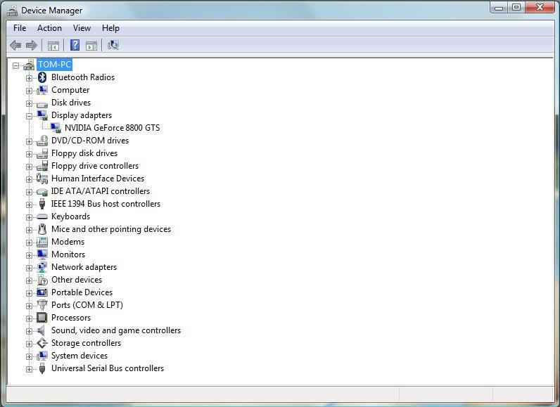

I had to format my work computer with XP sometime ago. I never bothered to reinstal the drivers for the monitor as i basically didn't know they had any!! lol it worked fine with just plugging it in... but when you scroll down pages in programs/internet it is jagged and not smooth. I presume an issue with the drivers as shown by the picture.
I have been on viewsonic and downloaded the correct drviers and it basically comes up saying the veiwsonic monitor was not detected. So i have to do this manually through the device manager screen.

Would that not be the video driver rather than the monitor drivers? Never used a monitor driver in my life.
thats not the monitor, thats the graphics card. You know what model graphics card you have in the computer?

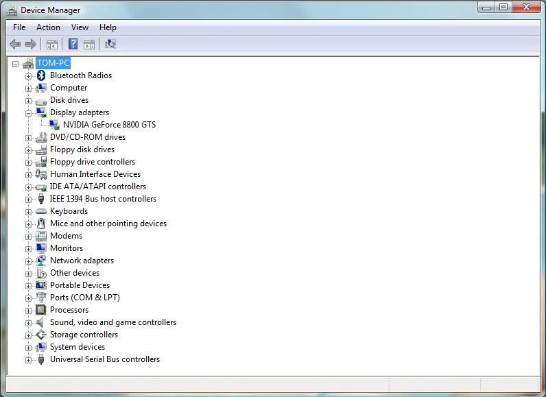

This is what it looks like on the other computer...
How do i find out what graphics card i have? any thing i can put into the run box and find out?
Where it says Display adaptors will be your graphics card - you dont have that so therefore your card is not installed hence the poor scrolling etc
To find out what car you have, try typing dxdiag into run, though I'm not sure that will work if its not installed
