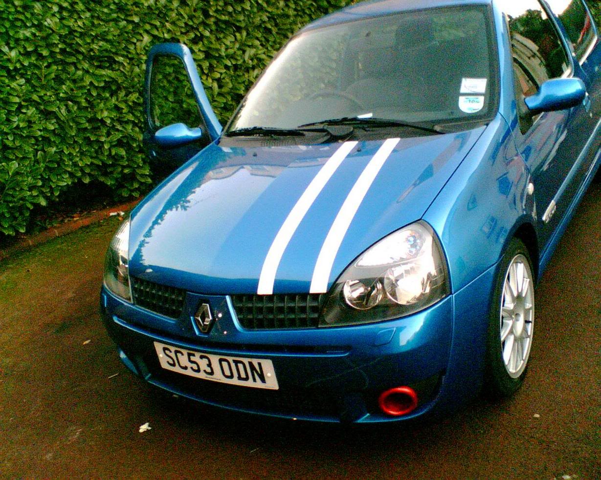

Has anybody fitted or had fitted a viper ik to there mkII 172 and where have you ran the feed and where have you placed the end. did any find the standard feed with this kit too short 2 go to the bumper in the lower grill. Has any1 got any pics of where you fed it and where you have mounted the end, but not the fog light mount.
Cheers any1.

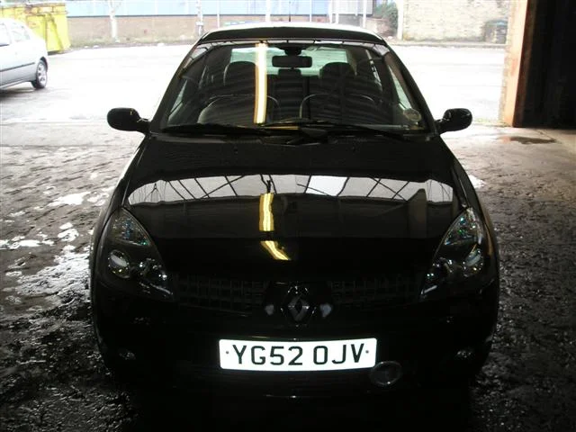

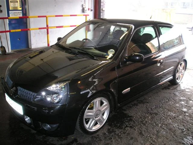

heres mine , bit dark but its there :D
i contacted pipercross about some extra pipe , u need about 1.5m of it , u can joun 2 pieces , prolly end up using just over 1m of it though, u also need to remove the acoustic valve within th wing just a case of un bolting.
fred did mine means takin the front bumper off,

yep down behind the headlight, down to the fog, then across to the lower grille. if you remove the headlight then fit everything in it JUST squeases in, the lever adjuster motor touches the feed pipe
