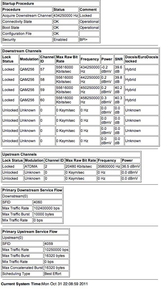

Right this is my current connection status, not sure what any of it means but i know the engineers have to set the values correctly
Connection Status by sbridgey, on Flickr

we have just had two engineers round, what they discovered was that someone had yanked our cable out of the box stripping the thread on the connector so it was barely held in causing dropouts.

So it was some malicious tw@ then? Although I did chop straight through our cable years ago when I was trying to remove the hedge...had Mand come out of the house saying "Telly's gone off"....smiled, lifted hands (with section of cable in each) and said "This will explain what I've done then! Oops!"
Glad its all sorted for you now then :)
