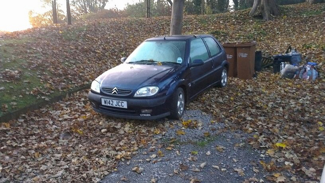

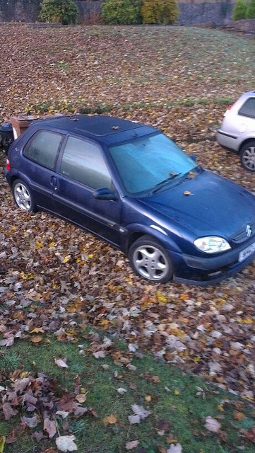

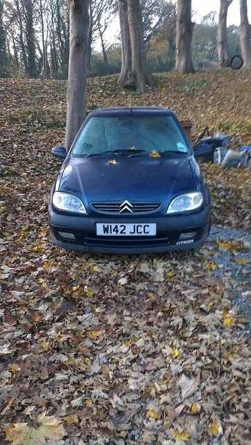

This popped up local to my mate, 10months MOT & 4 months Tax. 97,000miles decent history so we snapped it up for £400.
VTS Purchase day by , on Flickr
VTS purchase day by , on Flickr
It isnt perfect but for what we need it for it was a great buy so my mate drove it upto to my house and we started the stripping the next day. We didnt take to many pictures as we were hard at work.

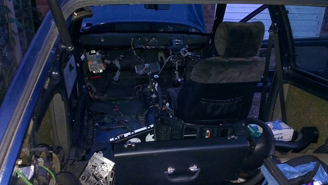

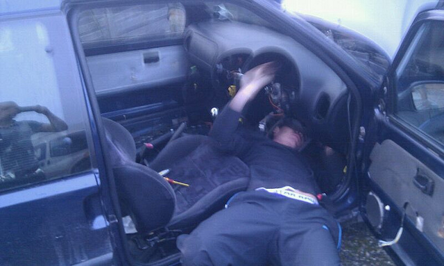

We then put the drivers seat in so we could get it in and out the garage easily.

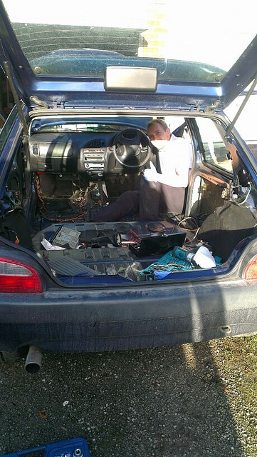

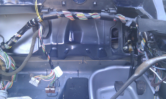

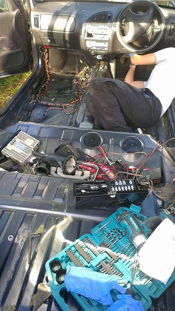

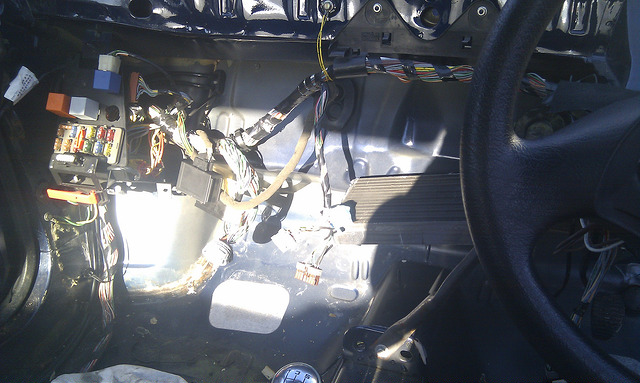

Day 2 and we then moved onto the getting the dash out and having a look at the loom which stuff is needed and what stuff can be stripped out and re routed. The dash proved to be a bit of pain at times due to us both being slightly hungover but in the end it came out.
VTS day 2 by , on Flickr
VTS Day 2 by , on Flickr
Steering wheel on so i could put in the garage ready for it to come out at a later date. So far we have made some pretty good progress next up is to look at the brake servo which is passing water into the car so just a case of sealing it up. Wiring loom is the next big job as the lights, heaters etc are not needed so we can rip them out tidy the loom upabit and re route it so its out the way.

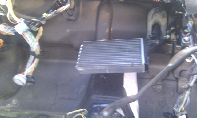

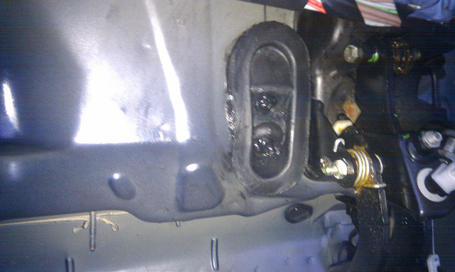

So today I was working on the car on my own and I decided to tackle the heater matrix inside the car as this needs to be removed.
Untitled by JayS_182, on Flickr

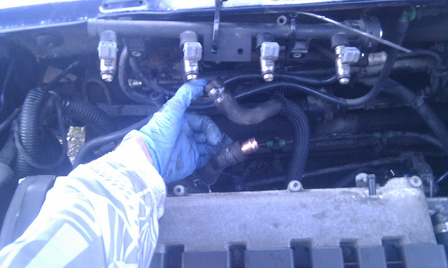

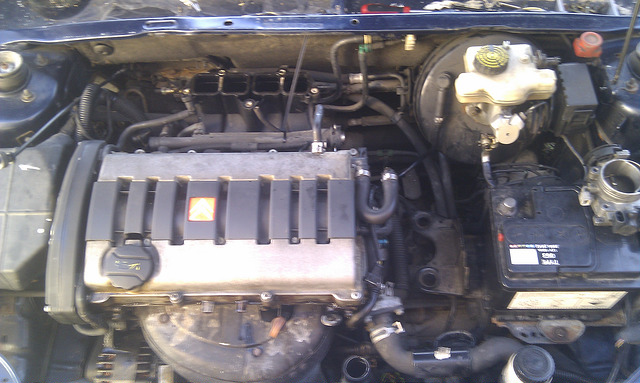

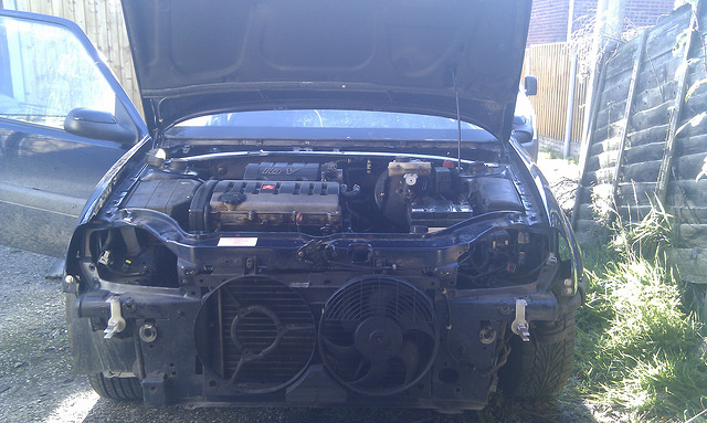

This turned out to be a lot tricky than I first thought. I needed to remove the heater and join the pipes in the engine bay, to get to these pipes though I needed to remove a few things. I started by removing the air intake and associated pipes, this didn't give the room I needed so moved onto the inlet manifold which is very tight and awkward. It was proving difficult so I moved onto the lights, bumper and getting rid of the deading from behind the dash, have a cuppa and a little break.
bumper and lights out by JayS_182, on Flickr
I then went back to the manifold, the tea must of worked and I soon had it off...

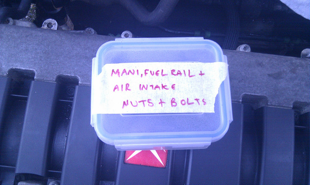

i then removed the injectors and fuel rail and zip tied them out the way and removed the inlet itself.
inlet removed by JayS_182, on Flickr
10 minutes later and the heater was out.
heater matrix out by JayS_182, on Flickr
you can see the hole in the bulkhead where the pipes came through from the cooling/heating system. This left me with the 2 pipes in the bay to join, I bought some copper pipe to use as a joint and then jubilee clip them together but my pipe was the wrong diameter. So I temporarily joined them as the engine won't/can't be turned over until I put the inlet etc back.
once I had joined the pipes I went onto filling the hole left by removing the heater. The big rubber grommet was where the pipes came through so I just used silicone to hung up the holes.

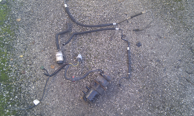

Saturday feeling like death after a night out and the PAS system and pipework was out.
IMAG0515 by JayS_182, on Flickr
We then plugged the holes left in the rack, a quick trip to Halfords and 2 cheap sump plugs later we discovered the holes are both different size threads. We got one in though:-
IMAG0516 by JayS_182, on Flickr
Another trip to Halfords and a sump plug later it was all sorted.

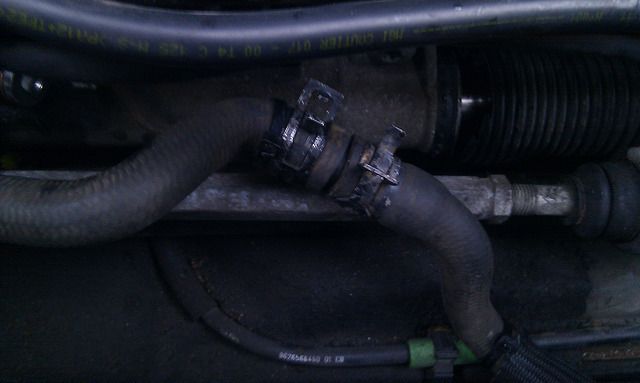

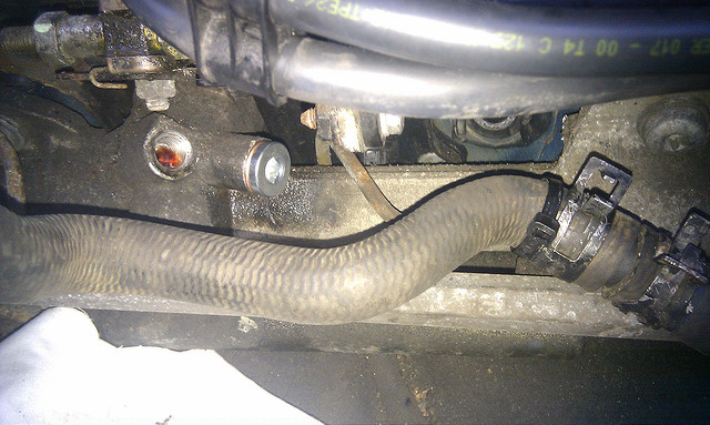

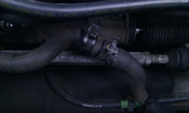

We also sorted the temp fix I did on deleting the heating system and joined the pipes properly, small piece of 20mm cooling hose and it was all fixed
IMAG0520 by JayS_182, on Flickr

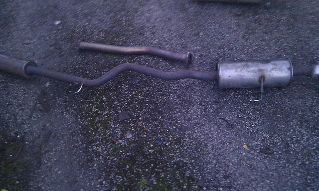

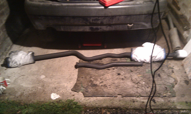

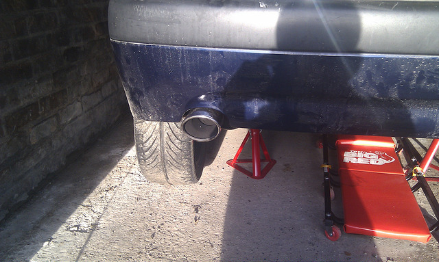

We picked up a cheap Powerflow exhaust with a decat for a whole £20 awesome. We cleaned it up and sprayed it black to prolong its life a little. Tim finally got his hands dirty :p
IMAG0522 by JayS_182, on Flickr
IMAG0526 by JayS_182, on Flickr
IMAG0528 by JayS_182, on Flickr
We covered the stainless sections up and I will give a proper clean with some autosol and wirewool. We removed the old system which looked like it had been replaced within the last 12months or so as it was in good nick. So should easily get our £20 back from it.
Next job is to get a new cat to manifold gasket and fit the decat and rest of the new system.

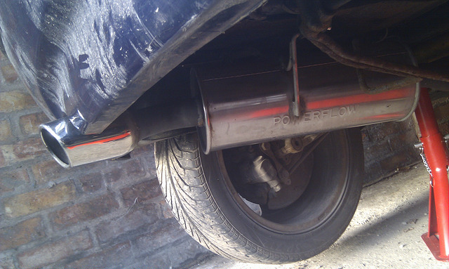

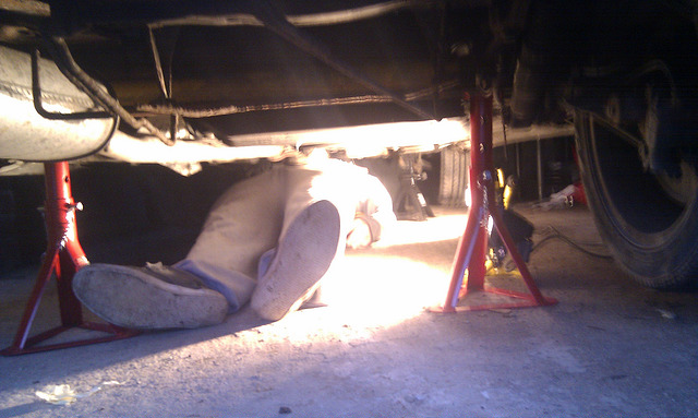

Saturday and me and Tim fitted our exhaust, we were waiting on a new cat to manifold gasket so once this had arrived we could get cracking. It didn't take us long at all to put the decat and rest of the system on. For £20 it was a good buy and a good clean up autosol seen it shine up lovely.
IMAG0561 by JayS_182, on Flickr
IMAG0563 by JayS_182, on Flickr

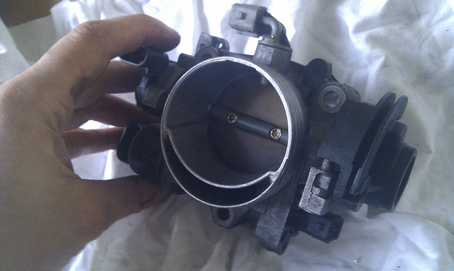

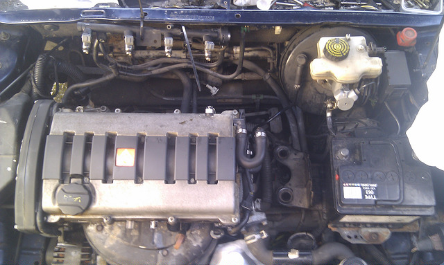

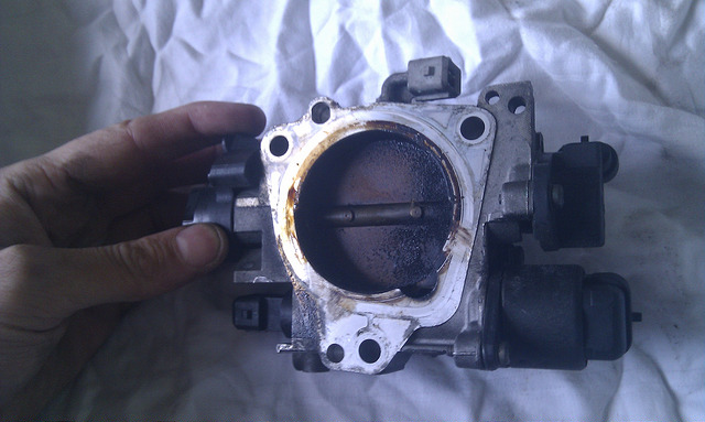

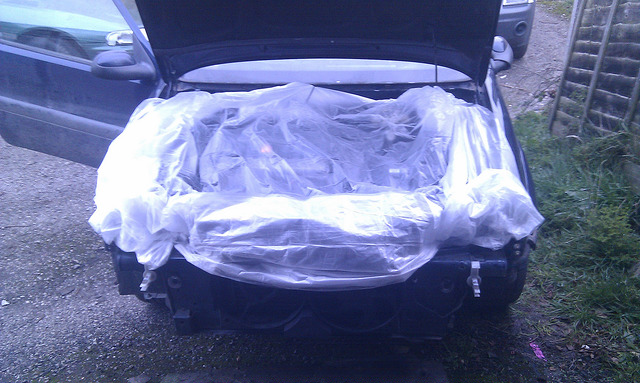

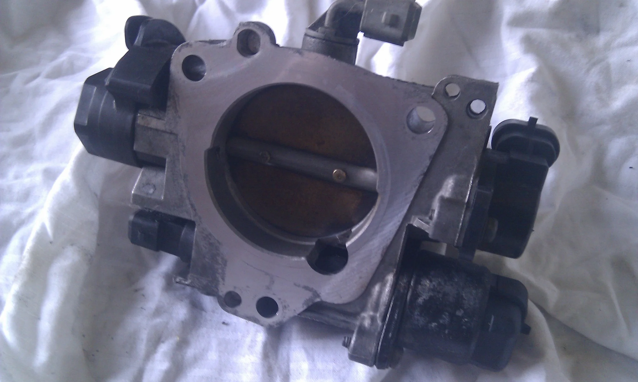

We didn't do much Saturday as we both hungover so we finished after we fitted that. Sunday and I thought I would put the manifold, fuel rail, injectors, throttle body, air intake all back on.

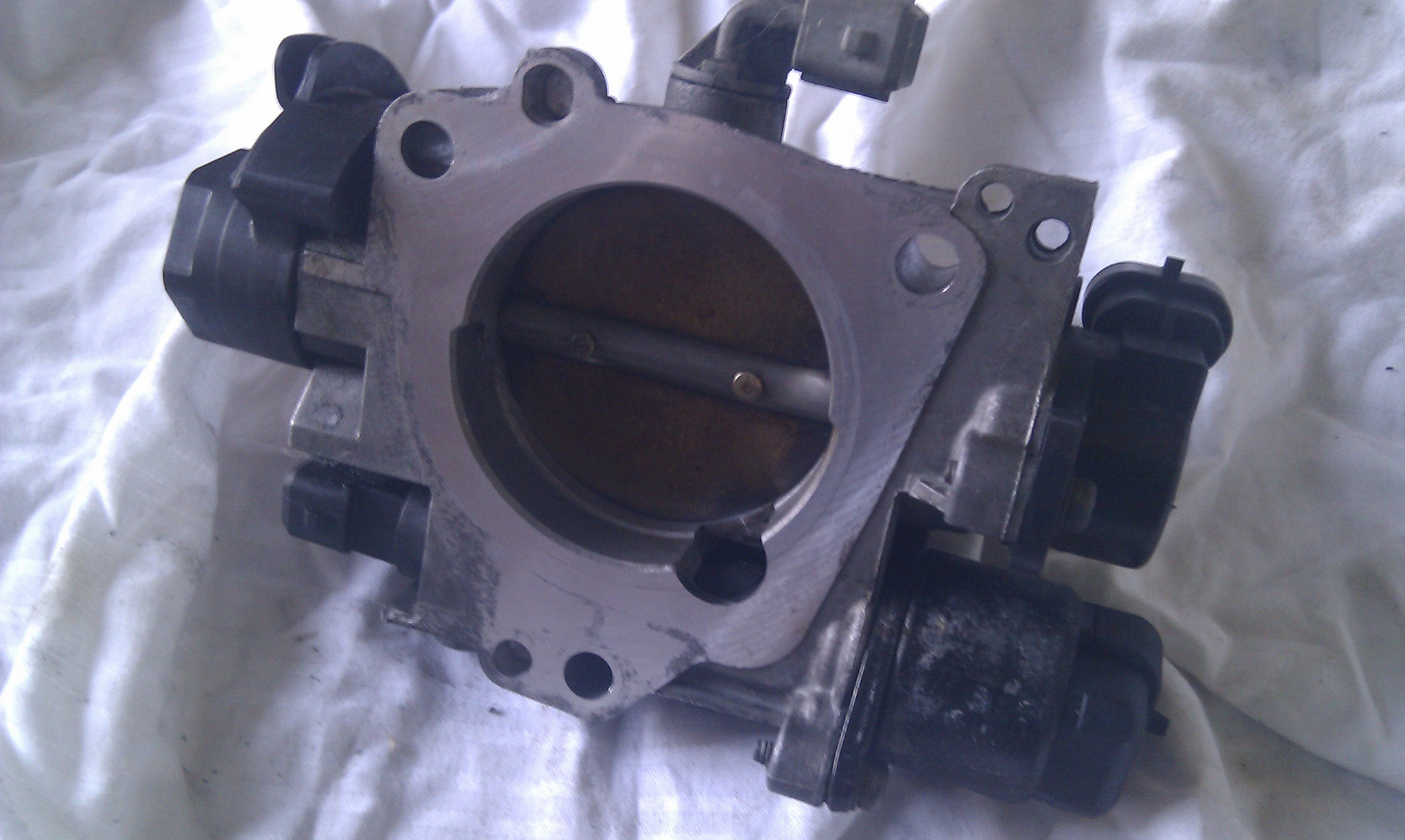

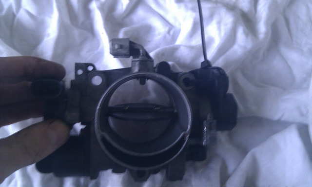

I gave the throttle body a good clean first as it was abit oily.
IMAG0564 by JayS_182, on Flickr
Zip tied open so I get to it all.
IMAG0565 by JayS_182, on Flickr
Some part cleaner, scouring pad and a couple of rags later.
IMAG0567 by JayS_182, on Flickr
IMAG0569 by JayS_182, on Flickr

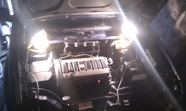

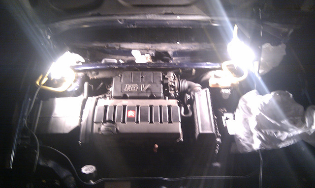

I then set up the lights ready to work in the bay.
IMAG0571 by JayS_182, on Flickr
Some time later it was all back on
IMAG0572 by JayS_182, on Flickr

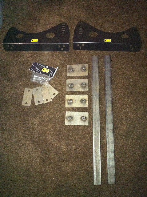

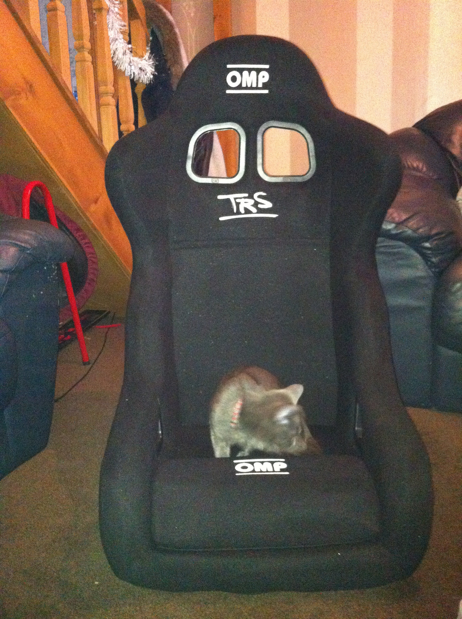

Not much we can do now untill we get parts, today seen us get a OMP bucket seat with mounting frame and side mounts:-
Cat wasnt free I already had her :)
Brand new never been used all for £84.89. Got to love Ebay, all we need is to hire a welder for the day to get it fitted.
Seat is FIA Approved and in date until 2016 so plenty of life left in it. Hopefully next week we will be getting a lot of parts so we will be very busy soon. Although christmas will slow it down slightly

Are you welding the above bars in to mount the seats to? I have the sparco frames in mine and find they put the seat a little to high for my liking.
With regards to the induction setups I am now running the simota one in mine and it seems to do the job.
We thought the PAS had to be removed looking at the regs though it doesn't mention it, see how we get on it may end up going back in at some point. Although non PAS is supposed to better for racing so wait and see.
The car has to be below 900kg but I'm sure we will easily make that got our eye on a nice OMP cage as well which ends this week.
Yeah I was going to weld in the frame then mount the seat to the top, so you think it would be better just on the side mounts? Will have to double check the regs see if says anything mounting te seat. We are looking for a cheap out of date seat as well we can put in for trackdays.

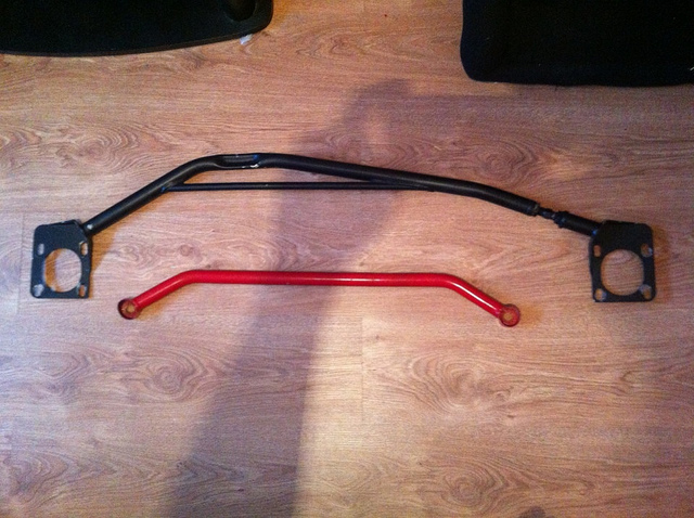

We have some parts so got a lot to do after the new year:-
Upper & low strutbraces both OMP
OMP braces by JayS_182, on Flickr

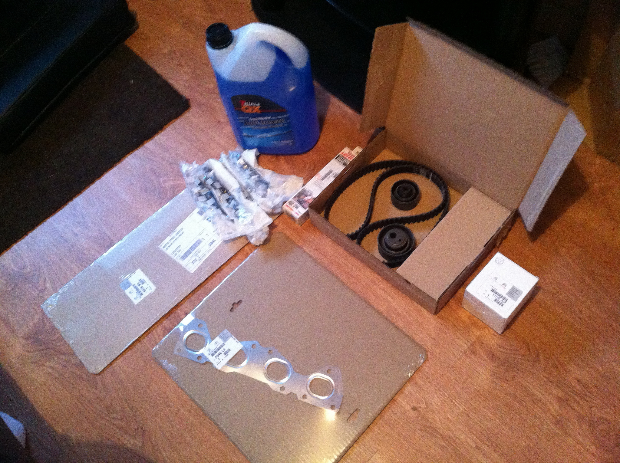

The Citroen dealer over on Saxp did me a good deal on this lot
Service parts by JayS_182, on Flickr

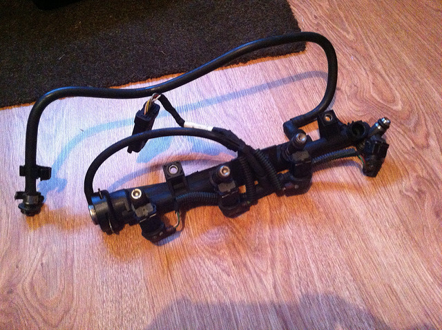

Slightly thicker head gasket as we going to skim our head by 0.2mm. New head bolts, Cambelt kit, exhaust mani gasket, rocker cover sealant, oil filter & new coolant. The other parts like oil, inlet deals and the aux belt are cheaper elsewhere so will be getting them soon.
New injectors to fix my little mistake
Injectors by JayS_182, on Flickr
