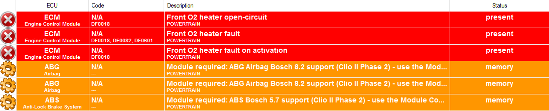

I've had the engine light come on and every now and again it would splutter briefly on acceleration, but overall it's felt fine. I plugged it in and got the below:

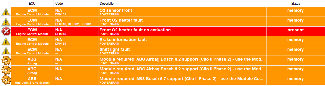

I then cleared the faults and started the engine. The engine light didn't come back on but these faults came up again saying 'present' this time:
The engine light came on again after 15 or so miles and is still on now. Can anyone help me with what these actually are?
Thanks :)

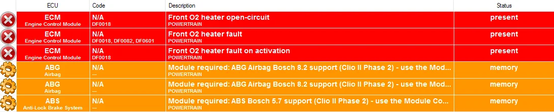

Looks like he's used the RSTuner to read the codes.

No, it was a brand new Bosch one! What could have caused it to fail so quickly?
Could it be the loom rather than the plug that's failed? Swap the lamdas front to back see if the fault moves? That may or may not work
