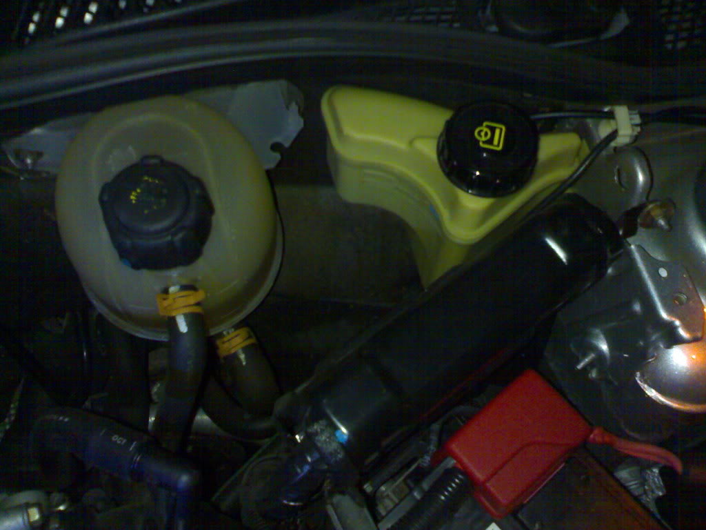

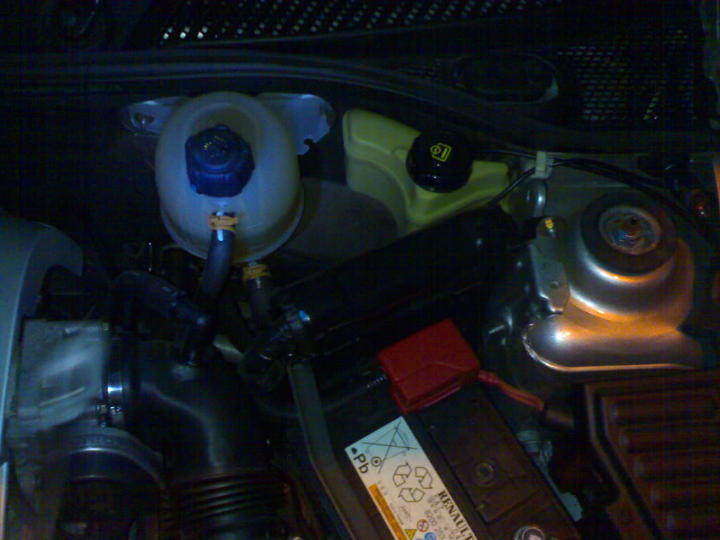

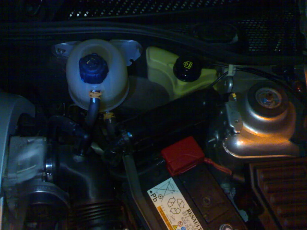

Ive just gone out there to check this and well, i cant find the brake fluid resevoir!
Not had the car long. Had a look in the handbook at where it should be and its not where its pictured and i cant see it anywhere.
It should be there?
Can anyone show me where it should be!!
Ahhhh thanks mate. Why the hell does the manual show it as being over to the right near the power stearing then! GRRR
Guessing the normal manual doesnt cover the sport. and the little extra sport manual ive got only really covers tyres and oil. :S
Anyone got any pics of whats under the cover and where it is as ive yet to have the cover off....Need to get the right screw heads.. lol
Cheers mate. Just popped to halfrauds on me lunch break and bought some T screw heads. luckily i bought the right ones.
Will post back after ive had a look.
Well i found out what the problem was. Took the engine cover and and only just got my hand to the brake fluid resevoir and the bloody cap came off! It wasnt screwed on properly which is why the warning lights kept flickering on and off.
