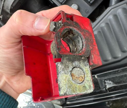

The battery is always my first suspicion when things like this start to misbehave. I had a new battery in 2020 and earlier this year I started noticing a few 'sluggish' things.
Five years a good run for a car battery IMO - and I cleaned up the terminals (and fuse connectors) alongside the new battery. They were fairly cruddy beforehand...
Reckon it'll be the prime suspect in future for me too. Mine was barely six months old so shame to have to replace it this early. Nearly new one was £40 from a friend so not bad at least.
My connectors are looking similar so will be getting a clean before the car goes back on the road.

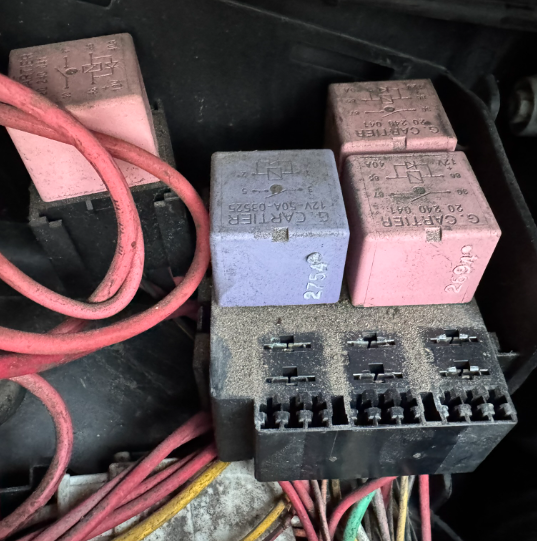

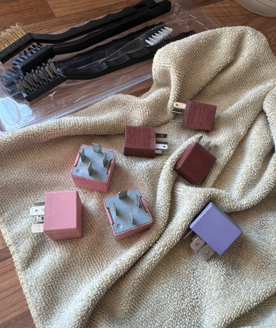

Worth given the fuse tray a once over while you're there too. Although mine was covered - crap still gets in there.
Gave all the pinouts a scrub with a small wire brush too. Some did have a little bit of surface corrosion on them - certainly did no harm anyway.
