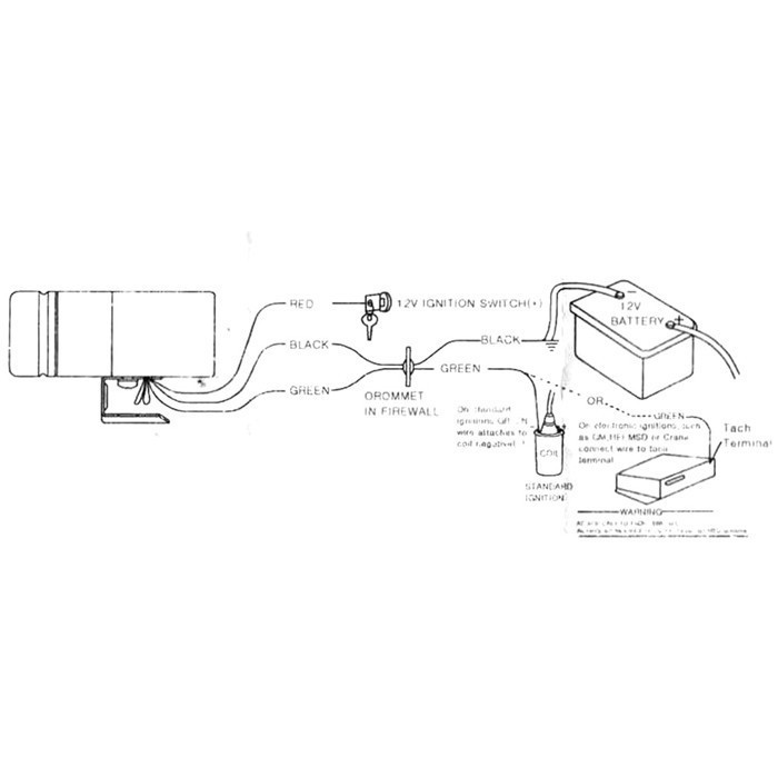

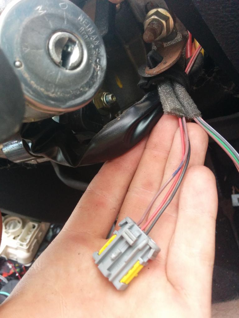

Was wondering if anyone knew which wire is positive?
  Renault Clio 02
Anyone know which wire is posotive for the ignition barrel. want to install a rpm light flashy thing lol
  172 Ph1
Is that connector for the barrel reading ring for the chip in the key ?
If it is I wouldn't use that live wire .
Wouldn't want anything running of of it , just incase you get issues down the line later .
  clio dci , ren8
Don't play with that wire its the code reader supply ,ignition wires are the larger ones in the backround that go to the back of the ignition barrel

If you knew enough you'd already have checked it out with a probe or DMM (or know Red is live and black is earth) but, anyway let's not start that...
Red - +5v
Black - Gnd
Brown - Coded line to UCH

mate i dunno why your being a tw*t lol im only asking for help. i know red is pos and black is earth -_- but apparently these arent the sorrect wires. Its the big ones in the background which looks like it has a couple but i havent checked it out yet..

Am I the only one thinking he's confusing ignition barrel and the ignition coil signal required for the "rpm light flashy thing"?

So it just wants any switch live. I'd go for the one to the radio tbh. Wouldn't want to touch anything around the ignition barrel etc if you don't know what you're doing.

thats sweet then. id much rather use the lighter postive, so much easier as well. now the last wire has to go to the negative of the coil or the tach terminal. now to figure that out.
