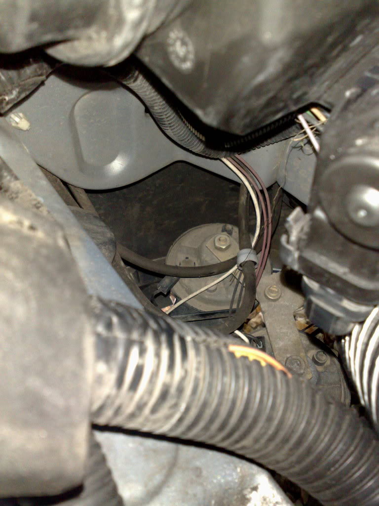

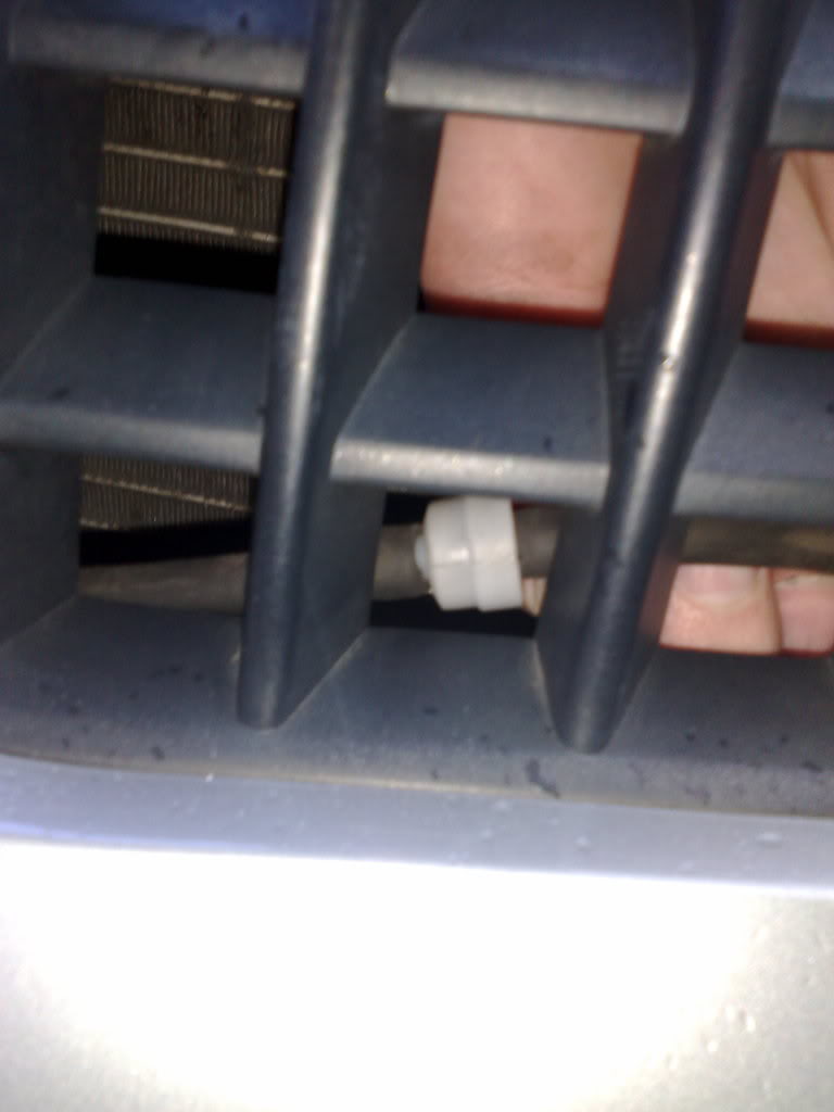

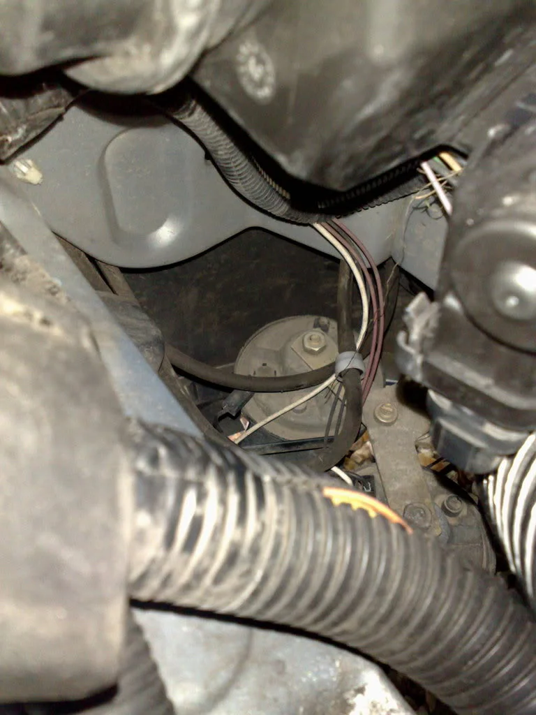

Cheers for the pics.
You've got two in the same line? Where did you get the valves from?
I've got one down by the horn.
  Clio Sport 172
no ones for the right and one left.. they are from halords. are you sure you put yours the right way round?
in halfords they are above the wiper blades

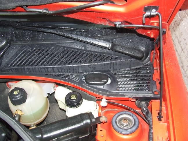

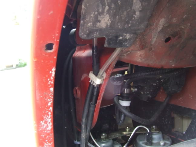

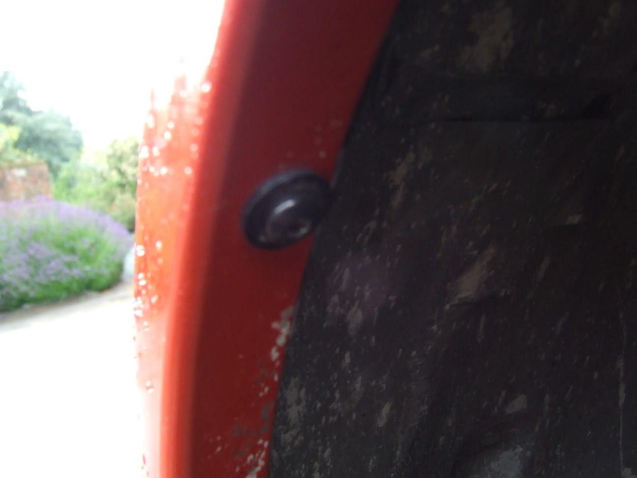

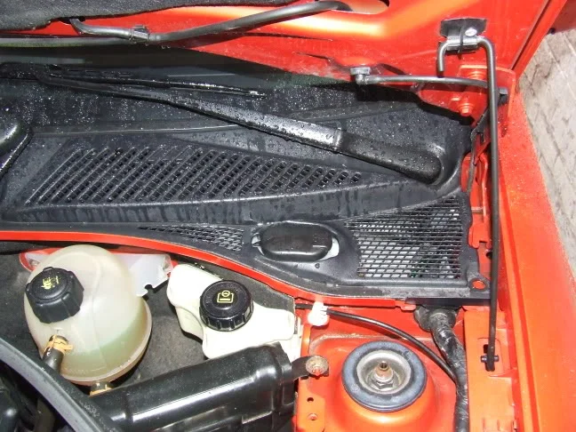

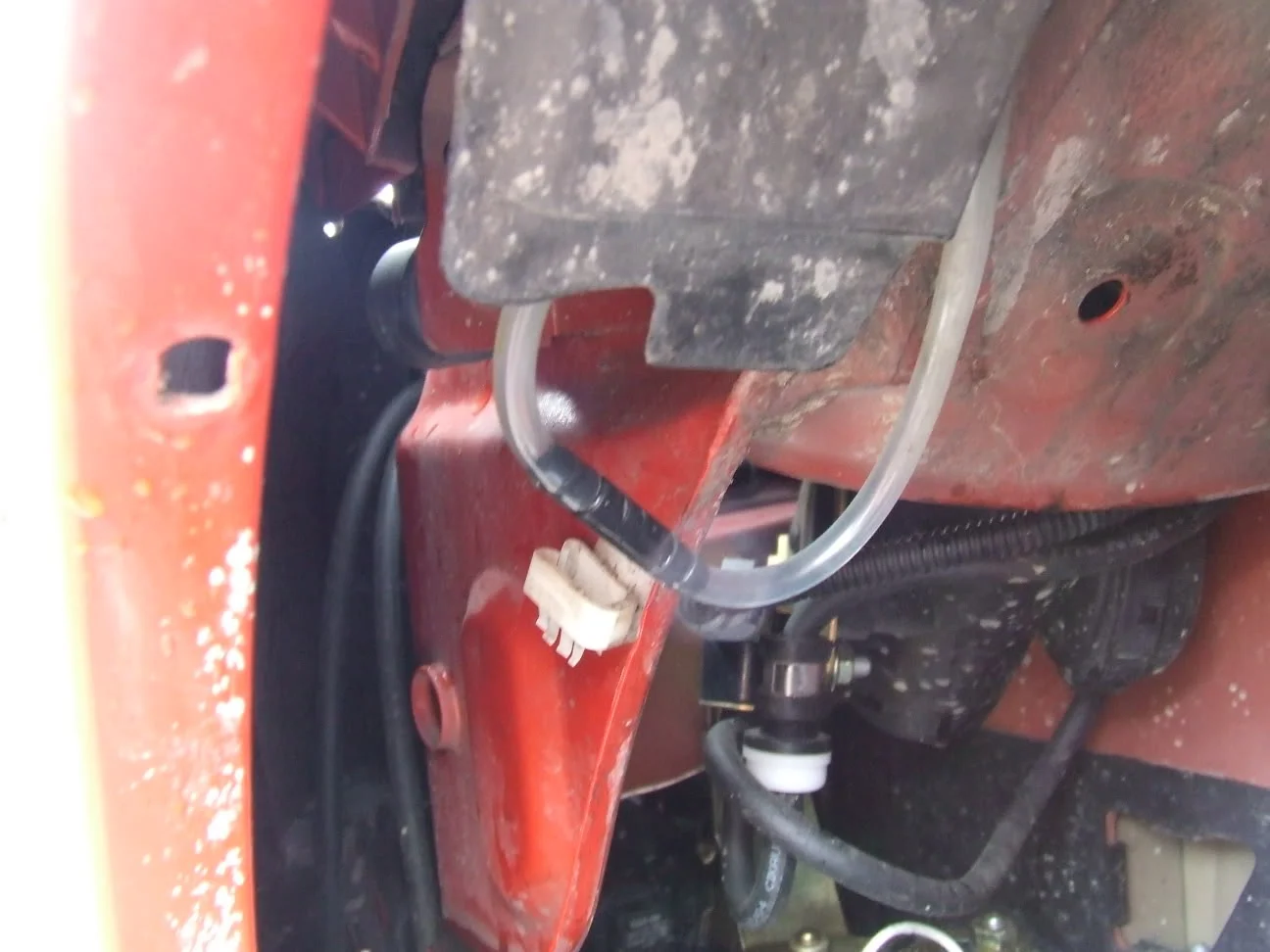

This is how i fixed mine!
First job is to lift the bonnet and get up behind the scuttle panel
If you just lift it up you can see the wires that run to the washers pumps

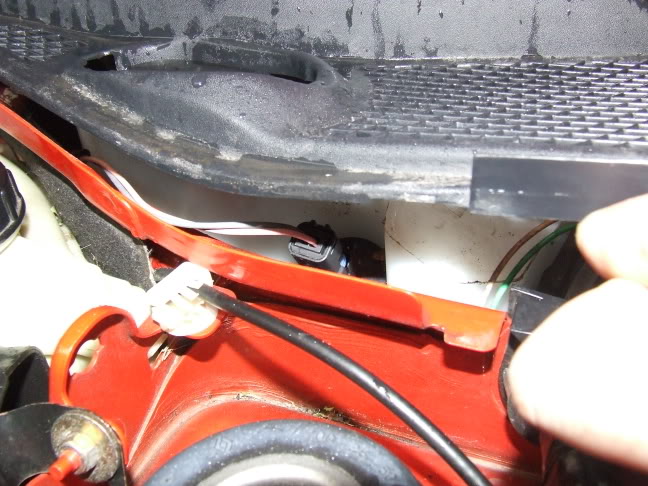

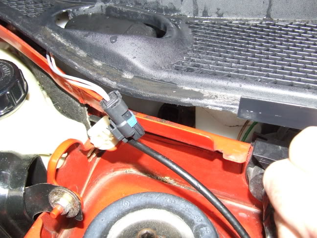

Simply pull this out like so
Then put the scuttle panel back along with all the clips

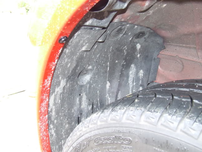

Next step it to jack up the fron left of the car to allow access to the inner wheel arch, could even remove the wheel but no need in my opinion.
Undue this hex bolt

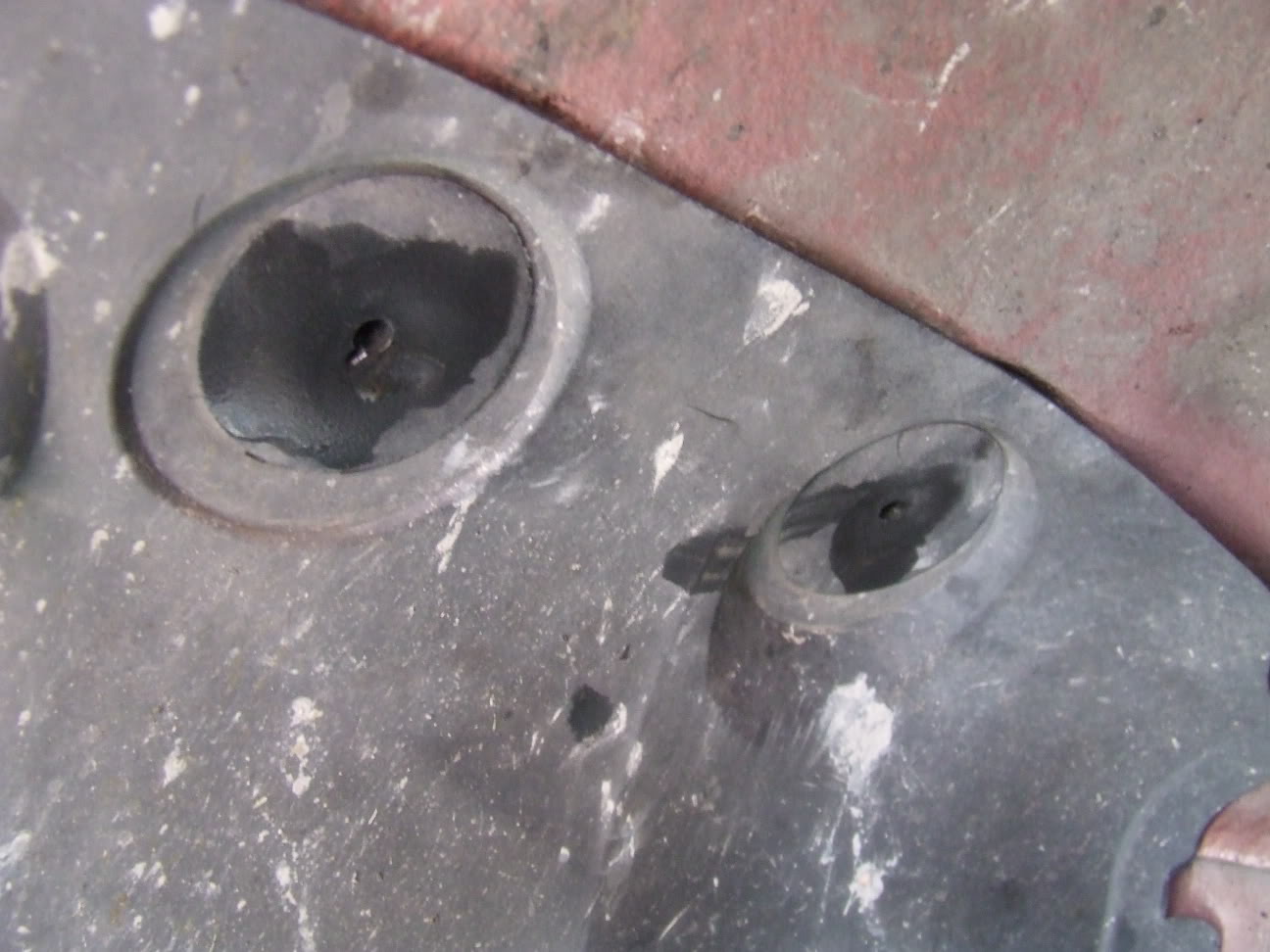

and pull out the two plugs that hold in the wheel arch, have to tug these quite hard, using a screwdriving to lever them out also helps.
with those removed the wheel arch will move to the right giving access to the pipe that run to the washers.

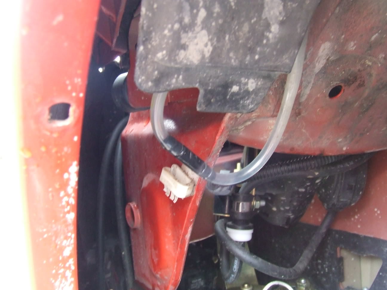

simply pull the black hoses from the clear ones, then connect the 2 clear hoses together
then reassemble, job done!
P.S the light washer won't work after doing this but my lights don't need cleaning!
Big thanks to lemonnobby1 for the info to :)
Undue this hex bolt
