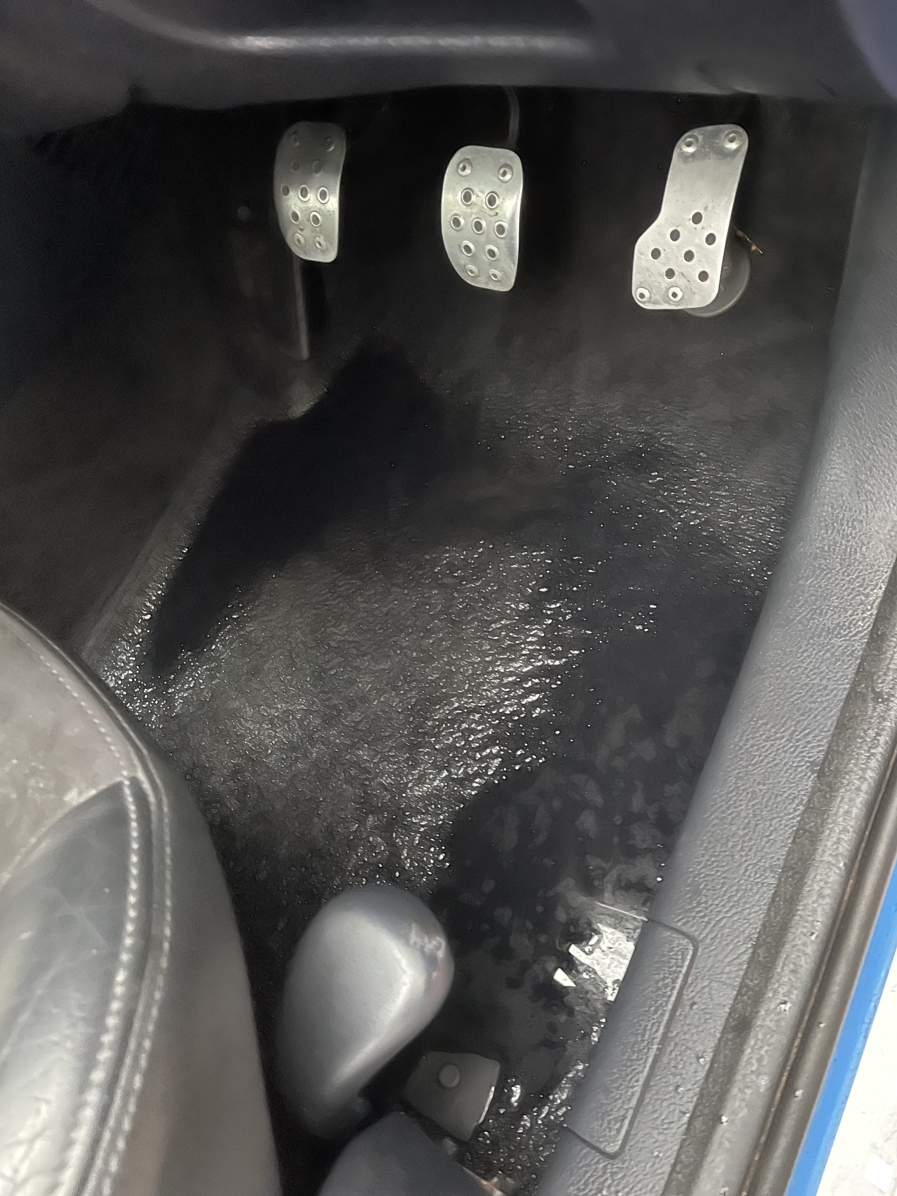

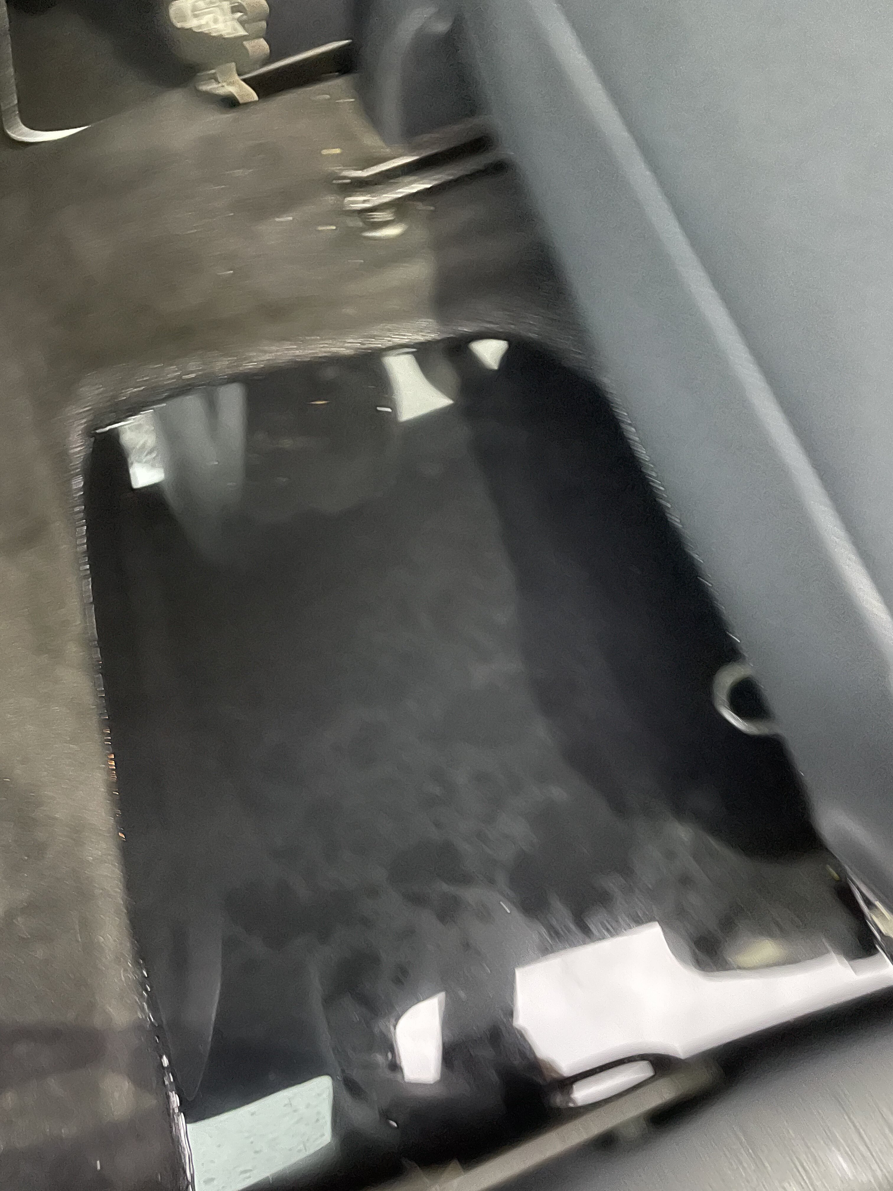

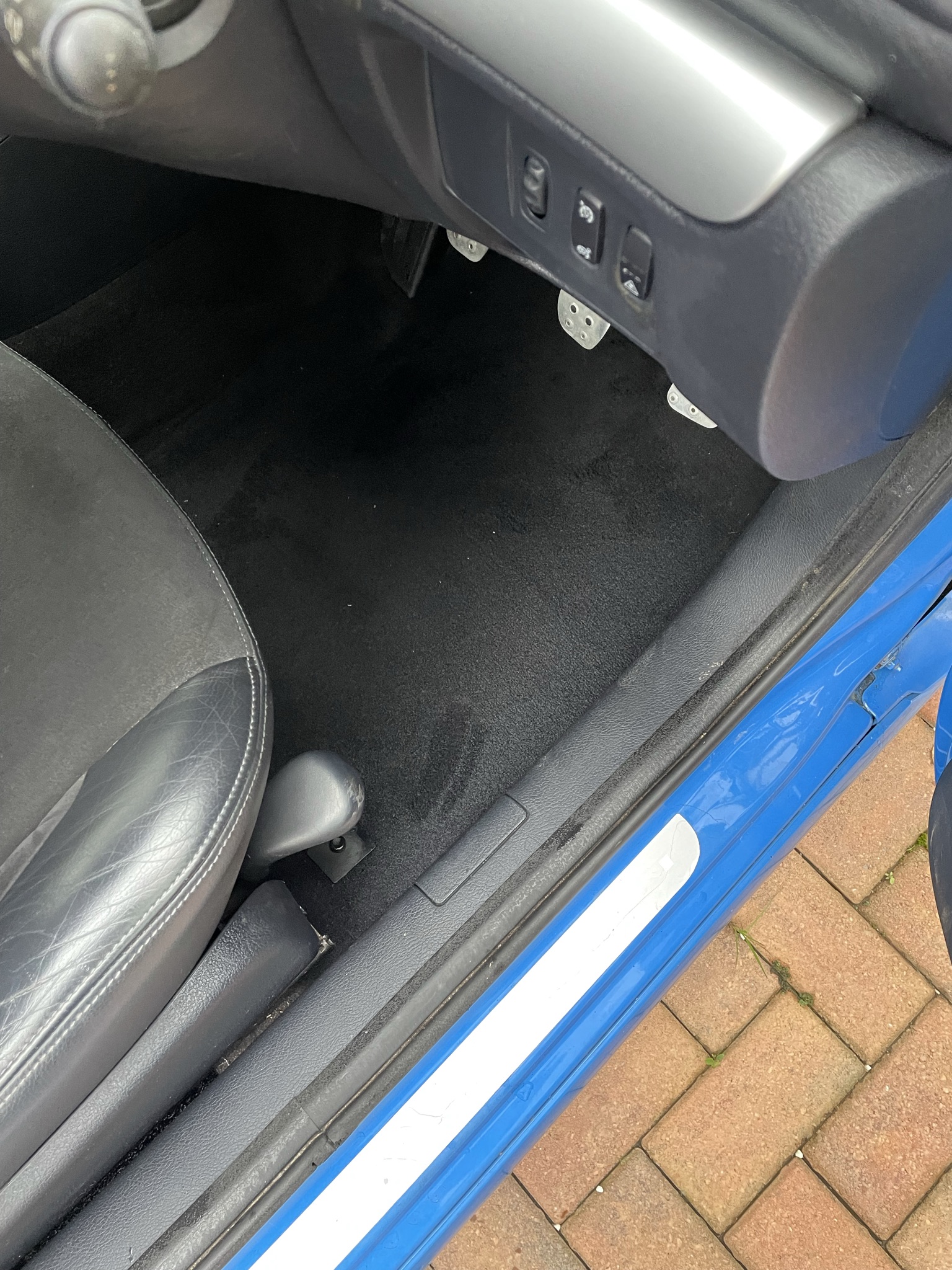

Hi,
After hearing a sloshing noise on the drivers side of the car I looked on here for existing threads and as a result went out and checked my carpets and my carpets on drivers side where drenched. This is a weekend car and isn’t driven too much hence I didn’t notice.
I assumed it would be the skuttle drains and got someone more handy than me to take a look! When I opened the car it was like a swimming pool and this was after I wet vacced out a tonne of water.
Long story short the skuttle drains are clear and with the help of a hose it looks like water is coming in via the heater box seal. I have seen this on another thread. There’s a steady trickle of water but it’s not pouring in.

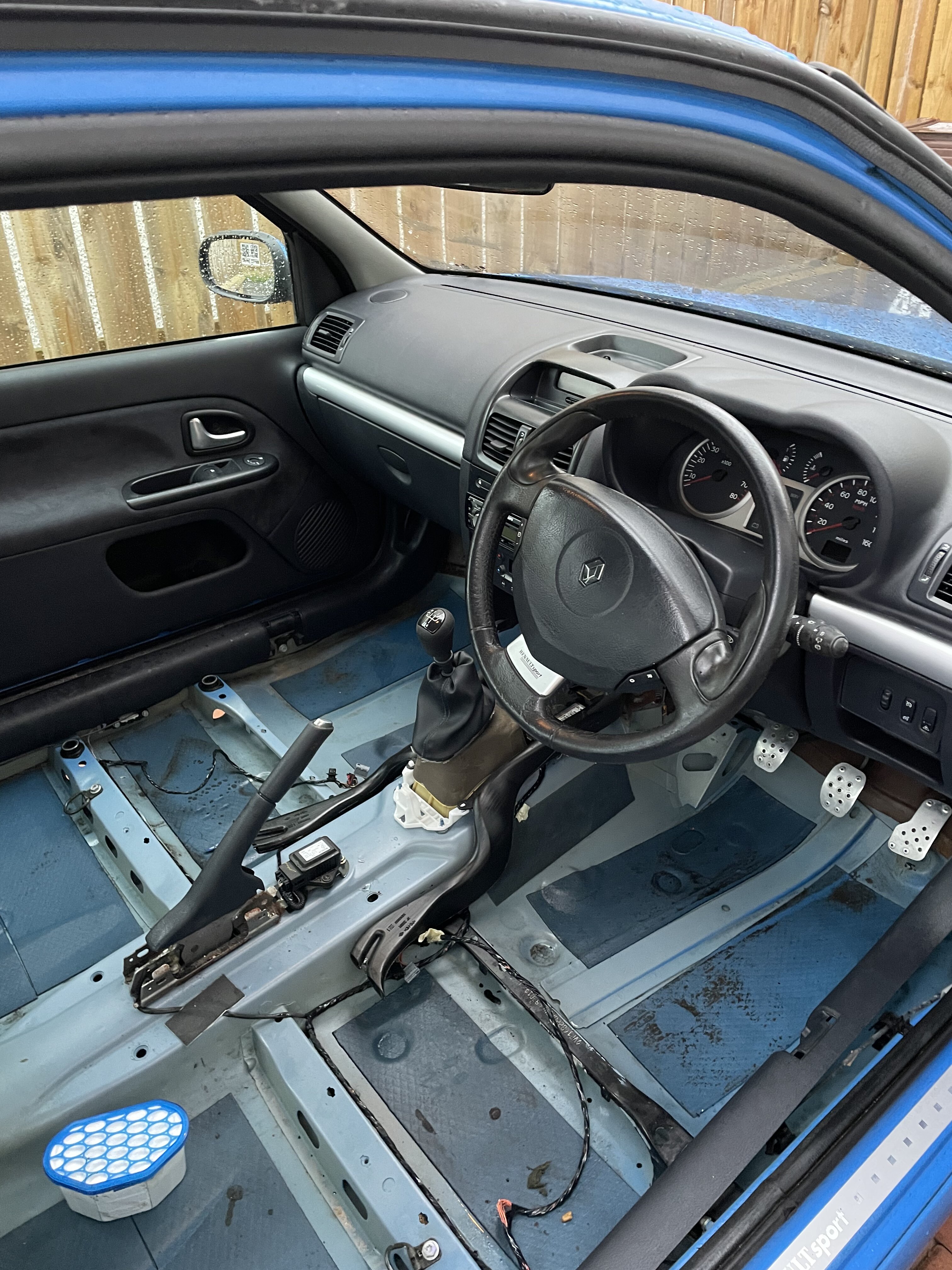

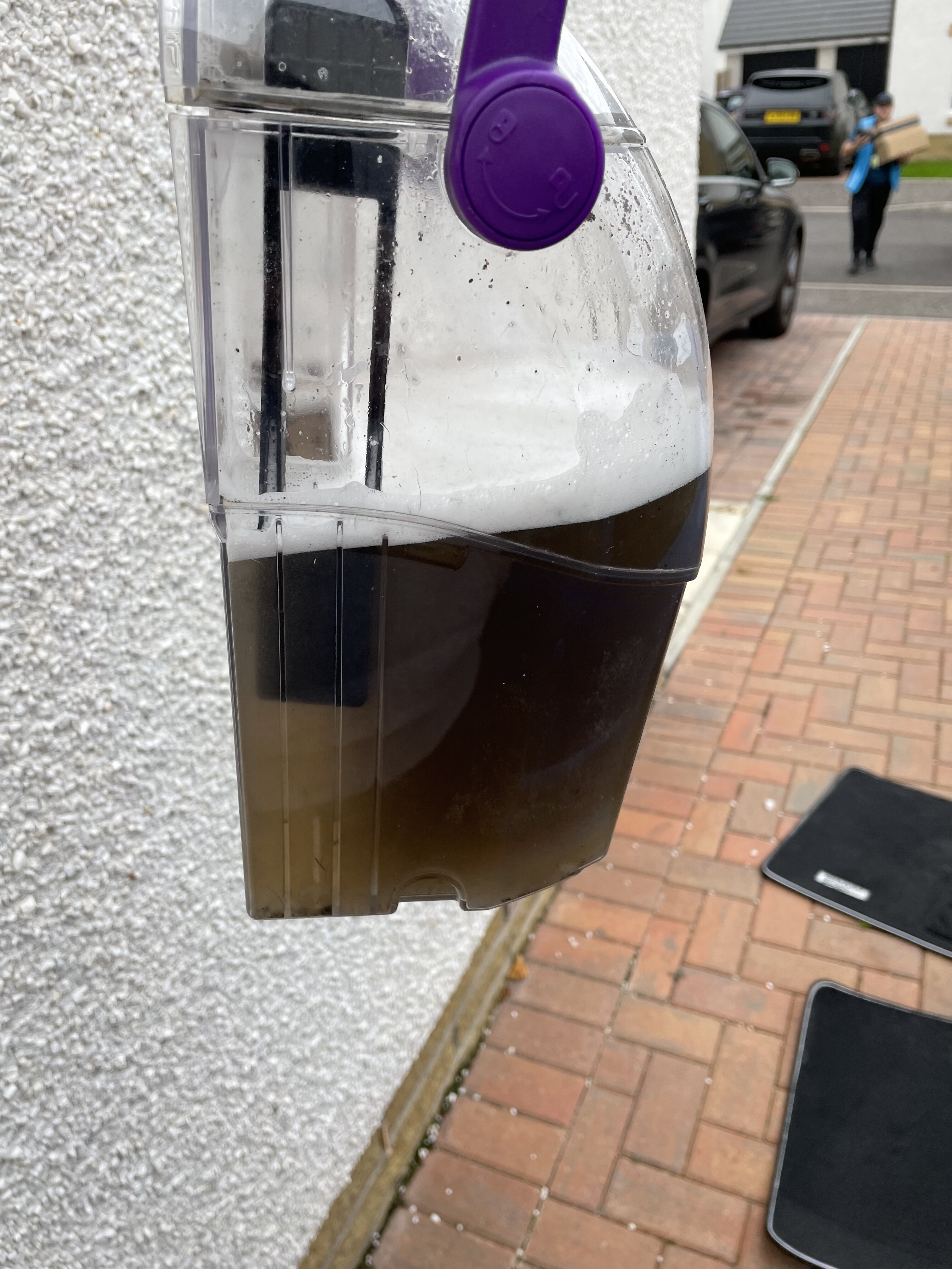

Interior is now striped out to dry off and I have died the car and have it under cover now. We will re seal on next dry day.
So your probably wondering why I’m here but what I am curious of, is do you really think this amount of water can be coming in via the heater box? I’m a bit skeptical if I have found all the issues or not.

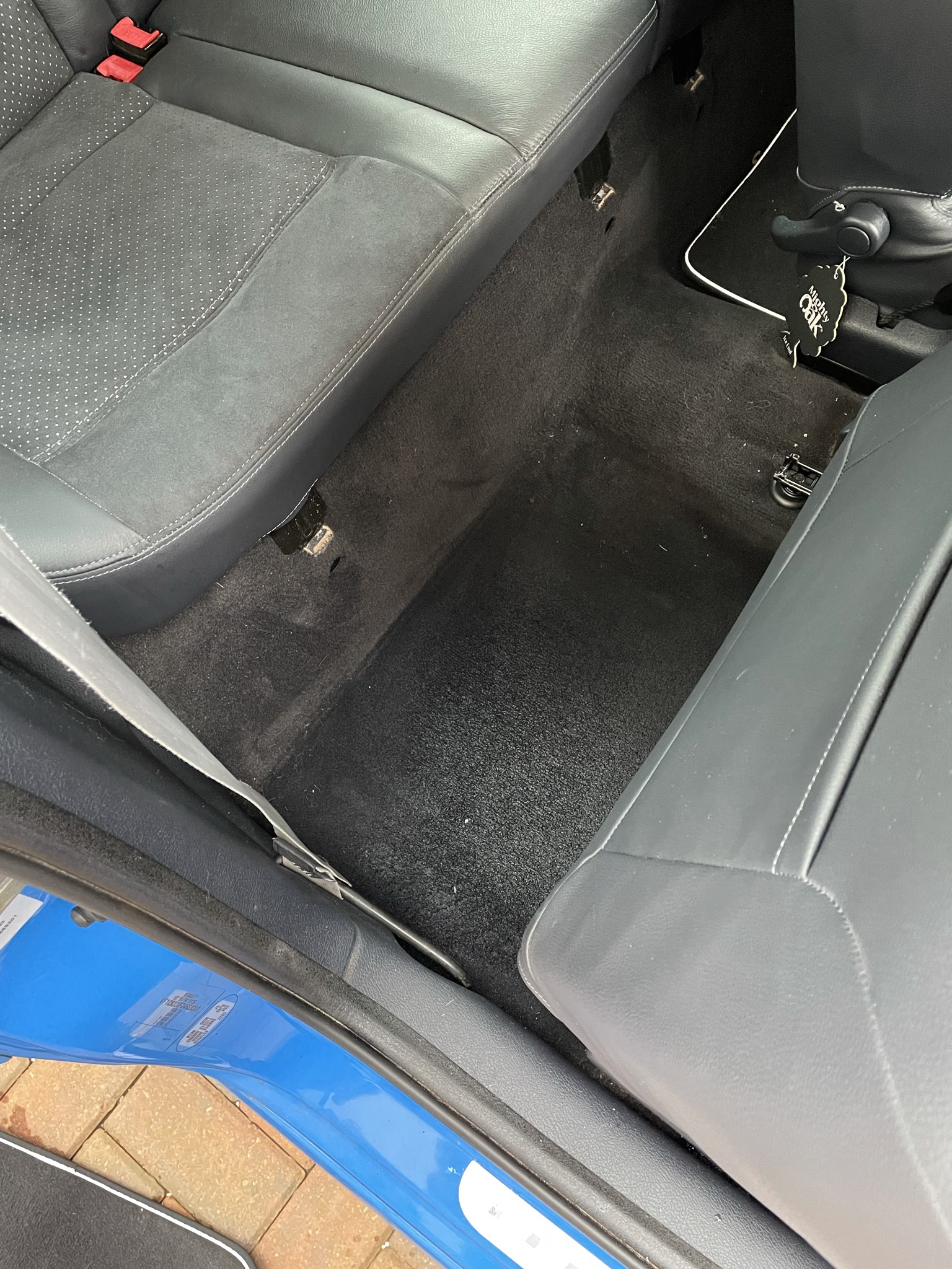

What do you guys thinks, passenger side bone dry.
Photos from today and also the day when I found it a few weeks back. You can see it’s much worse, which corresponds with the weather

Surely it’s got to be coming in from somewhere else as that is a serious amount of water.
I’d be checking all the usual areas if I were you. The seat bungs, rear light bungs, door seals, heater matrix, scuttle drains and making sure the drain holes in the sills are clear.
Can you see any tide marks that point to where it could be coming in?
i hope you sort it soon though mate as chasing leaks are a nightmare. I was chasing one for 6 months and it did my head in. It wasn’t as bad as yours though!

My heater box was doing exactly this, it's only a foam seal on the original one that perishes. I used gutter sealant having cleaned the old foam off first.

Thanks Dom, appreciate that. Do you think that could amount for the sheer volume of water I have experienced? How wet was your car?

Mine had been parked facing uphill slightly so I also had water in the rear wells. Over time yes I don't see why it couldn't fill up, as its known to leak there I'd get it sealed in anycase.

Hi Mate,
Exactly my thoughts as it’s went from bone dry in summer to ankle deep over past 4 weeks. I will check those again when I open the car back up. Main priority was to get the carpets out and to dry the floor and cover the car over for damage limitation.
Can’t see any tide marks as it was honestly full of water it was unreal 😂
I am hoping as it’s probably a major leak that maybe in a way it will be easier to find the source as opposed to trying to find a drip. At least for next summer it should be sorted and I can enjoy the car.
I have dusted talcum power all over the bare car and will uncover it after the heater box is resealed and I’ll try the hose to see if I can then trace it.
open to any other tips as this was not what I had in mind when I bought this car for a hobby 🤣

Yeah, I’d echo what Dom and Arthur have said above and just go through the car with a fine tooth comb and seal up any of the usual areas. It’s just a process of elimination really!
I used a bit of butyl tape for the heater matrix and it seems to have sorted it. My heater matrix was also dropping a decent amount of coolant into the drivers footwell, so once dry, have a look for that as it would soak my carpet in about a week.

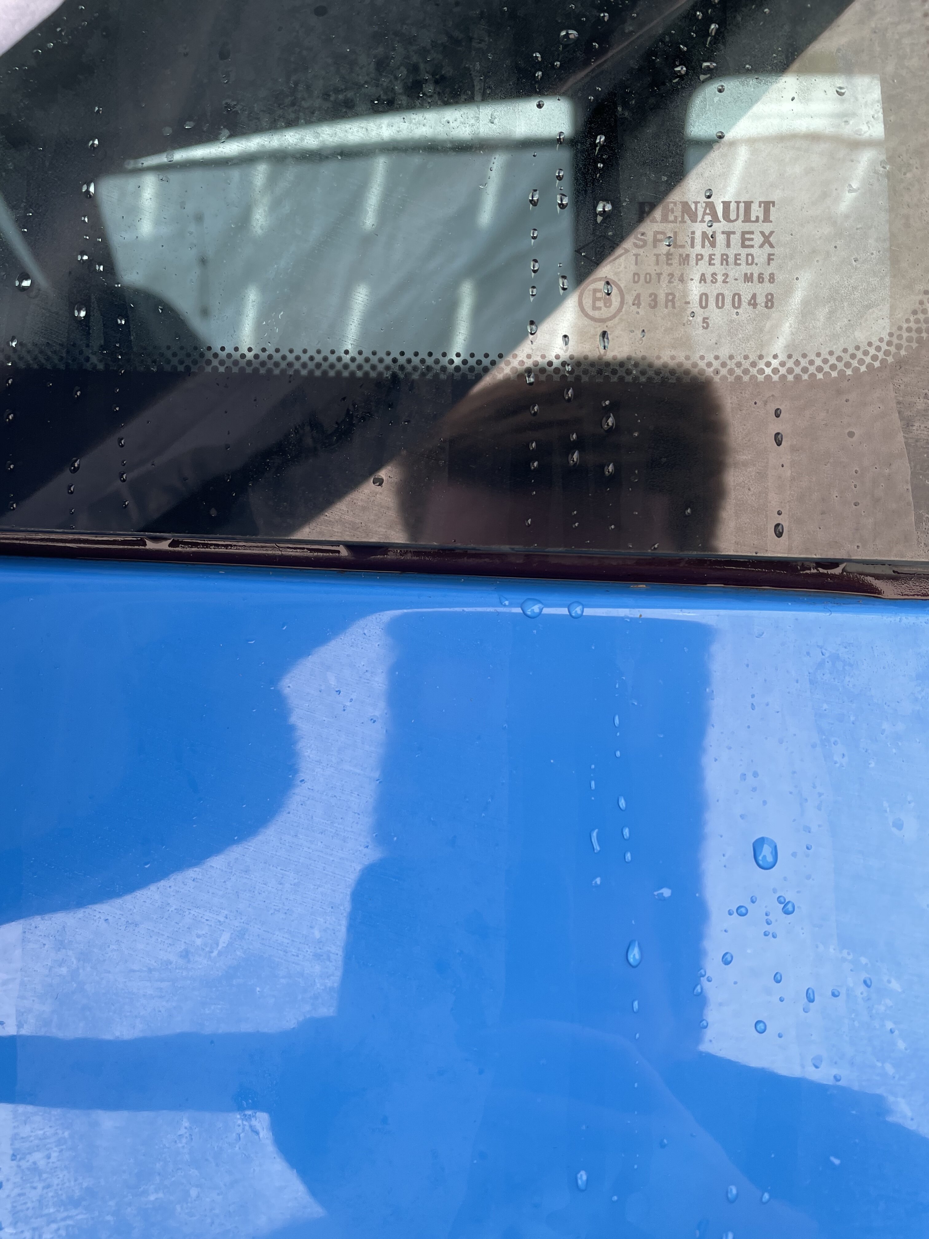

Thanks everyone for all the replies it has definitely made it less frustrating!
The weather is glasgow is shocking just now so not had another dry day but in a brief dry spell I had a look inside the cover and seen this at the bottom of the rear window. It looks like the rear drivers side window seal has an issue and I’m pretty sure this could be letting in a lot of water.
I will try it out with a hose on next dry day when I can get cover off.

That wont be your issue.

All Clio rear window seals look like that. As someone else said, that is unlikely to be your issue as the windows are bonded in.

Gents, managed to get the problem solved (I hope!) and the interior and retrimmed steering wheel should be going back in over the next week.
After resealing the heater box, water isn’t making its way in anymore.
So in the end all that water in the photos above was coming in via the heater box!
