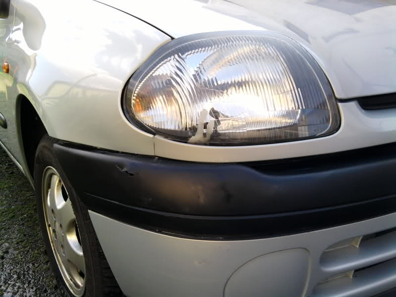

My car's bent at the front, got a hole in the bumper and the light was knocked out of the bracket, me and the bird's dad managed to kind of sort it. Definitely not getting it properly fixed.

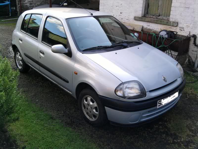

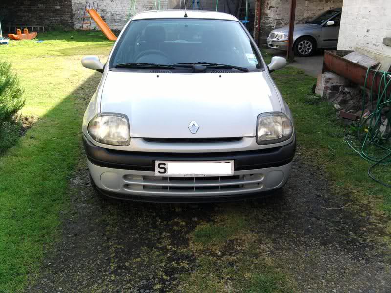

Some pics:

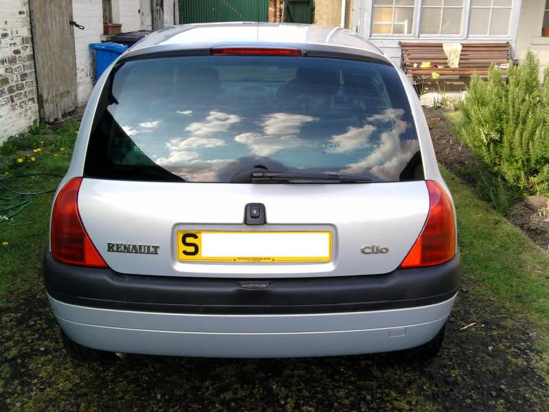

And a nice bum shot:

Car's not too bad really is it!! Have seen worse.

unlucky buddy, have you checked that the wing / bumper hasnt been pushed out as a result of the archliner moving out of position and forcing them to stick out.
on the plus side it now looks like it has a 172 wing in this pic (do it to the other side and it will be a sports rep lol)

Looks as though you've bent the brackets that hold the bumper etc in place, if you take it all off, i mean everything, bumper, wing, front little grille bit, light and then take a look at the brackets maybe some can be bent back into place. Refit it all it should look a lot better!
If you really wanna hide it, when you've got the bumper off glue something underneath the hole and then fill and sand down ontop, either paint silver to colour code, or matt black to look like it does now.
