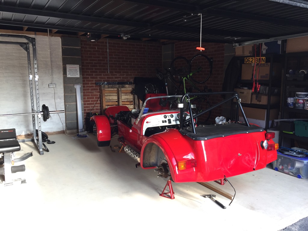

In bits already.
Can't decide on wheels. Currently has 185/60/14's on. I wanted 185/60/13's but I think they'll lower it too much.

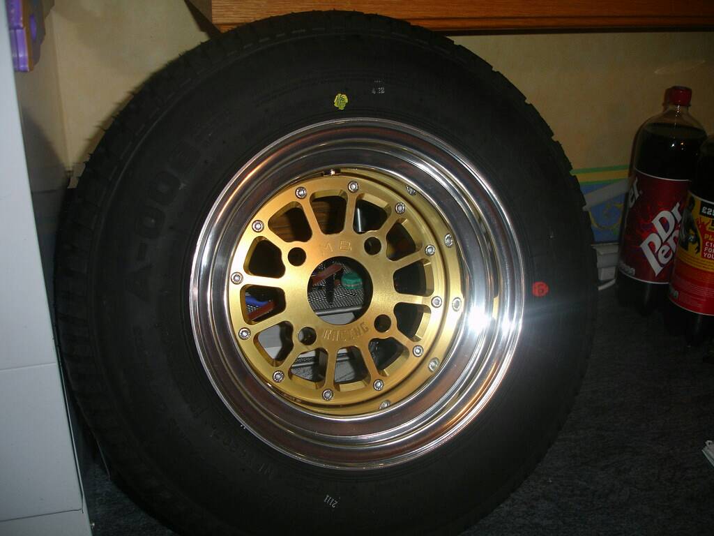

MB Racing make 3 piece split rims, so you can get the offset and the width right.
The ones I had on my mini.
Barnby wheels also have a habit of shattering in the middle ,
Image would be a far better bet , too many barnby caterham wheel failures hence people nowadays won't with a bargepole .
