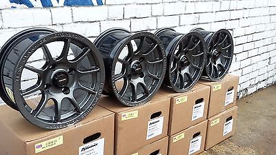

13 x 7 Pro Race 1.2's ordered in Anthracite.

The pro races are a nice look
Would have stuck 6" on the front though
Sent from my LG-H815 using Tapatalk
Let's hope you got through the offset minefield ok

Pro Race only do 7" widths.
I've not actually moved the tyre position in wards or out wards which should mean I'm ok.
I was:
185/60/14 et 20
New:
185/60/13 et 23
Tyre will give 12mm lower ride height and 12mm more clearance for height in the arches.
The wheel its self will move 15.7mm inwards and 9.7mm outwards going from 6" to 7" with the offset change.
I should have more than enough clearance at the front and back. I'll probably have to raise it up 8mm at the front though so the sump is in a happier place.

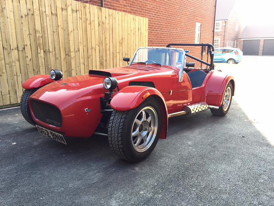

Test day.
Positives:
Still fast
New gear linkage works
All the lights now work
Seat position better
Deffo has an uprated box in it, long first and second
LSD locks well
Negatives
Exhaust rattles
New gearlinkage rattles
Current wheels and tyres are awful
Only the left front Calliper works
Pedals poorly positioned for heel toe
Current seats are terrible
I can't wait for my new wheels and tyres to turn up. Seats will help it too.
Currently trying to find a set of better brakes too.
