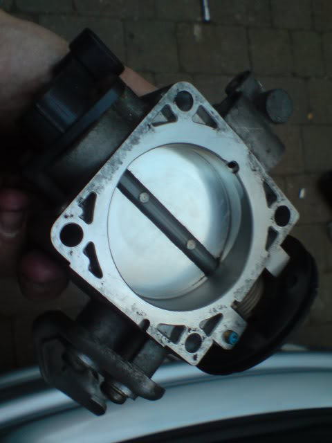

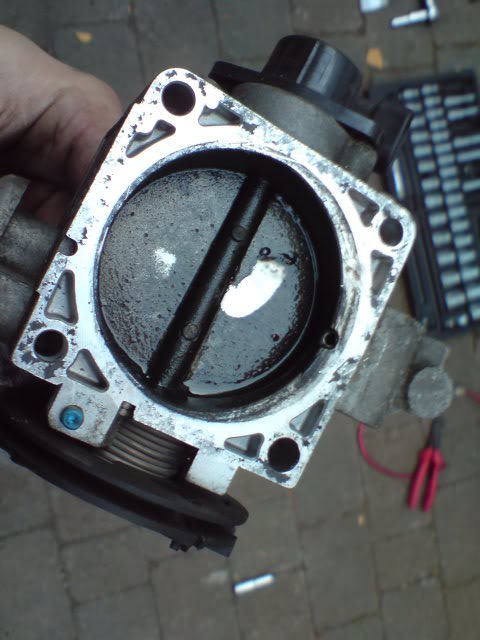

My old PH1 track cars throttle body after 90,000 miles
Before :
After :
Idle was all over the place, Cruise control didnt help either ( old dried throttle cable :rasp: )
Once it was all cleaned up & the new cable installed the idle was spot on!
When you remvoe the body you will need a new gasket as its not like the PH2's that have a re-usable rubber one
