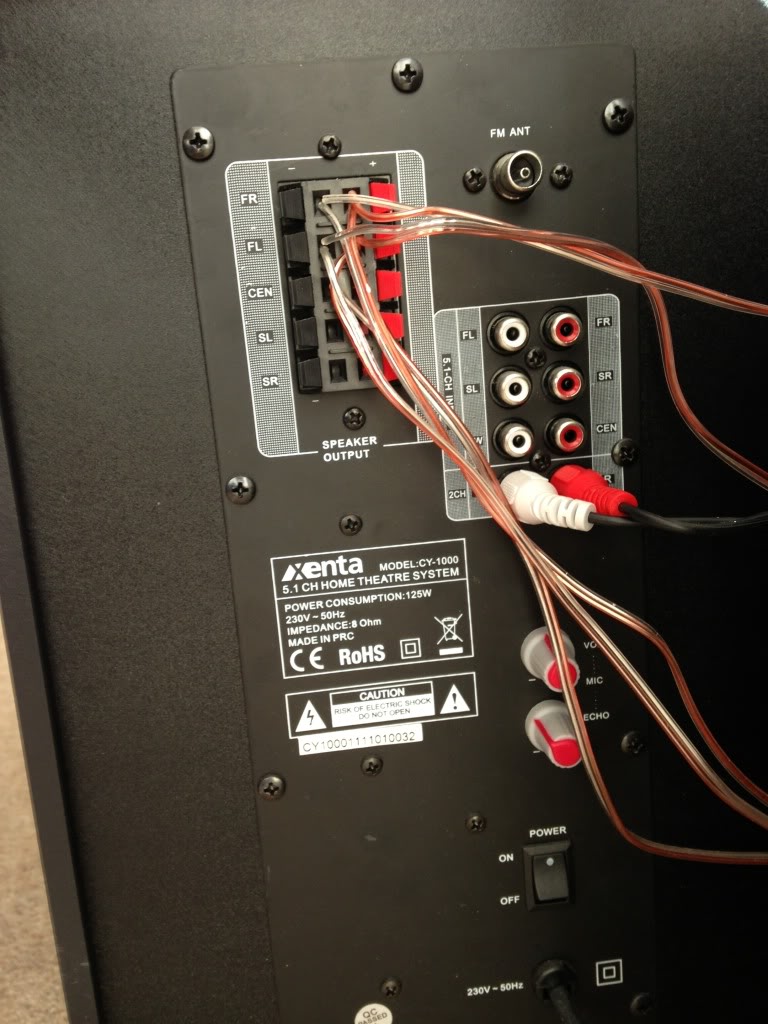

According to the listing, it only have a 6-channel input (analogue, no digital input). If that's really true, then you will need to have a 6 channel output on your source equipment. I hope you didn't pay £999 for it as that really is a s**t system not worth more than £200 imo.

thank f**k for that! lol. Are you able to post a picture of the inputs on the back? Will give us a better idea of its setup...

yep that's analogue 6 channel input only. you would need a source device that has an analogue 6 channel output to use that in 5.1 mode.

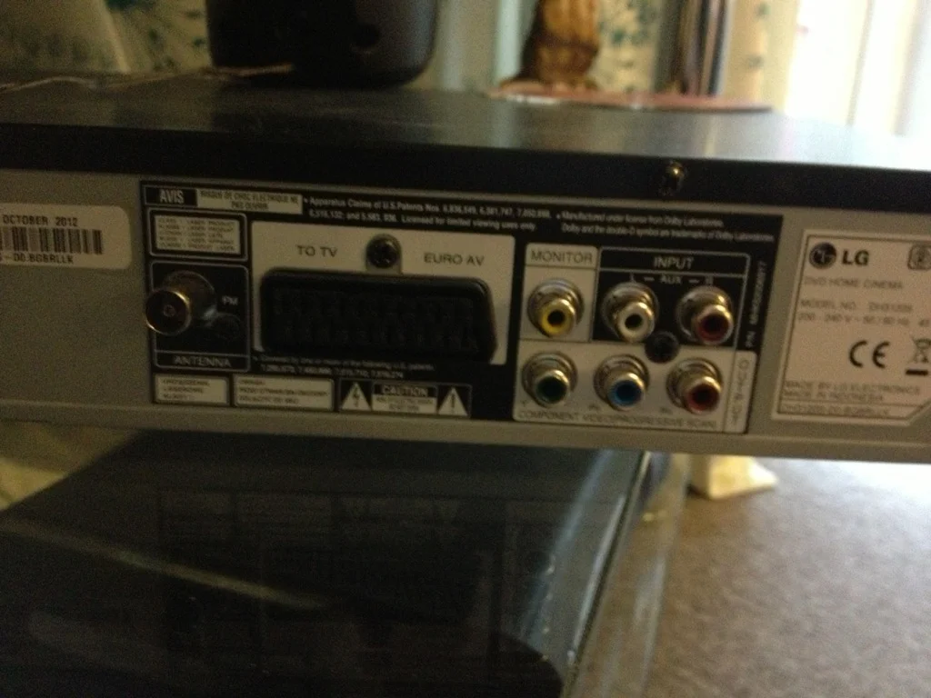

There's every chance I'm being incredibly thick here tbh.
I'll post a pic of the back of the surround sound/DVD box in a minute.
  AB182, Audi A5 3.0
it can't be done with that unit (5.1), you will only be able to get stereo from the TV by connecting the headphone out socket from the TV to the LG. Alternatively, connect the Skybox analogue output to the analogue inputs (not sure if you have a skybox). TBH I would be throwing that in the bin and upgrading to something better like the SR906 above.

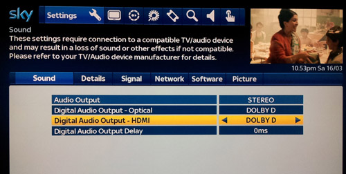

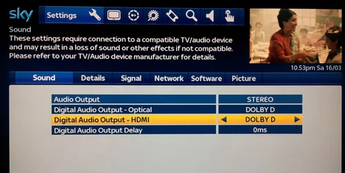

I have it on authority from the av forum and the fact I have a brand new sky box 2tb hd sky + ... they dont pass 5.1 over hdmi andvare unlkkely to do so in the not to distant future
  182, SQ7, Trafic
Yep, this is true. 5.1 only from Digital Audio outputs on a Sky box. Unless your simulating it which isn't the same.

they are in the process of updating the HD boxes now to deliver DD5.1 over HDMI.
The Fatty is right, some boxes do. One box that does is the non-recording HD box that people are forced to get if their dish does have the bandwidth to record and watch at the same time.
