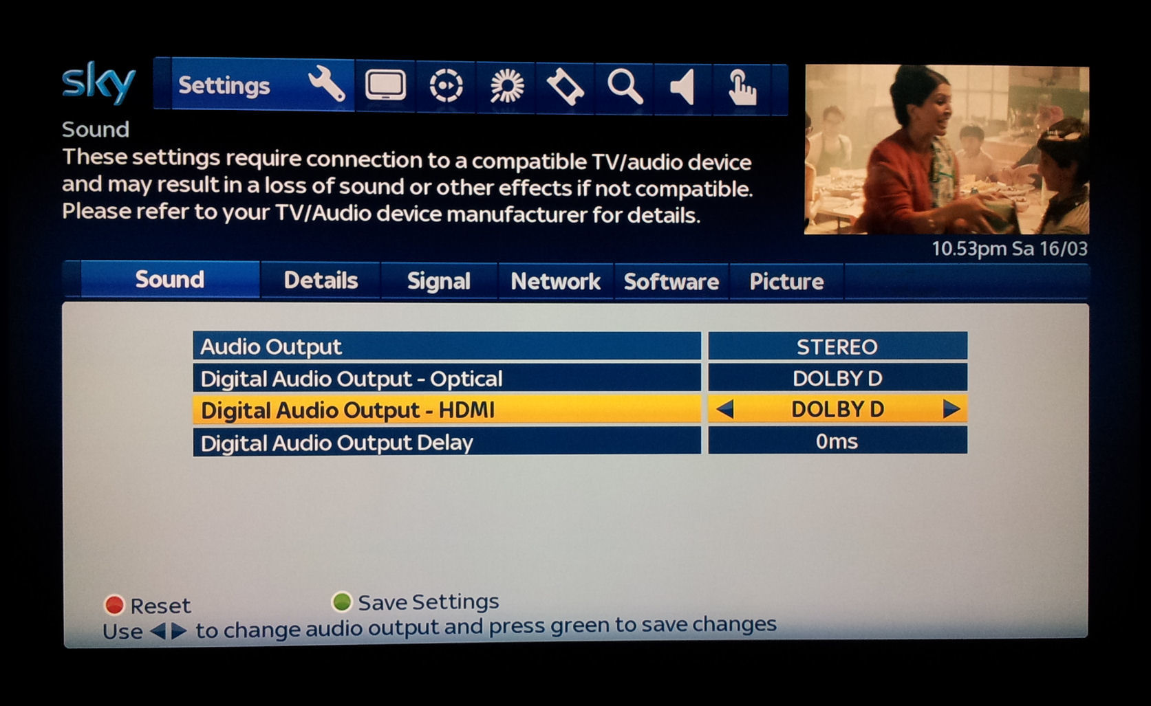

What Amp do you have mate? I can confirm since the update I am receiving Dolby D 5.1 through HDMI on my Denon. I new mine had updated because when I came down in the morning it was on the Sky intro screen. I then looked on the audio settings screen and saw the new setting which looks like this:
This update has been getting rolled out since March, if you haven't got it why not try a forced update? Use the following method:
"Switch the box off at the mains. hold down the backup button on the box, switch power back on whist holding the backup button on the box down until the 4 LED's on front of the box come on and the "Updating System Software" message comes on-screen, remove your finger from the backup button if you haven't done so already, do not disturb for 10 or so minutes until the message disappears and the box reboots."
My box was new in march ..... however done another forced update and now see that menu.
Will see if it configs ok ......
