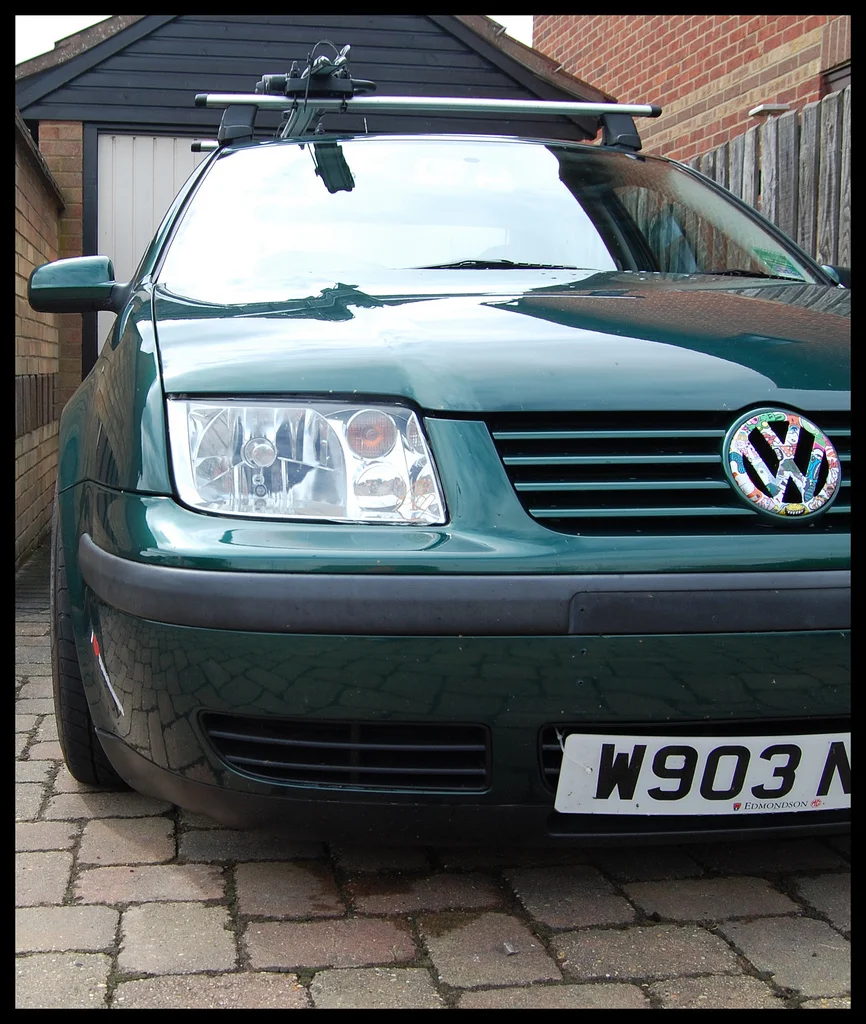

Isopon bumper fill stuff? I'm looking to fill my number plate recess on, admittedly not a clio. But this thread could come in use one day to others.

It'll sink.
To reduce sinking you'll need to plastic weld a piece in place then repair the area around, easy for me, not so for an amatuer but would be a good little project if you had a spare bumper mate.

Jason, you don't want to fill the number plate recess so to speak, get to the scrap yard, get a second hand bumper moulding and f**k about with the bumper doesn't have a recess.
Just fill the holes in and paint!

On another note aren't the US spec front bumper mouldings different, like the tailgates? (You need one of them ;) ) What i mean is do they have the recess in the trim where the plate sits?
If i get time tomorrow i'l get one of our parts monkeys to have look at Etka for a smooth one!
