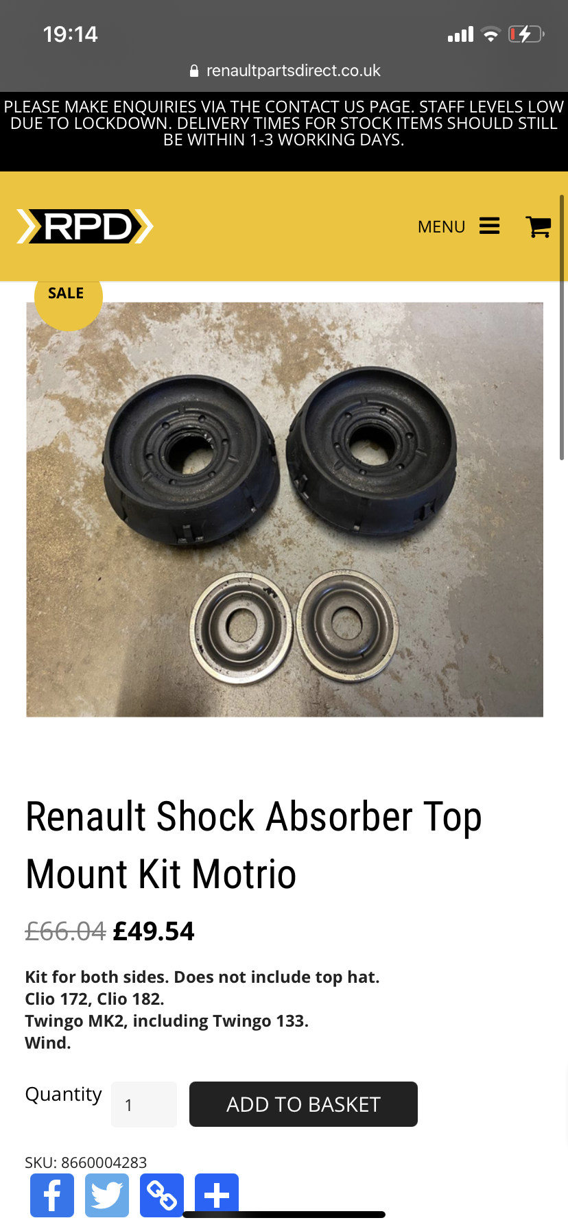

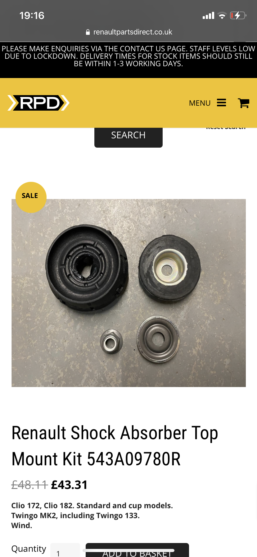

What front top mount for non cup pack 182 > RPD lists 2?

But they also list this as well

I think im being stupid > the second one is just the first one without the nut & top hat
i think you're right, lol! i've used the Febi ones before at 30 quid a pop too and to be honest they're absolutely spot on too
The second one is the cheaper Motrio version (Renault Made)
Its there budget range parts for cars over 10+ years old (I Think)
I wonder how difference there is-

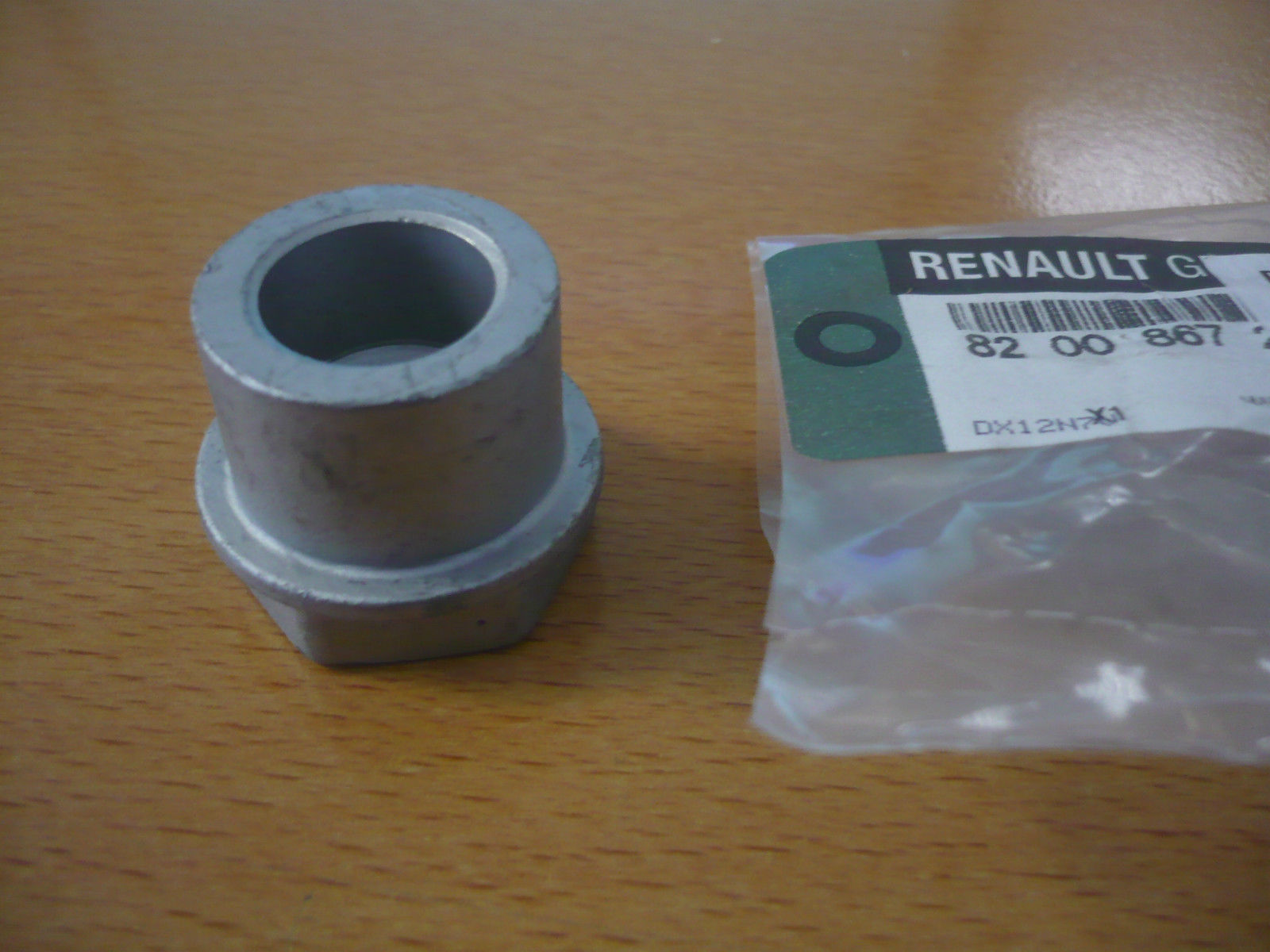

Could it be the spacer nut that's missing. ?
