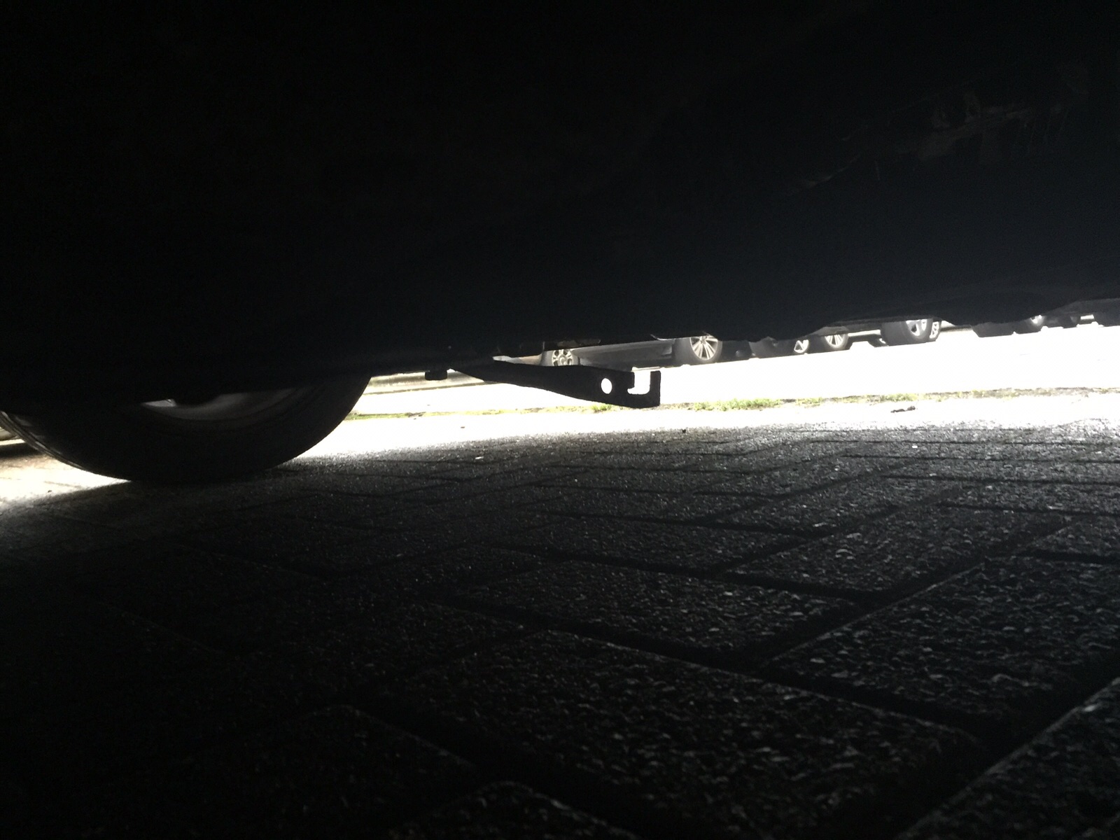

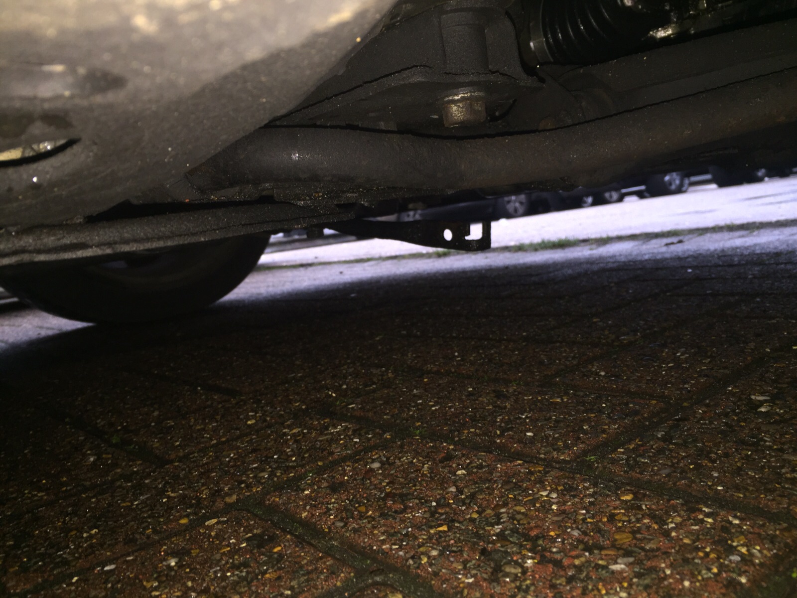

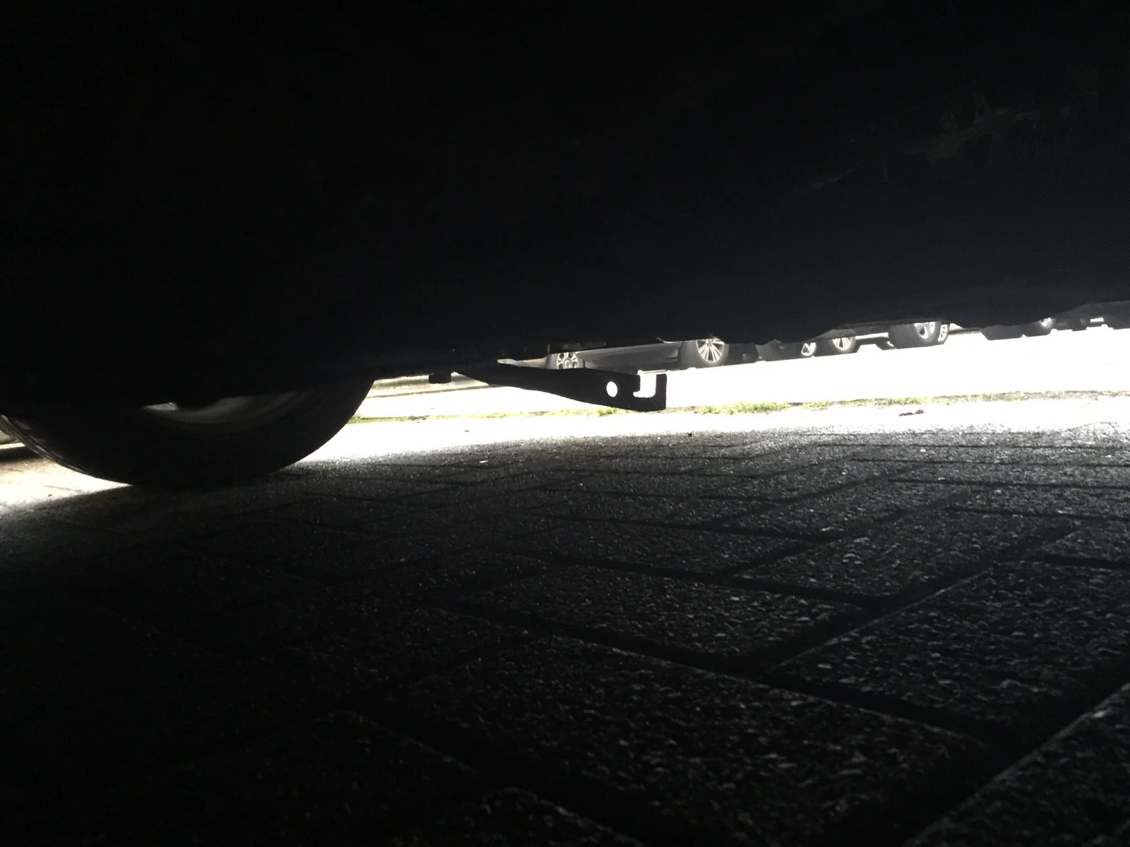

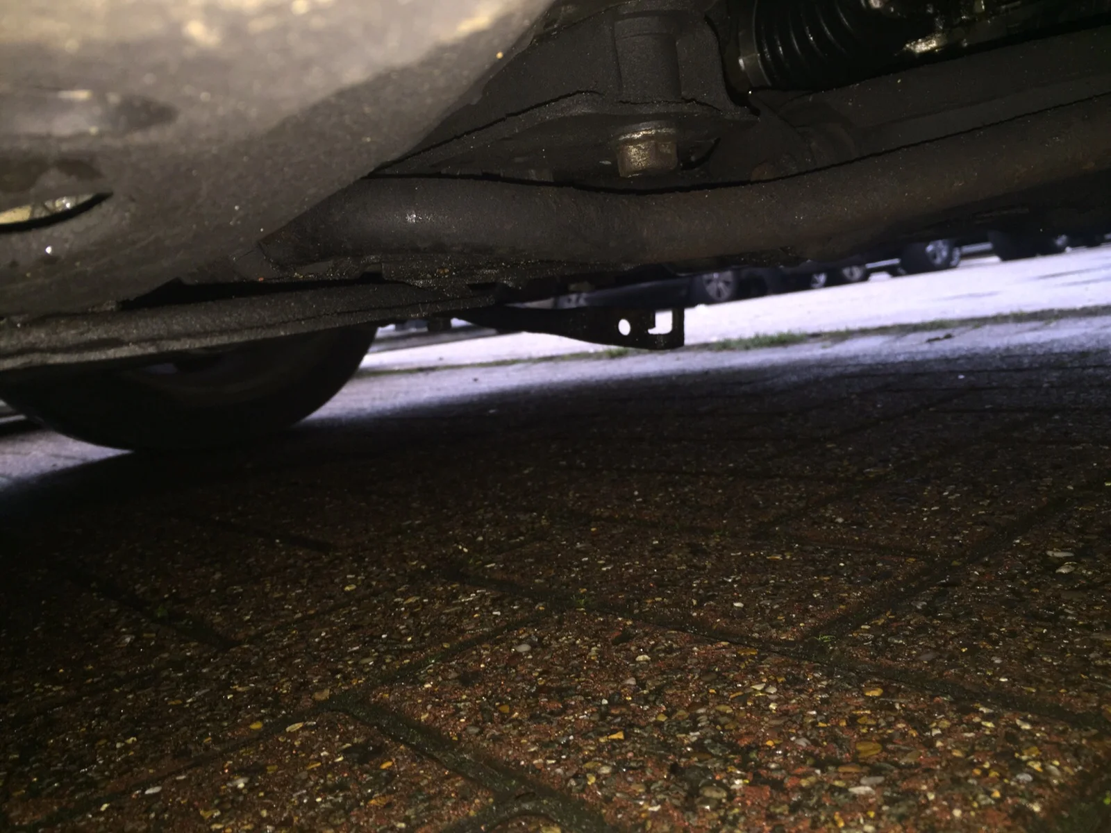

Hey guys,
Could anyone identify what I've broken from this image? It looks like the gearbox mounting bracket to me. Does it look broken or has it come loose?
When changing from first and second gear, my car vibrates a lot as well as sounding really loud.
Cheers,
Bash.
Dogbone support bracket, that is.
Basically, need to check the dogbone is still bolted up.
If the dogbone is still bolted up. Could I just bolt the two together again?
Any idea how much the mount costs if it needs replacing?
Cheers.
Cheers.
Yep, could be a simple case of bolt it all up again.
New mount isn't expensive.
Worst case - gearbox casing where it bolts up may be damaged.
Hope that is the case. Gonna get it looked at after I finish work today.
This was all due to the stupid alligator teeth ramps at a school car park where I play football.
Just realised I never actually re fitted this bracket, put a big washer on the dogbone though.
