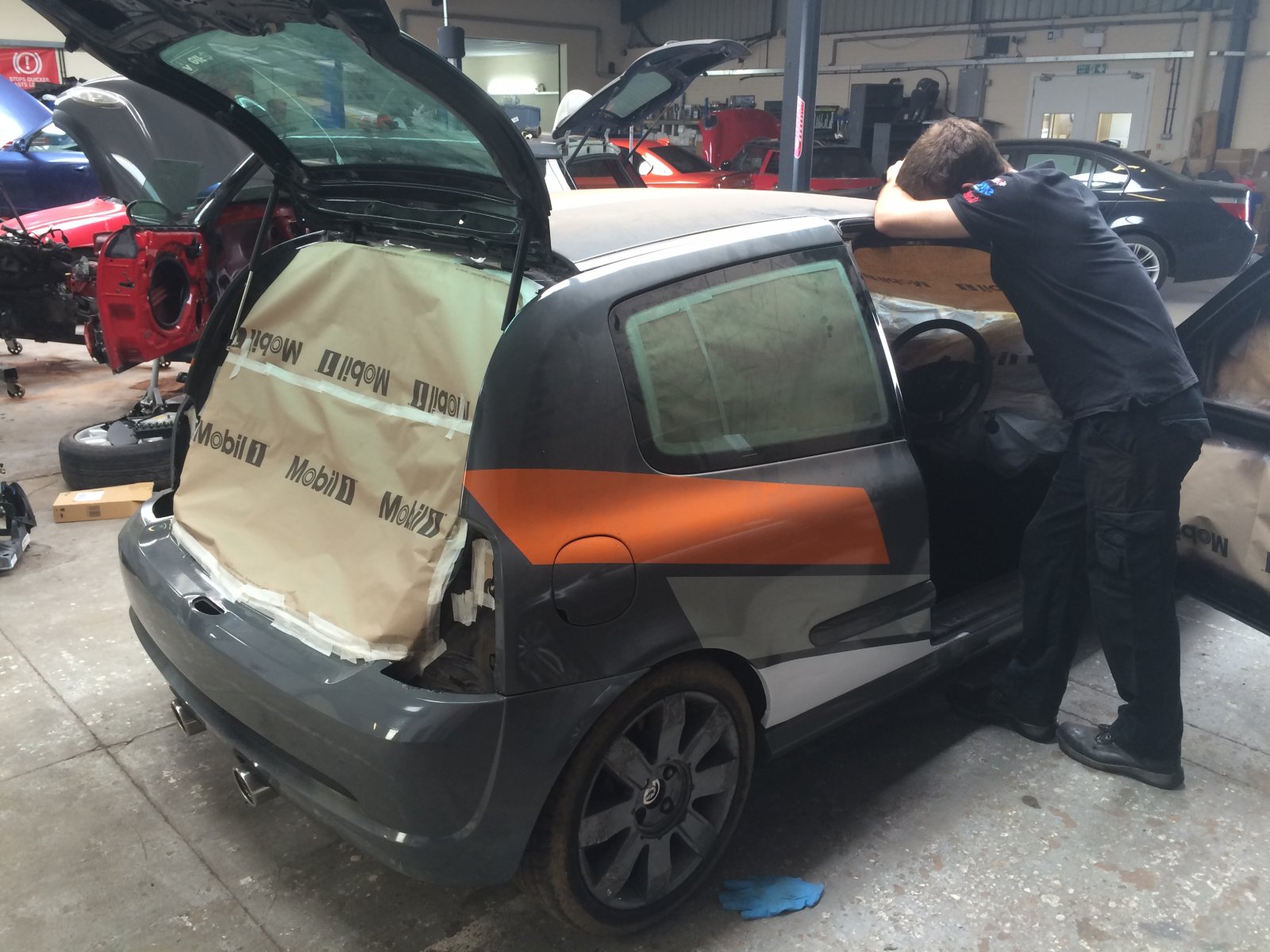

Went to see progress of build today, nearly finished the painting inside couple more layers to go then the dash cage seats etc can all go back on/in.
Also had my cliosport stickers delivered today so will get them stuck on!

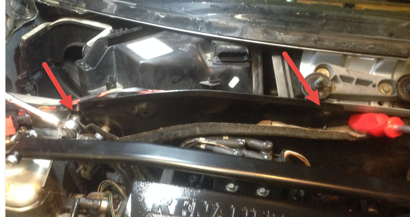

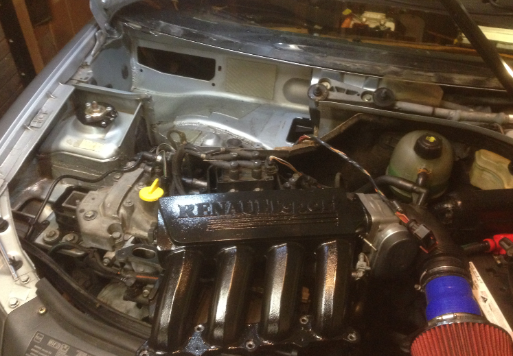

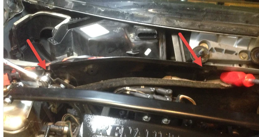

Fitted Pure Motorsport aircon delete kits months ago. Finally got around to removing the aircon heater coil under the skuttle. What a ball ache. Figured out you have to remove this panel in the firewall, the engine intake casting (with coil pack) and that the two nuts holding the inner plastic ducting in place are inside the cabin way up high under the dash. . ..

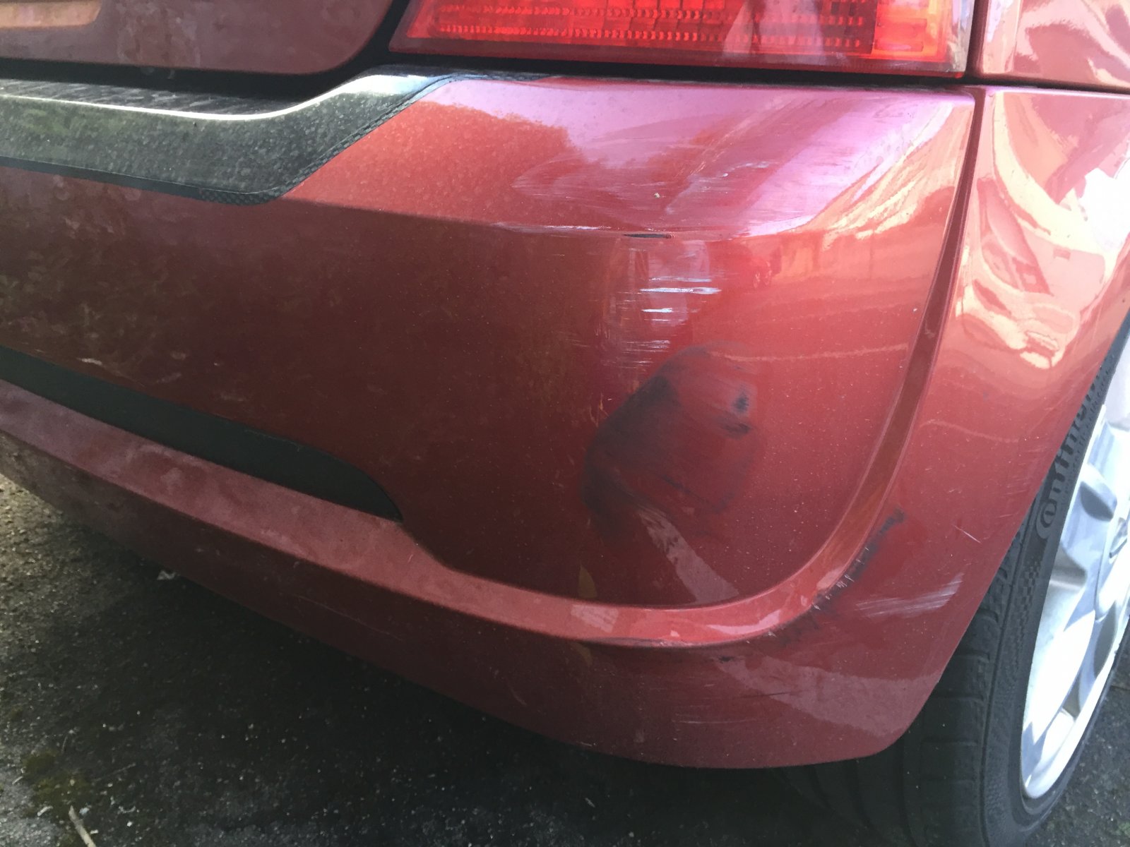

Then someone drove into the back of me whilst in stationary traffic, glanced off my rear bumper and stopped alongside me on other side of the road :openmouth:. Said dashcam wasn't recording though :weary:😂.
Minor damage only fortunately:
Definitely not ideal @oreA poor flamer!
Actually I consider myself lucky! I was sat for probably a minute in the queueing traffic - the driver couldn't have been concentrating at all. I heard screeching first and then saw her looming larger & larger in my mirror, smoke pouring from her tyres. I pulled forward and left as far as I could to reduce the damage then braced myself expecting the worst 😊. How there was so little damage I don't know, she clearly swerved to avoid me but could've killed herself hitting oncoming traffic. She was shaken to say the least :grimacing:.
Anyway, I might be able to get rid of that horrid black wrap-job on the rear bumper for free now :smile:.

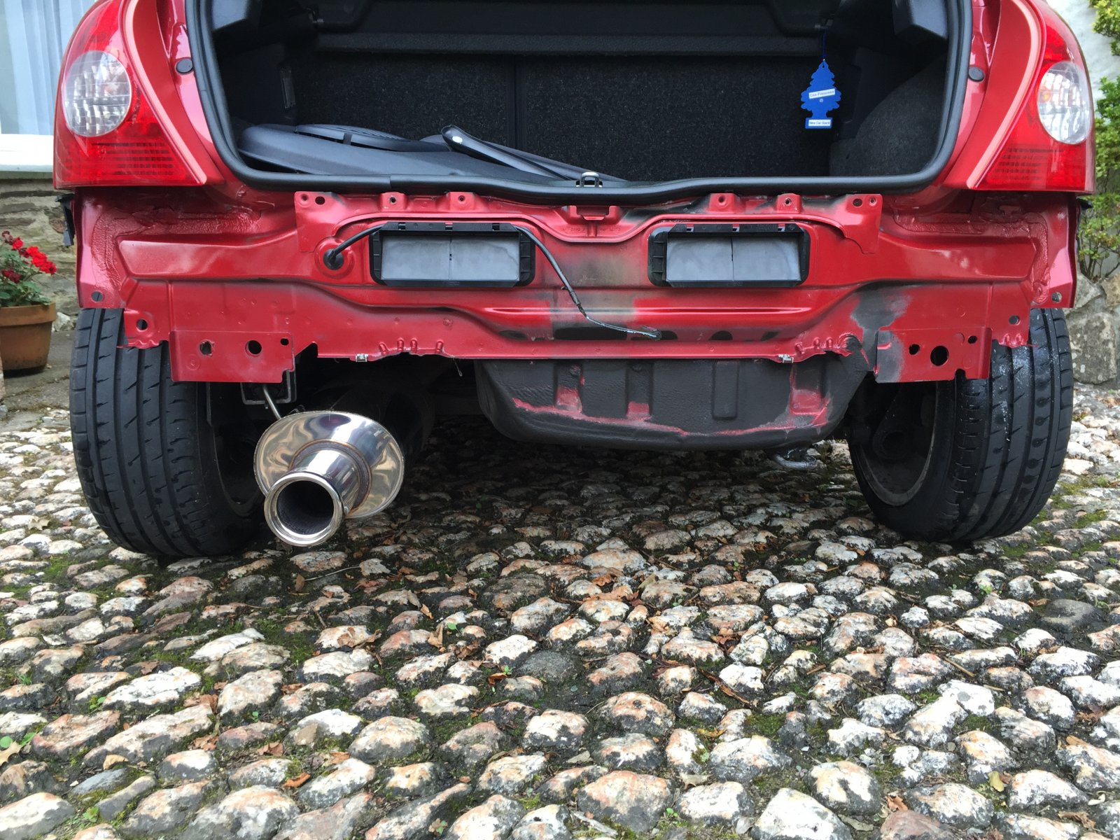

Because a young lady drove into my rear a couple of days ago (see a few posts back ^), I thought I'd remove the rear bumper and check for damage. Not one thing was broken or damaged or bent or twisted. Got lucky me thinks :cool:.

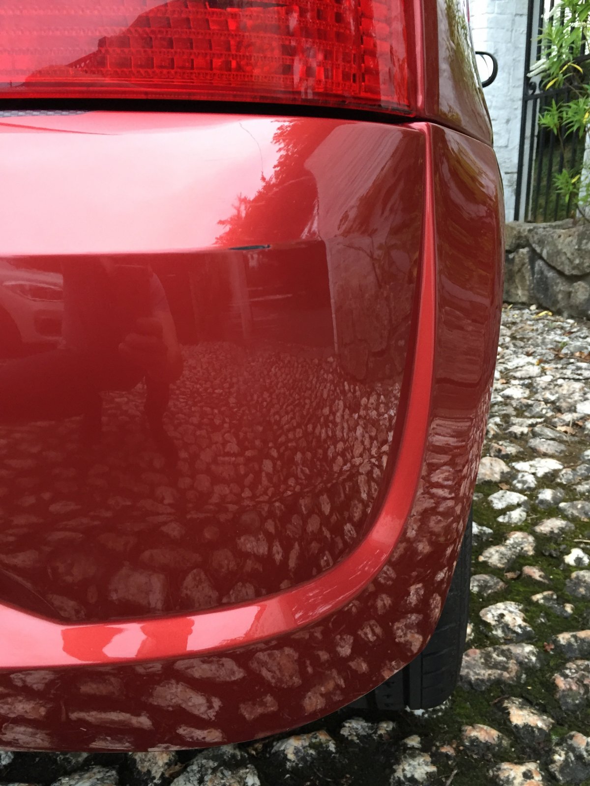

All that remains of the bodywork damage after some compounding, polishing and waxing:

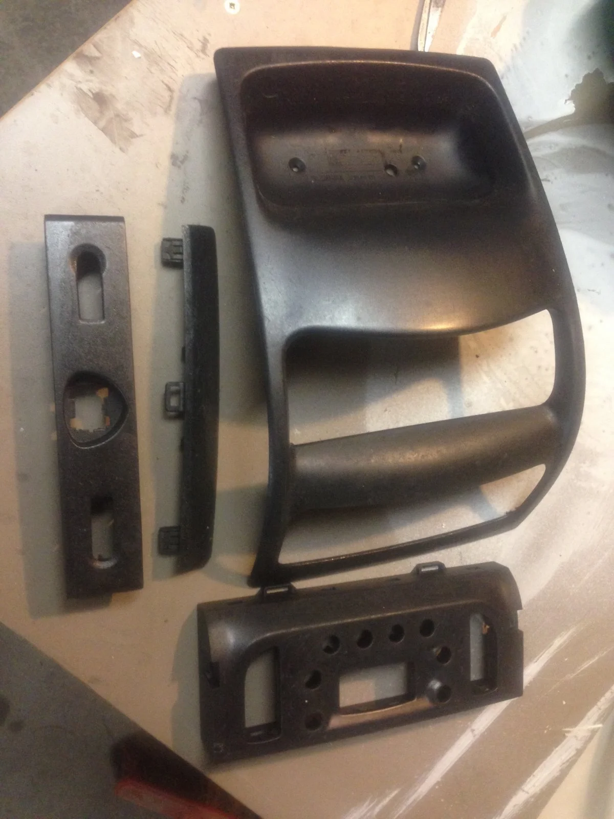

removed dash (pretty easy thanks to the guide here) and the sticky rubbish plastic surrounds around the heater controls, centre plastic surround (had to cut the heat sealed bits away) - ready for paint.

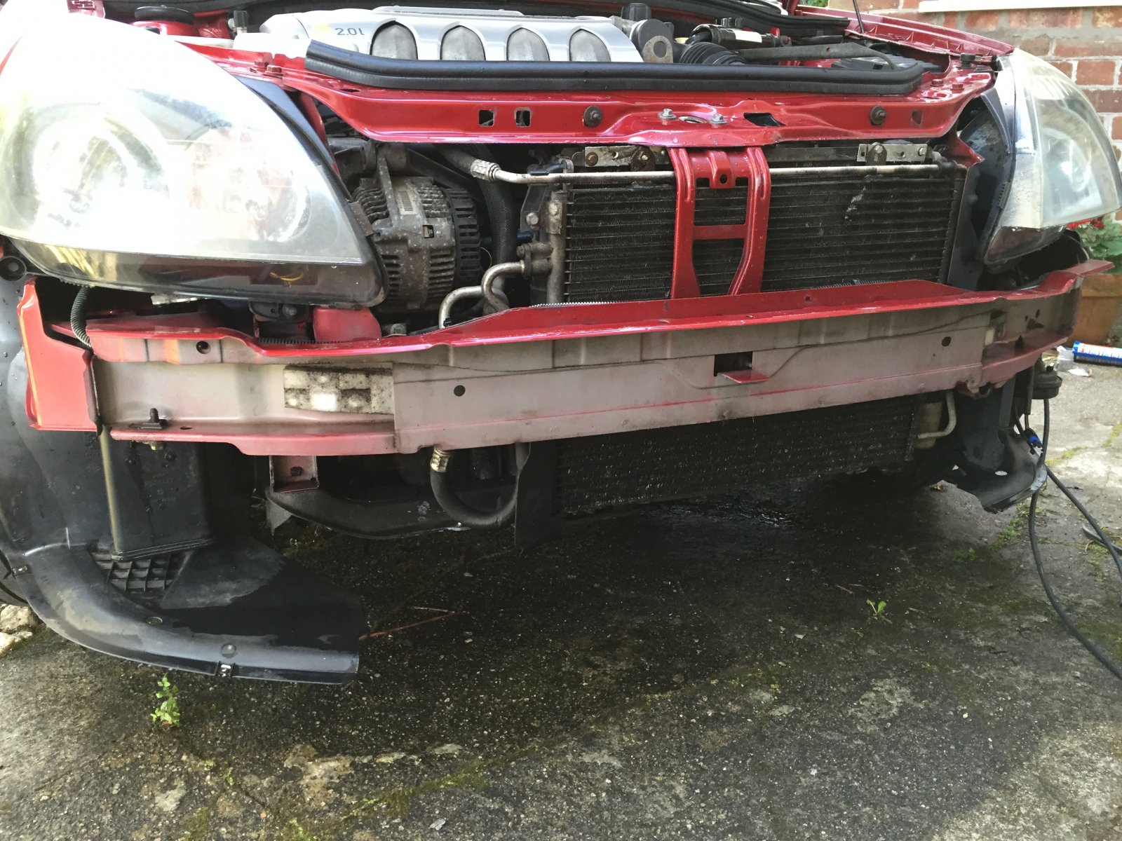

Bumper off to fit new headlight washers. Turns out the pump is kaput too.
Noticed the aircon rad was hanging by a thread and had to cobble together some makeshift fixings :tongueout:.

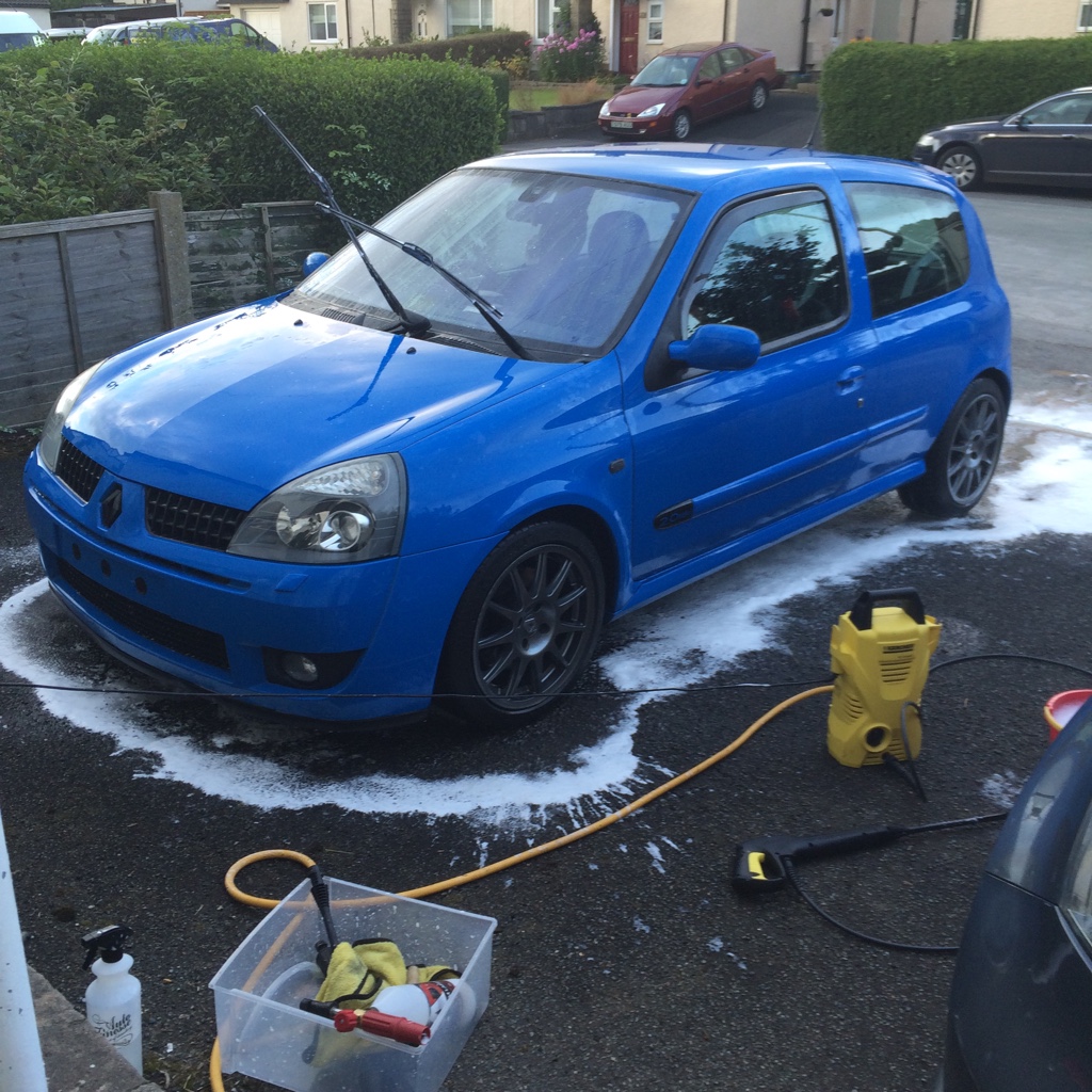

Washed it, and spent over an hour on the wheels, even though they were refurbished & sealed last year (that DLUX stuff is the tits!) multi spokes are a complete PITA!! It still looks the absolute nuts!!
Worthless post without pictures :smile:.

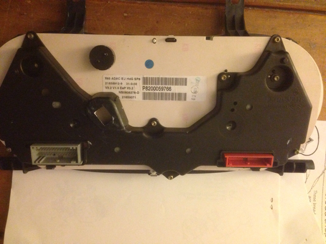

Removed instrument cluster to get at the highly annoying over speed alarm. This comes on at around 120km/h. Culprit was a little piezo hidden behind the rear. As shown.
