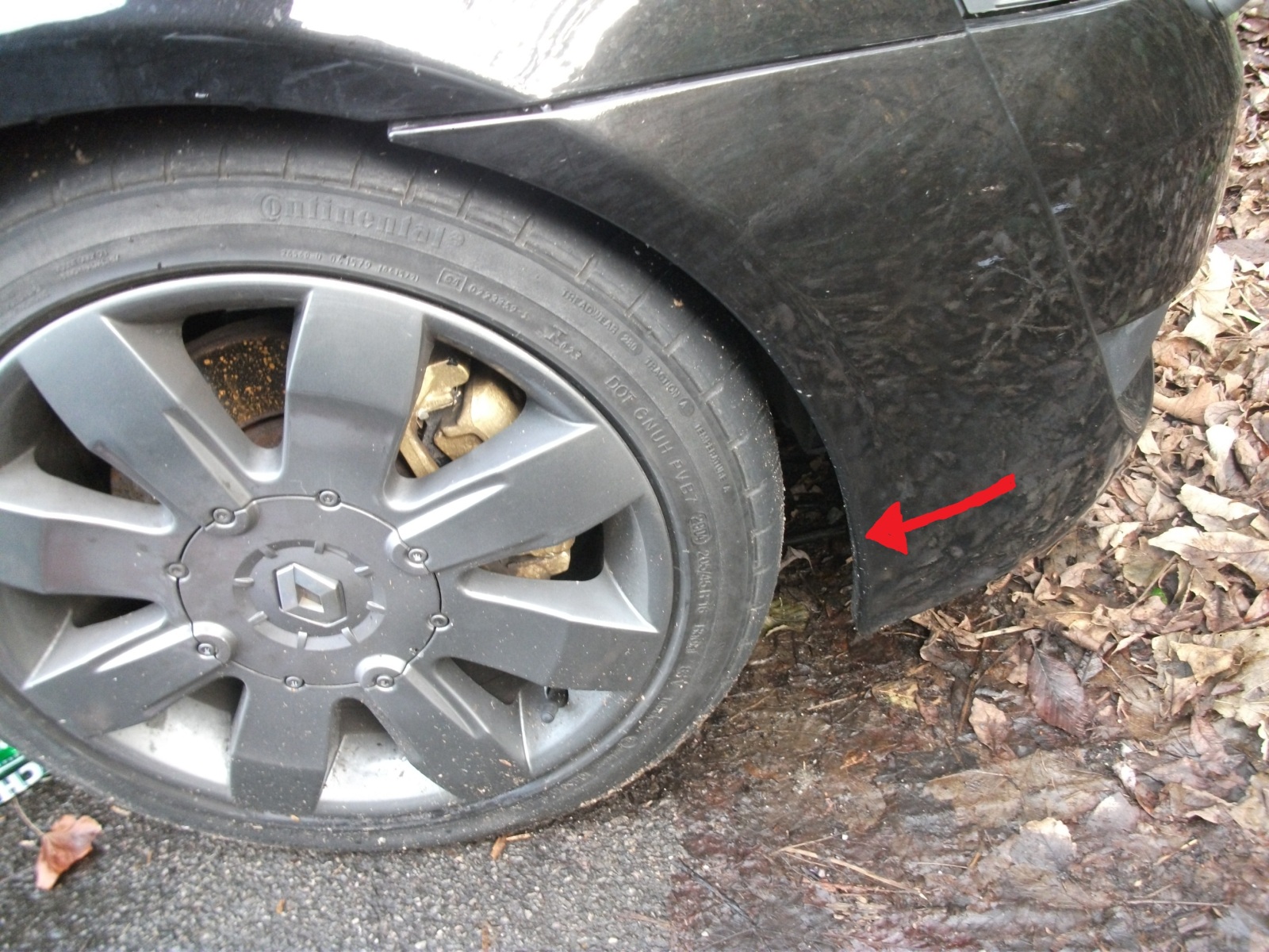

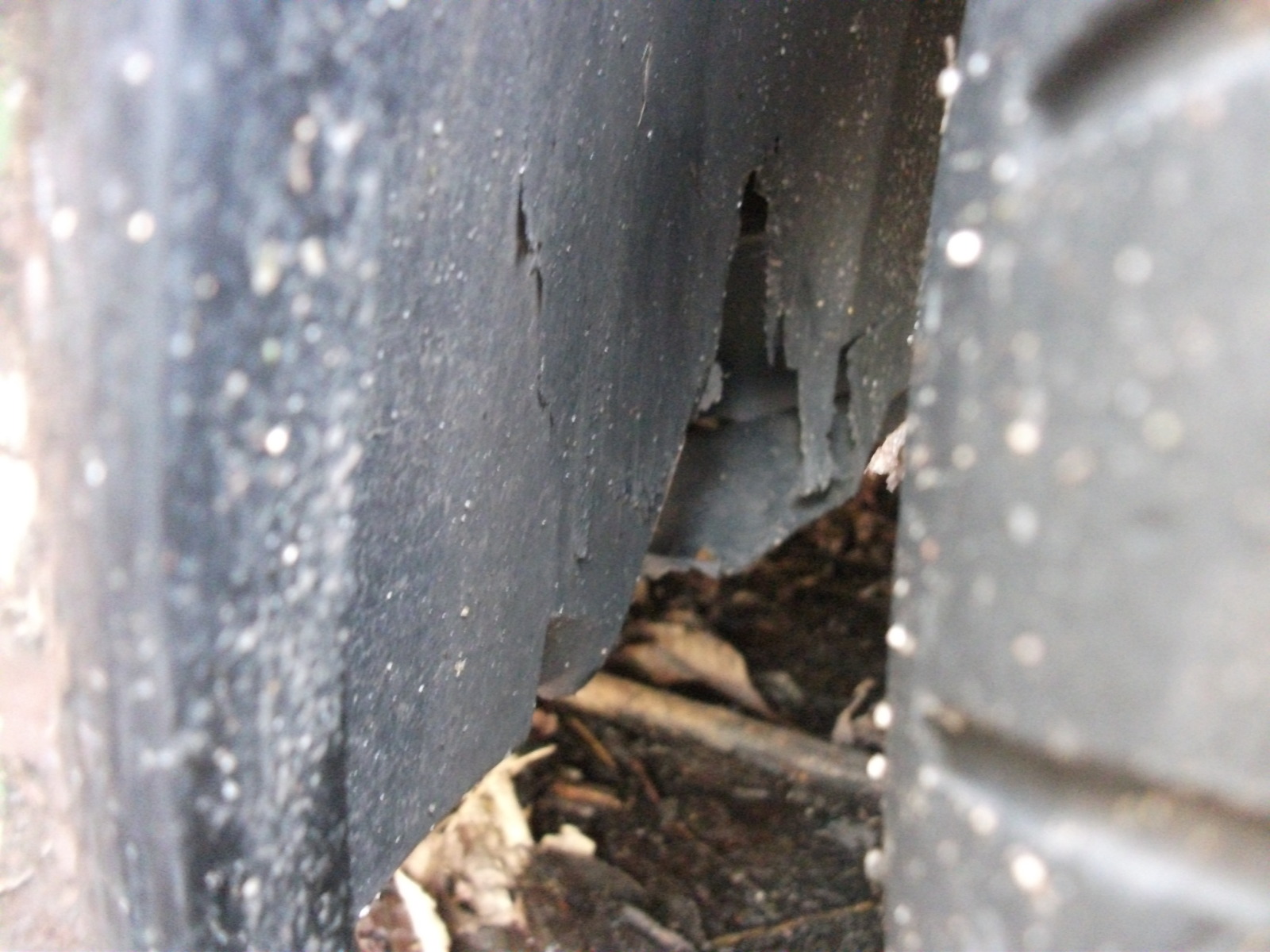

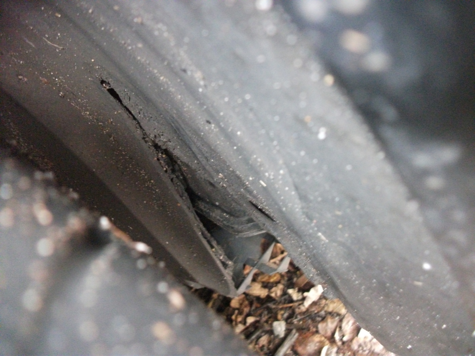

I have only owned the car 2 weeks and just noticed this rubbing, I haven't heard anything at all? Just wondering if anyone has any ideas on what i could be in this position.
Checked the tyres and there are no bulges or marks at all.

Is the arch liner loose? I had a similar issue but I could hear a rubbing in my car when going round right hand bends above 40mph. Turned out it was the lower plastic floor tray thing being forced down with the wind scraping the floor. Had me baffled for days!

Take a picture from side on, it looks like you have either too much caster from the first pic or your arch lining is loose.
Tyre looks flat too
May well be this! Thanks, I'm going to go and check, going to need to get hold of some new arch liners though :dead:
