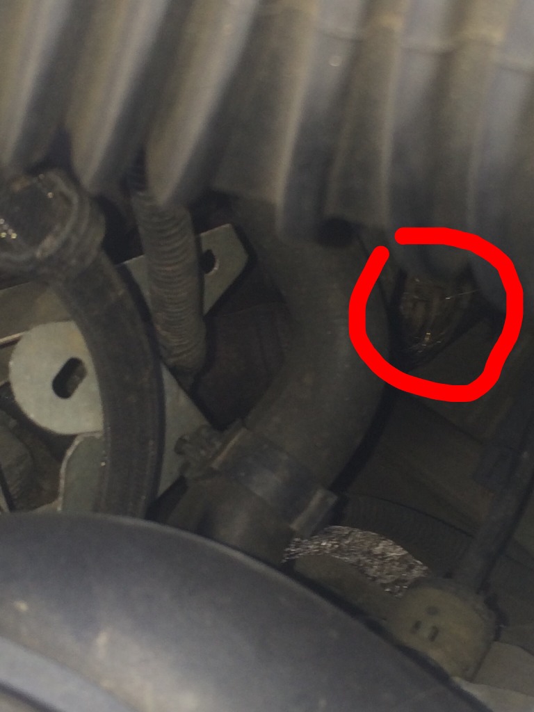

Firstly, apologies for the bad photo, maybe it's too bad you won't be able to help but anyway, my exhaust started blowing, sounds a bit like a helicopter. Popped the bonnet and had a listen and there's a pipe which looks like it's wrapped in wire, and the wire is frayed slightly, am I right in thinking that's the flexi? Are these easily repairable?

is that your steering rack gaitor ??
such a crappy pic
I really cant make that out
im off lol , steering rack gaiter !!!!! , I really should read the post first , BYE BYE :banghead:
  Clio 172
Manifold flexi broke, common problem on the 197. Your best bet is to chop out the flexi and weld in some new sections. A bit of googling should give you the part numbers, I believe they are made by Bosal.

Here's a couple more clearer pictures just to make sure. One of the part and one of its location.
  Clio 172
The parts themselves were less than £50 if I remember rightly, the rest depends on if you can remove and refit the manifold yourself and do the welding or know someone who can weld.
I helped a friend fix his, we had the manifold off in a couple of hours, cut off the flexis and got a friend to weld the new ones in, another couple of hours to refit.

Yeah, got a friend of a friend who could do it but will cost a couple of hundred because he thinks the manifold will have to come off!
