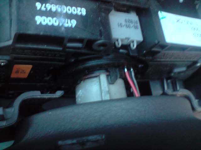

C coxxy Car Monaco Clio 172 Jun 26, 2010 #1 This is behind the steering wheel. What is the black plastic ring because its broke and keeps clicking and how do i go about changing it
Rob ClioSport Moderator Car 650 - V8 Goodness Jun 26, 2010 #2 I'm going to guess and say its the auto indicator canceling thing, I'm sure someone will be along shortly to agree or shoot me down
J James.f Car Astra 1.9Cdti SRi Jun 26, 2010 #3 ye i think Rob is correct, it slots into the back of your steering wheel, so when you use the indicators and turn and then straightn the wheel indicator goes off, mine's snapped and is a pain, i keep driving for like 2 miles with indicator still on
172Ben Car BMW M3 Competition Jun 26, 2010 #4 I think its official name is - Airbag Squib Slip Ring Connector The black thing that has a wire spun round it allowing it to be connected to the horn, while being able to be spun around.
R richy22 Car Bumder With A Buffer Jun 26, 2010 #5 You need to buy a new squib if that's gone. Mine was broken and clicking and it also houses the steering wheel angle sensor (again mine was gone) cost me £40 fitted for a secondhand one on Thursday.
J James.f Car Astra 1.9Cdti SRi Jun 26, 2010 #6 richy22 said: You need to buy a new squib if that's gone. Mine was broken and clicking and it also houses the steering wheel angle sensor (again mine was gone) cost me £40 fitted for a secondhand one on Thursday. Click to expand... Why? hardly does f**k all tbh, im driving with no horn + thats plastic is broken, dont get any problems atall,

C coxxy Car Monaco Clio 172 Jun 26, 2010 #9 or will it be just the plastic ring with red and black wires for horn???
adam172 Car CLIO PH1 172 Jun 28, 2010 #10 will it not just super glue back together if its a bit of broken plastic?
C coxxy Car Monaco Clio 172 Jul 3, 2010 #12 does the ring av to be off a sport or can i get it off a say a 1.2 from scrappy
