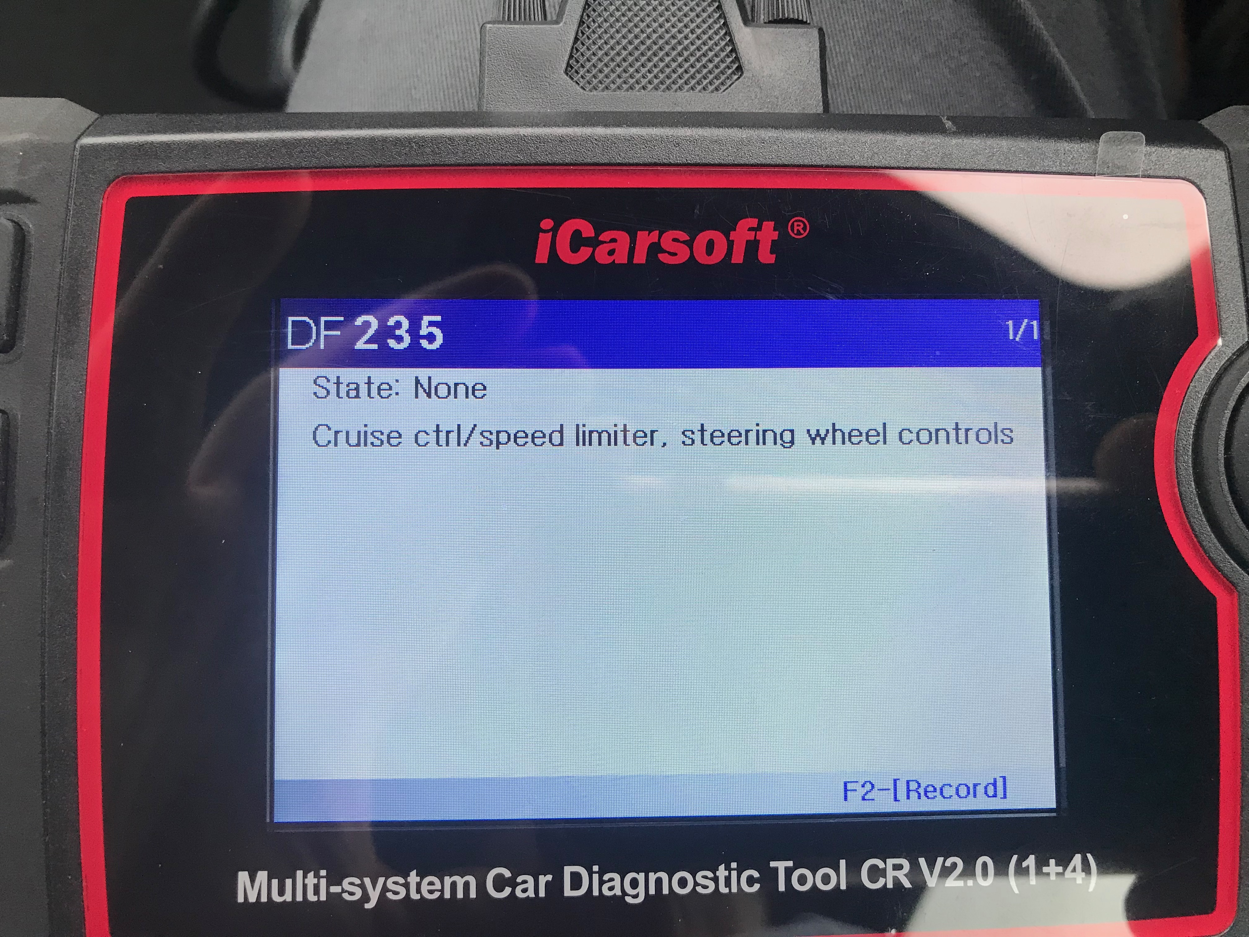

My last 182s cruise control never worked but my current RBs always did.
When I sold the car I swapped the steering wheels over but now the RBs cruise works intermittently and throws up a DF235 fault code.
So as @SharpyClio mentioned, it's possibly something to do with the steering wheel buttons.

Hook it up to clip if you have access, to check the switches are working and see if any fault codes are stored.
