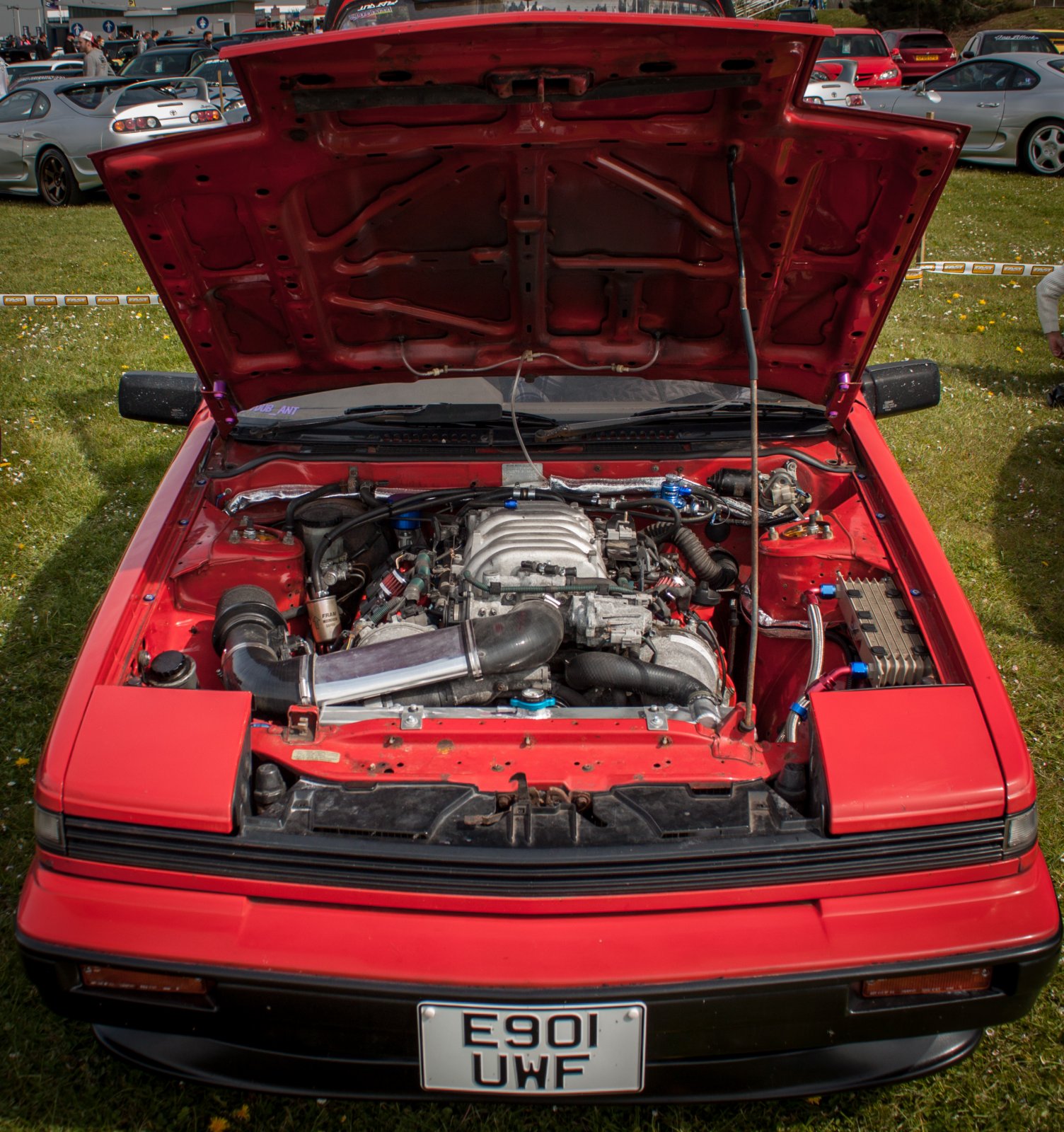

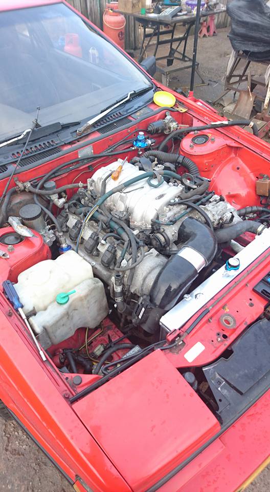

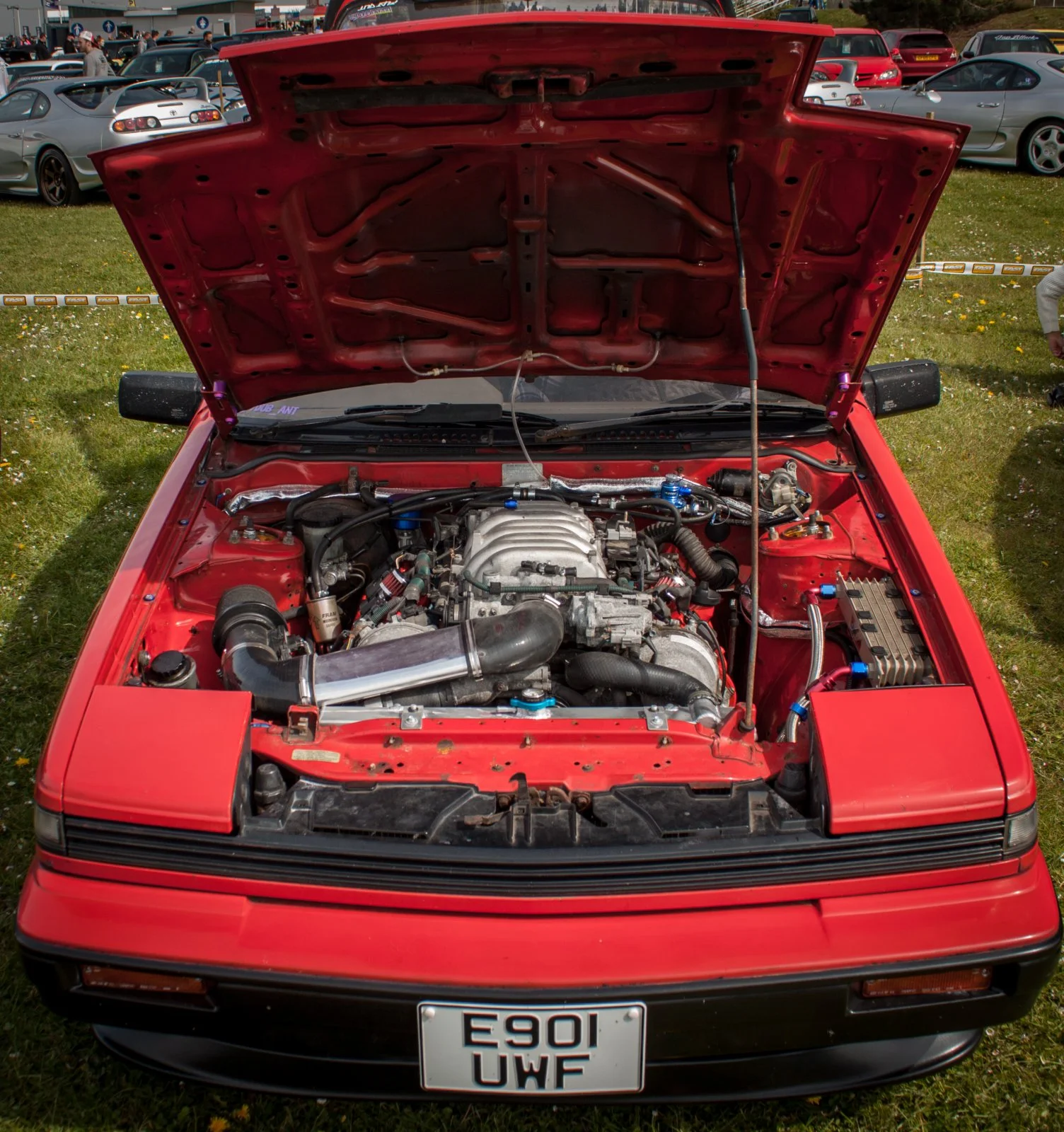

A fried of mine has just mated a lexus 1UZ v8 with a manual 330d box for his S12, it's pretty awesome, I can get more info if required:)

To be fair, his 200SX was pretty brutal even with the standard V8 in it. It had a decent chunk of mid-range grunt so could break traction with ease in pretty much any gear.

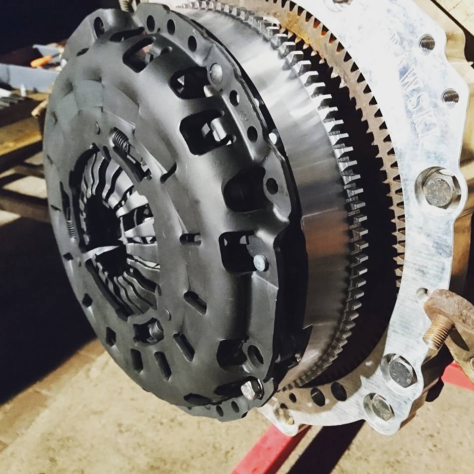

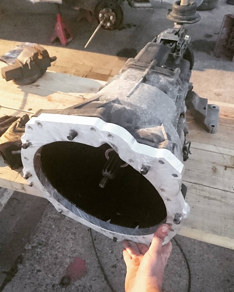

Please do. Thanks
His full build album is Here

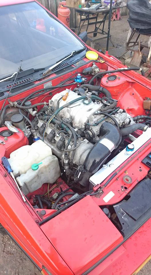

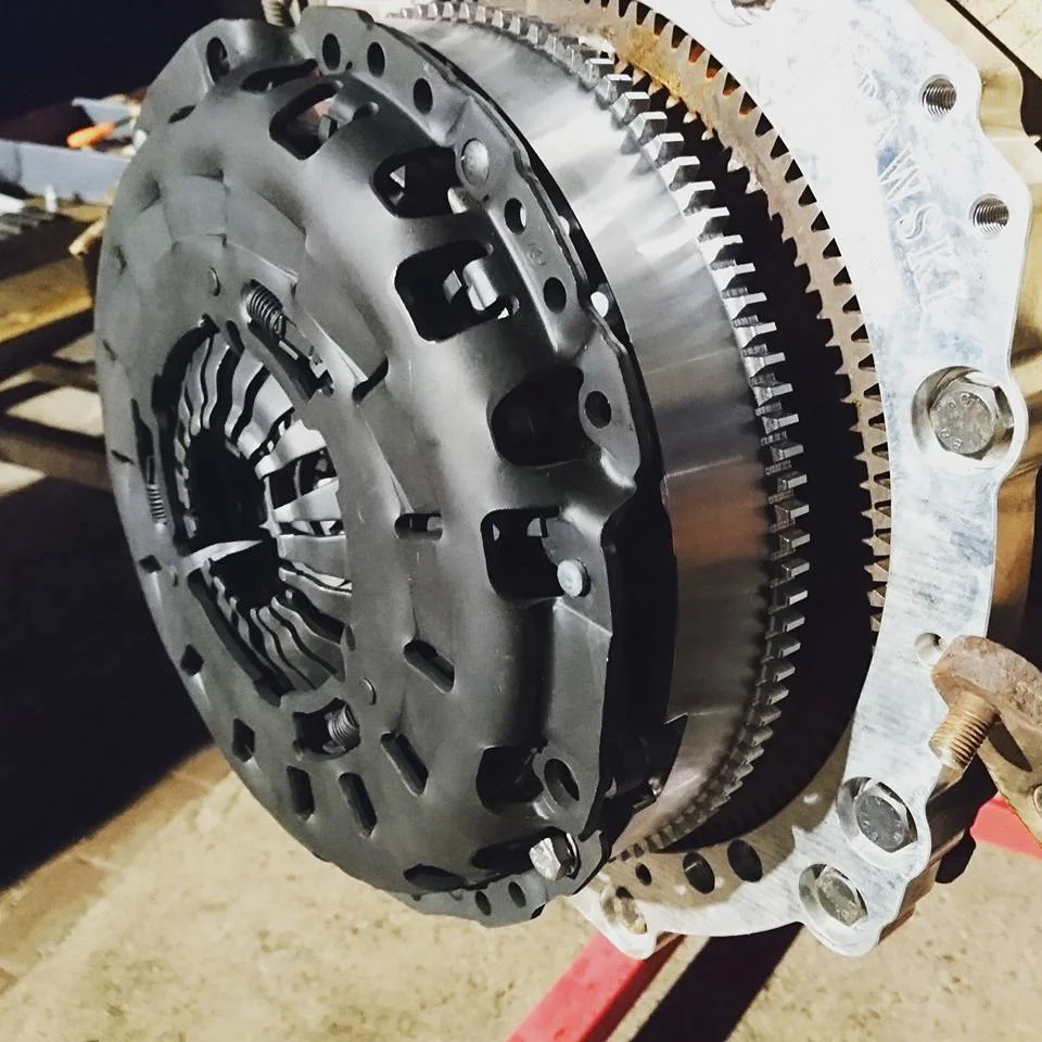

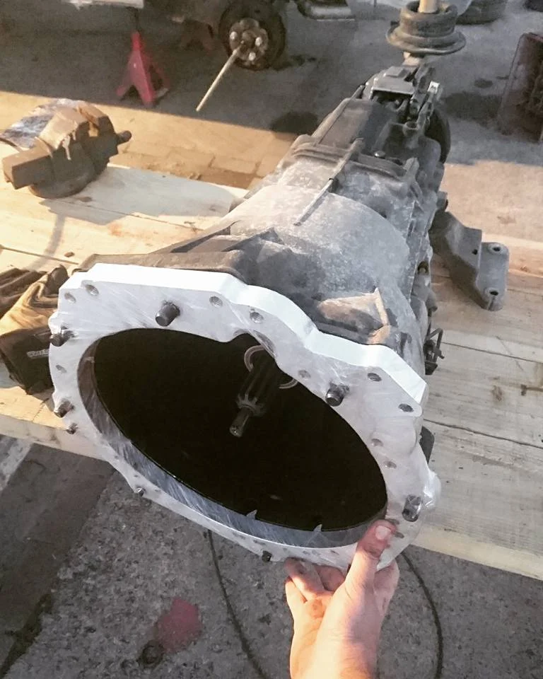

Not sure wht it is set to privacy wise but I've attached a couple of pics showing the adapter plate, it was all homebrew driveway stuff, 330d manual box is needed because it has a 35mm input shaft whereas the petrol one only has 24mm I think he said.
15036404_1324154870930958_5120128007375353579_n.webp 15109415_1340585902621188_1367517414949651162_n.webp 15541640_1368134726532972_4834780706575256072_n.webp IMG_9033.webp IMG_9083.webp
Ffs that plate looks expensive lol
And I'm sick of making adaptor plates lol
Could you find out what flywheel and clutch he used and whether he has a CAD drawing for the adaptor plate?
Thanks

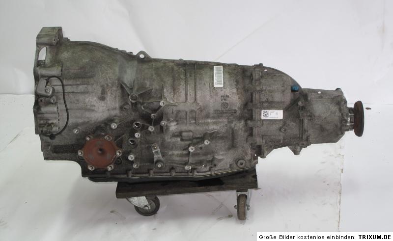

In which case the auto box situation is:
  • You can fit a manual quattro box, which is no use outwith an audi
  • You can fit manual FWD box I believe, which is only useful for M-R layouts.
  • No RWD box exists which will bolt on
  • Flywheels arent common at all
So once again you're back to looking for a box, adaptor plate, clutch and flywheel, just like every other engine.

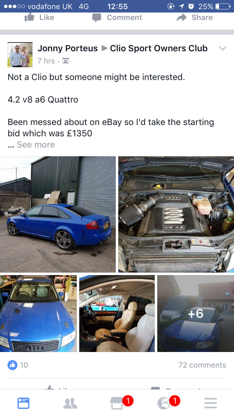

son of a diddly!
mid engined V8 RWD mk1 focus?
Even a rotter/scrap car?
They get snapped up in no time at all, years back when there were plenty and cheap the drift lads got hold of them and basically ruined them all.
Now even a scrapper will go for silly money, I'd say north of 3k just for the tuning gear, even the manual 535i's are silly money too even though it's a bit of a pointless engine.
