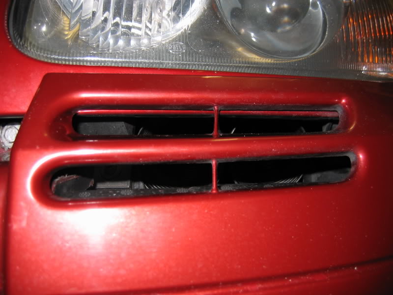

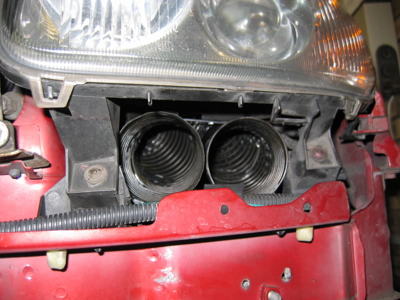

I have ITG filter in the satndard airbox and using some 70mm ducting have feeds from the intake by the headlight.
Like this!
You can either take out a foglight and run a big one from there to whatever you decide to have or re-route behind the underlight bumper grille near where the standard ones go.
You can just pull the pipe off the right hand side of the air box if you want a nice sound;) and I haven't noticed any decrease in performance what so ever with that method.
