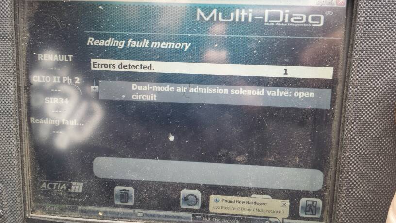

Spotted this while running diagnostics on a 182. Ran it initially to wipe decat emission light.
What does it mean?? And what does it mean for the running/health of the car?

I believe this is to do with the acoustic valve located in the passenger side behind the bumper. Lots are removed/disconnected and it shouldn't cause any issues. My car is the same.
OK thanks mate. Runs spot on. Just wanted to know for peace of mind.
