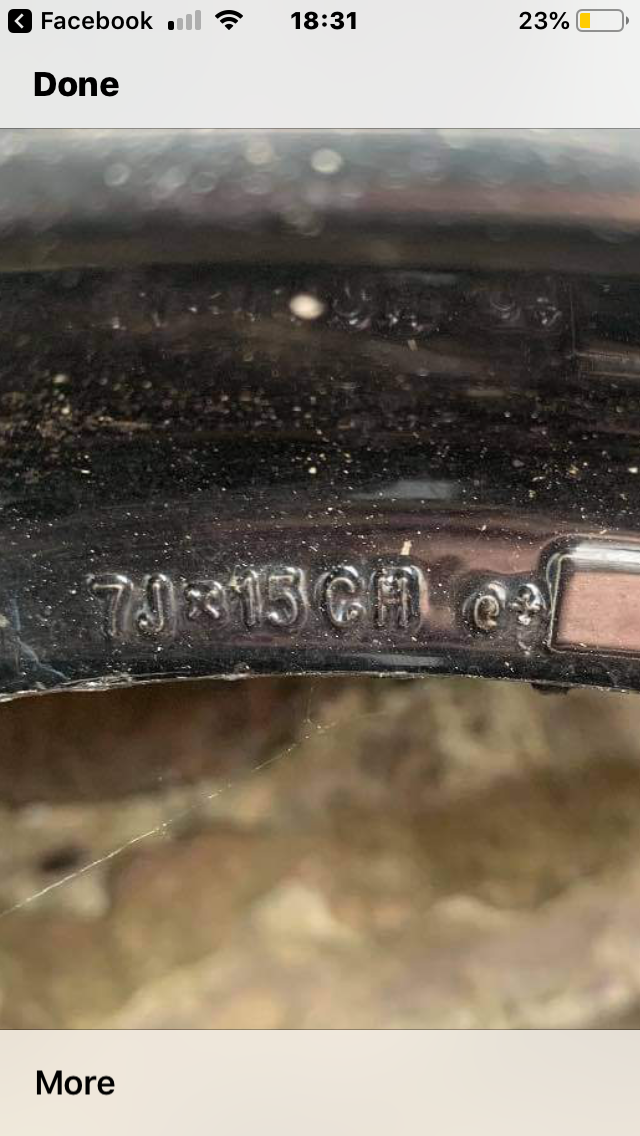

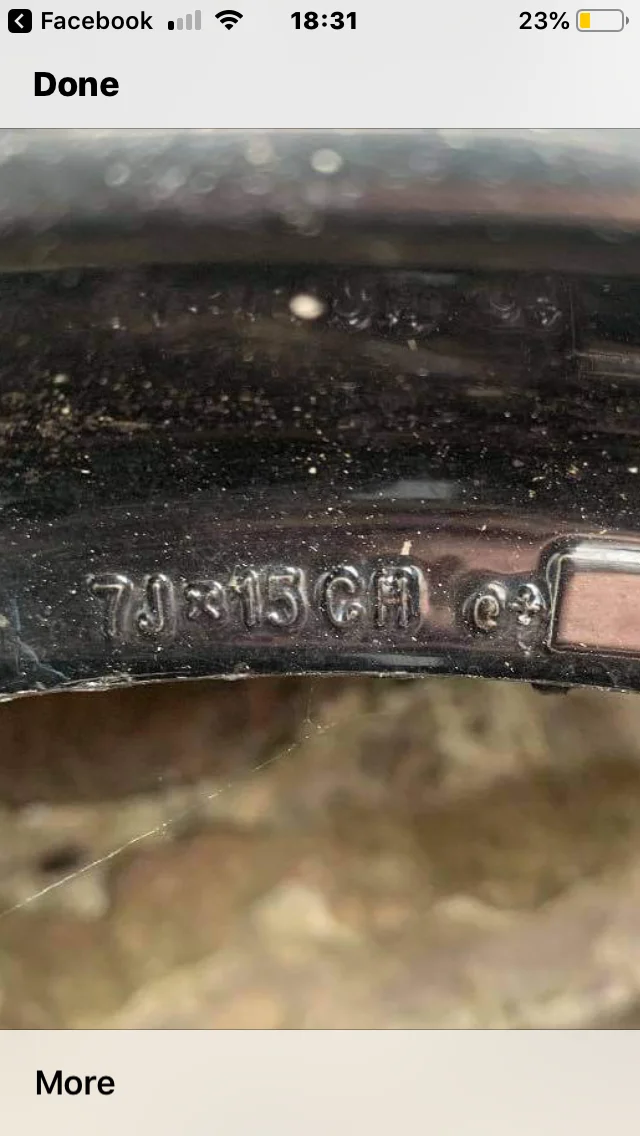

Does anyone know if this will fit my 172 cup?

1*2s are 4x100 PCD, with a 60.1 center bore, so as long as the wheels have the same PCD and the bore size is the same or bigger then you'll be fine. If the bore size is bigger then you'll need spigot rings.
