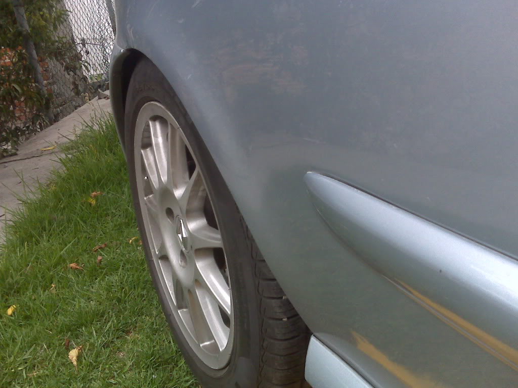

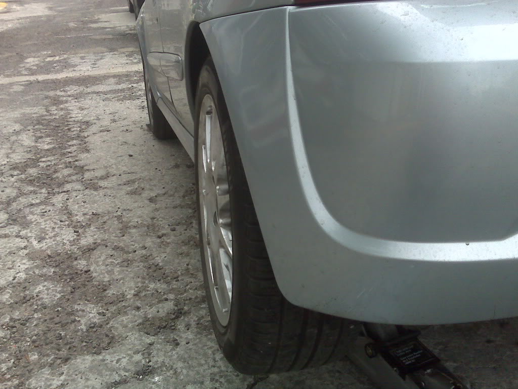

any one got these on there car ? just thinking as the wheels dont look ryt at the back looks as if thay need to come out a wee bit
pics welcome

Thats the ph2 style bumper. They stick out more than a ph1 and make the arch look bigger towards the back :dead:
I'd leave it mate but if you really must then 3mm brings you to et35 if its a Cup.

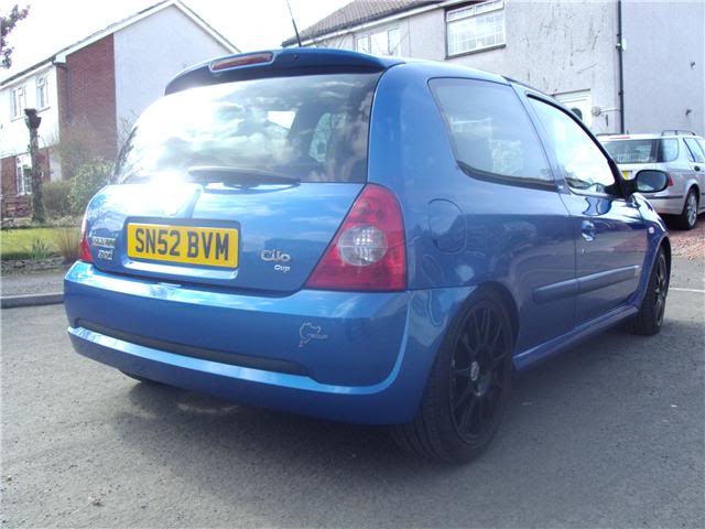

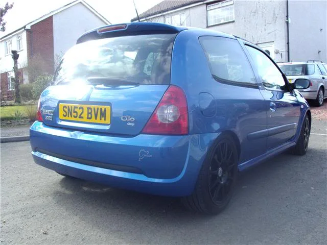

i have 5mm on the back with 205 tyres lowered on coilovers and it only scrubs if i have got weight in the back or if i hit certain bits in the road! but looks perfect imo! :)
