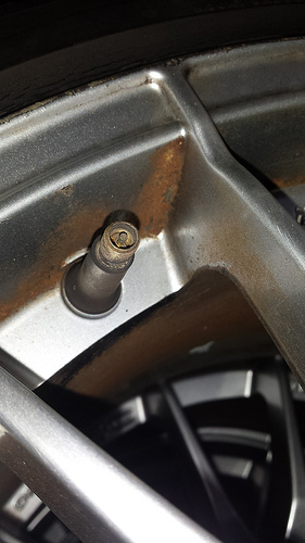

I've got some wheels caked in brake dust, I've tried using AG Tar Remover on them which did nothing.
Any suggestions on something to get it off that is really strong? Don't mind if it affects paint, the wheels will be getting a refurb once they're cleaned up anyway.

Iron X, Ferrous Dueller etc are the kind versions.
If you want something that does the trick and eats EVERYTHING on the wheels- wonder wheels from Halfords, or brick acid. Make sure you glove up for the last two as it's vicious stuff.

As above, don't bother. Acid strip and shot blasting (if done) will remove it. You're just wasting time, money and energy.

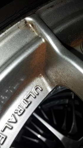

They're not the standard Clio alloys though, they're Ultralaggeras, there are loads of nooks and crannies - If I can pay a tenner for some chemical to make the job take half the time, then I'd rather do that.

Depends how caked. I had some track wheels off sir_dave that I got refurbed because the insides were literally like welding sl@g from metallic pads. Iron-x barely touched them!

I use stuff called 'descaling acid'.
It's horrible stuff but you only need to use it once. Spray on, pressure wash off, protect the wheels and then after that just use normal citrus based/other weak crap to clean them.
Acid is really only for properly neglected wheels.

They're like that in pretty much every corner.
I take it given their complexity, they're going to be a bit of a b*****d to perform a DIY refurb on?

Oooft they been used with some race pads??
If you're planning on refurbing them straight after cleaning I'd go with Daniels acid option, Iron-X would take a few heavy hits to remove that I'd say.

Bought the exact stuff you posted Dan, and went at them, still didn't do the job. I think what's left on is properly baked on, like etched into the paint.
I know a CNC guy who does a lot of work with ally, so I'm going to see if he's got any contacts who can help me out with shot/sandblasting and powder coating.
