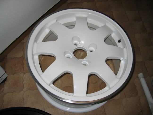

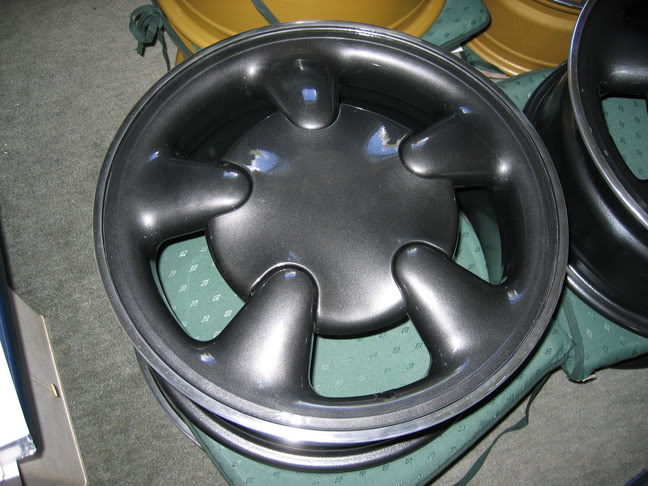

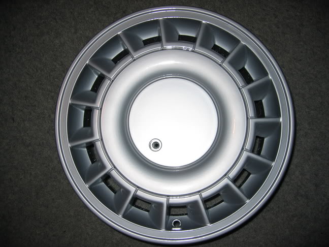

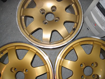

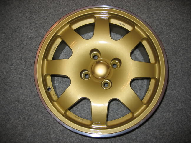

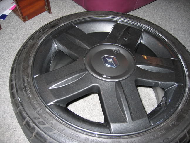

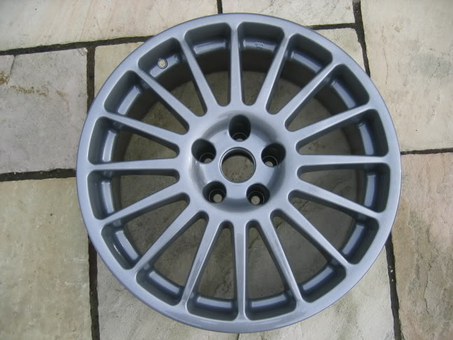

before/after

Those wheels look good Fred....where do you get them done?

i'm not a paint expert, but my friend, who happens to own the largest wheel refurbishment company in the midlands, knows more than i do (and they do 50+ wheels a day)
you put a set of your wheels on a track car and i promise the paint will get too hot and flake off, powdercoat wont
