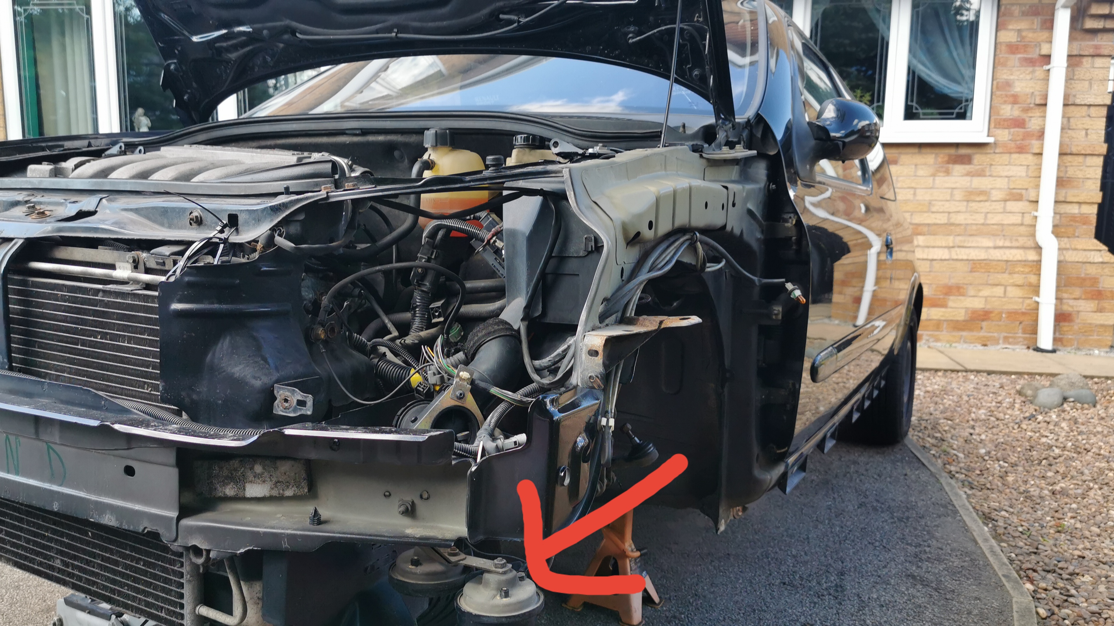

J jody391 Car clio 182 Mar 7, 2022 #1 Strange one I know! but it appears as though I do not have a horn!! Where should it be? I have seen people say under the bonnet latch area or inside the N/S wheel well.... Jody.
V VXR killer Car megane 285 sport Mar 7, 2022 #2 The general area under the airbox, same fixing point as the acoustic valve for the airbox.
OssPoop ClioSport Club Member Car Clio 200 Mar 7, 2022 #3 Passenger side under the crash bar is where it should be.
