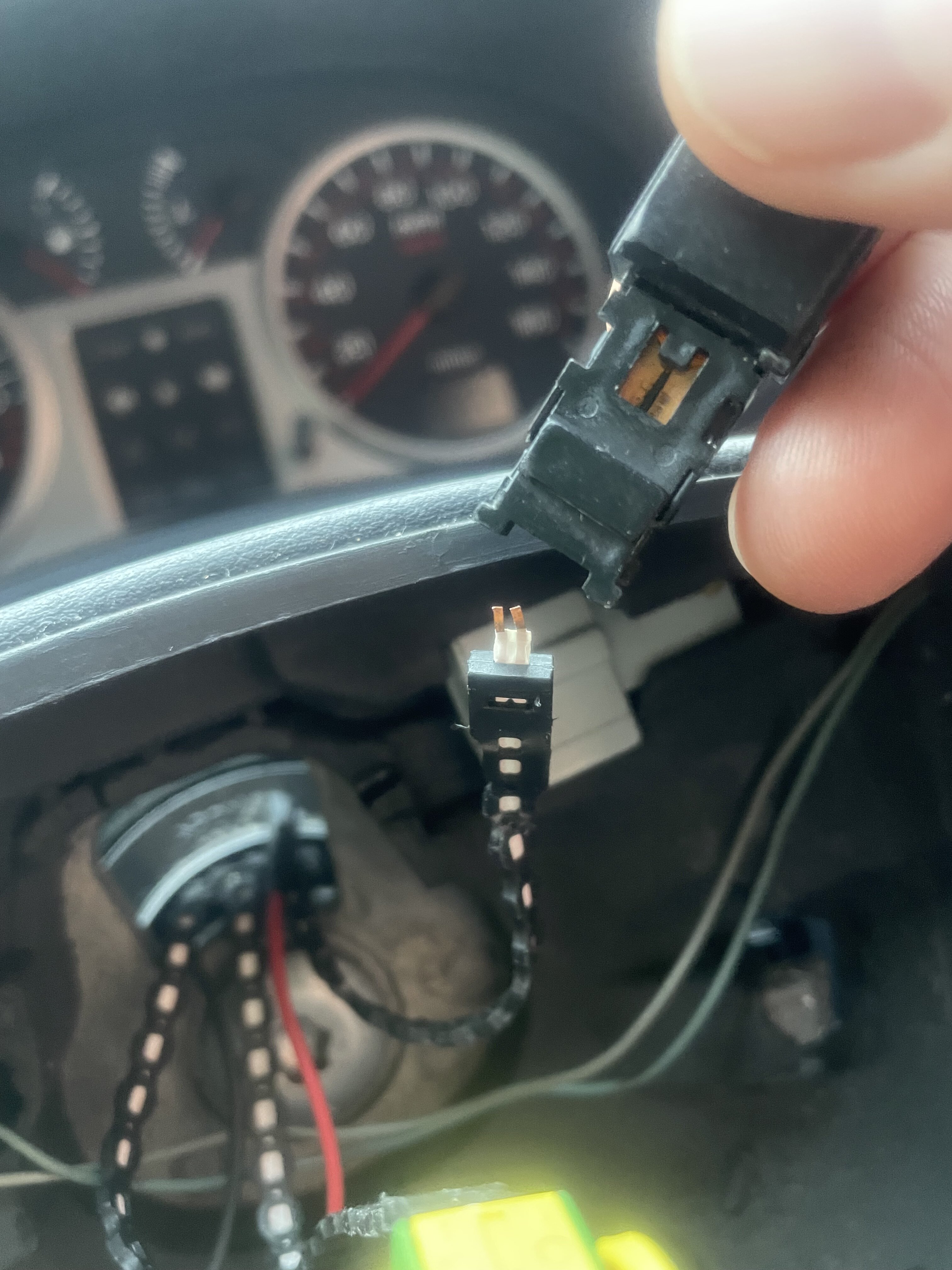

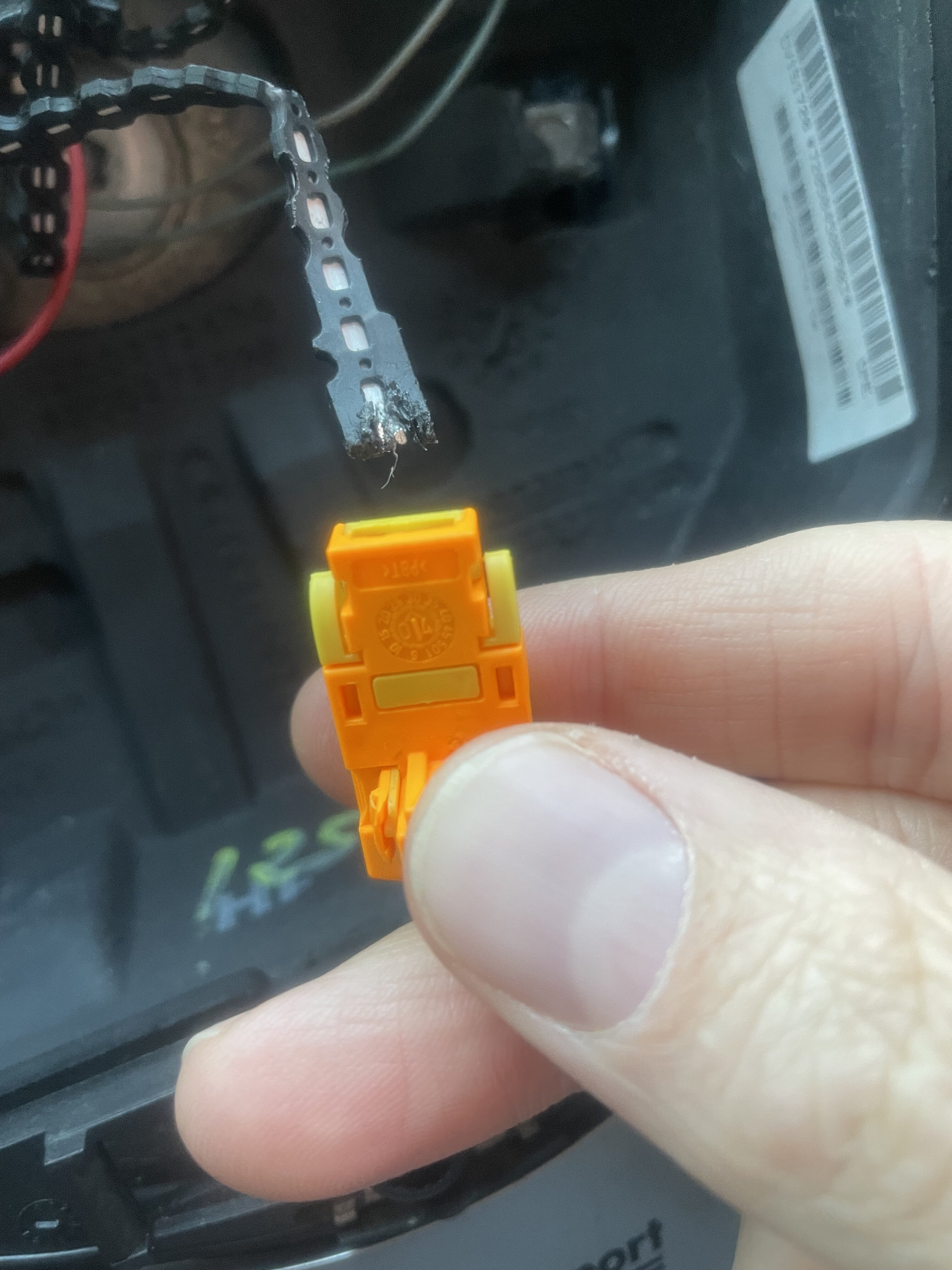

I have broken two cables that are on my 182 squib.
One , the black cruise control plug. I think this should be fixable with an experienced auto electrician?
The other is the yellow and orange airbag cable.
I am fitting an aftermarket wheel, the black plug came part when feeding it through the hub and the yellow and orange one literally came apart while I was tapping the resistor into it!
I tried to solder the resistor straight on to the snapped airbag cable but failed.
So my question is, do I need a new squib or can these cables be fixed?

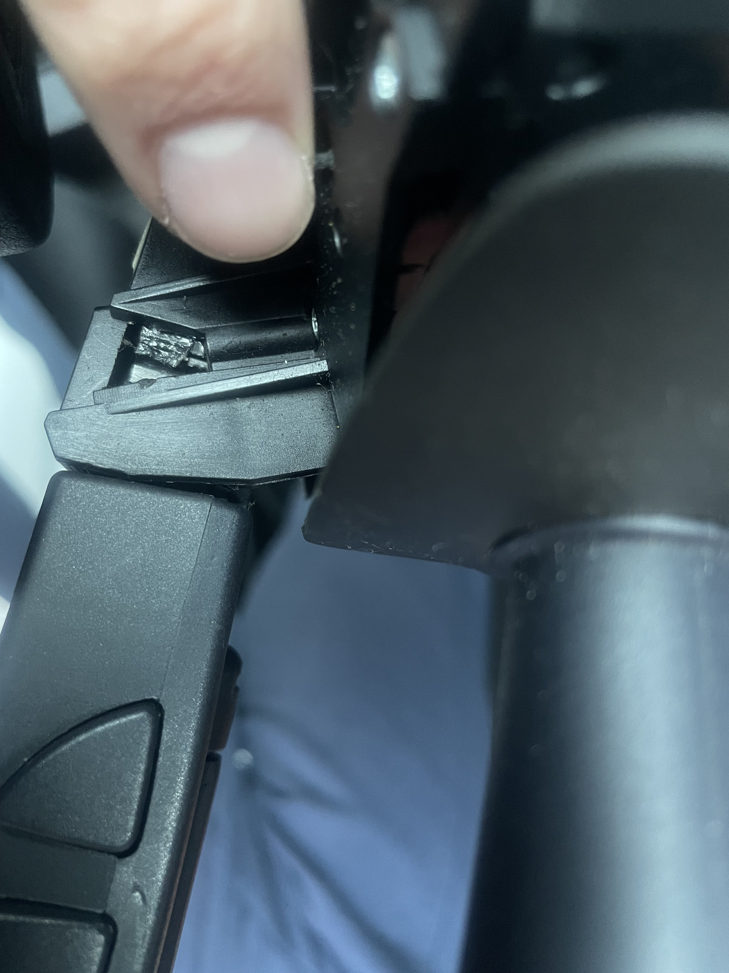

If it is a new squib, then I have another problem. It appears a previous owner has snapped the tab to remove the volume stalk and then glued it back into place.
Meaning I cannot get it off to take the plug off the back of it should I need to replace the whole squib.

Airbag is easy to sort, get it coded out with can clip instead of resistor.
Black cruise one can prob be repaired with a bit of soldering.

Thanks Brigsy.
Just had a quick look at this can clip (first time I have heard of it)
Pricey bit of kit. Am I right in saying they are worth around £180?
Or can I take it to a garage for them to code it?
Brigsy
  T.Turbo
Most garages wont have the ability to code airbag out unless renault specialists/correct software.
Not sure where you are based, but i can recalibrate it, im in the North East if anywhere near.
