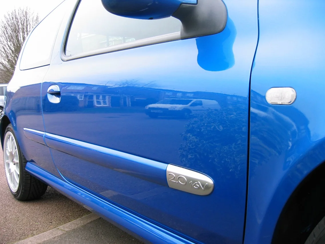

Have done the clay, SRP, EGP routine and wondered which Carnuba Wax I should use to add the finishing touch to my 172 Cup. Are the carnubas different for different colours or doesn't it matter?

You will get slight differences with all Carnubas.
I love P21s on Blue for the 20 quid budget.
If you have a little more to spend Swissvax Onyx @ £39.
If you just want additional protection over the EGP go for some Meguiars 16.
