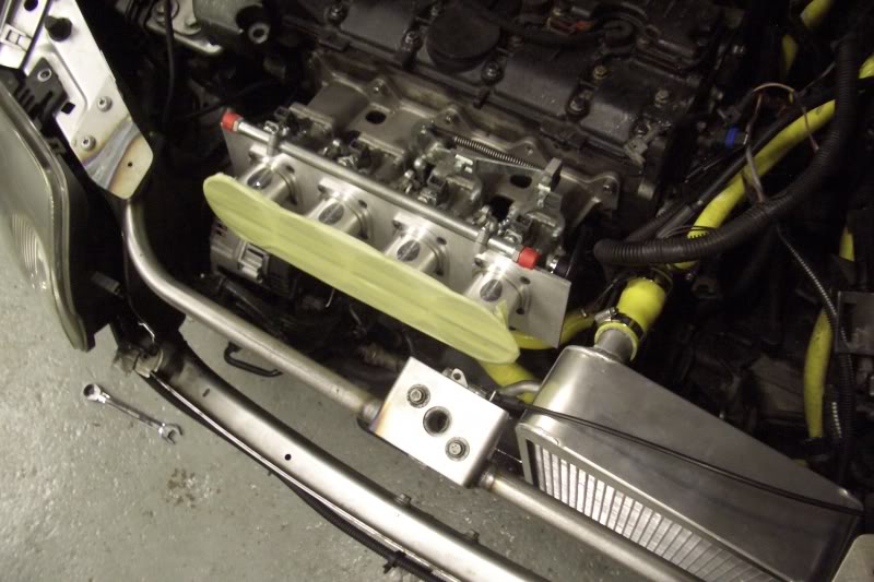

Cheapest option at the moment is buy the bodies from kam racing (20% discount) and sort out your own ECU & loom.
You could get the whole thing done for around > £1900 if you source the bits right. (obviously will vary depending if you fit yourself or not, I personally would want someone else to fit them)

Am I right in saying the AT bodies don't cut in to the Slam panel? If so then for that reason I'd probably go with them - also Ben's setup is mint with AT TBs.

slightly daft due to the costs involved but still, got a decent intake length and kept the oe bonnet latch etc etc, didn't even chop the plastic grille
