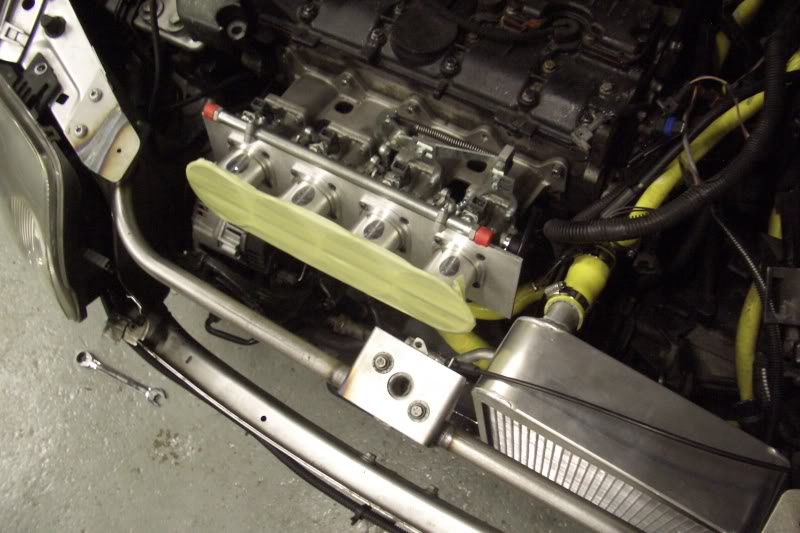

slightly daft due to the costs involved but still, got a decent intake length and kept the oe bonnet latch etc etc, didn't even chop the plastic grille
its cool to see everyone's different installs, the clio market is in a great place at the moment in terms of development!
Thats very impressive mate...
Solved alot of problems there!
I had a similar aluminium panel in design for the front section, but not considered moving the rad to the side...good shout!
and no, cant say ive ever baught a copy of french car :p
  Lionel Richie
still not sure on the cooling abilities LOL! volume is up slightly over stock so fingers crossed its got enough airflow and i chose a big enough rad fan!

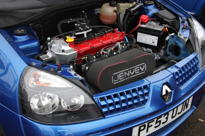

Does Neil have a different cam / rocker cover, What's the circle shape near the front centre?! Sure thats not all other 1*2's I've seen?

tbh you'll gain efficiency from being fully aluminium, the rads I use are less volume than std, but cool about the same.
if airflow is an issue, you could always run a scoop from the left hand side of the rad acrosss the front of the bumper.

they're unusual, but theres a few about. K4Ms have it but there's actually a core plug there like the cam blanking plugs. Renault randomness
here the k4m bung in question
i also smoothed the cam cover, you can see a smooth bit just to the right of the filler neck :eek:
