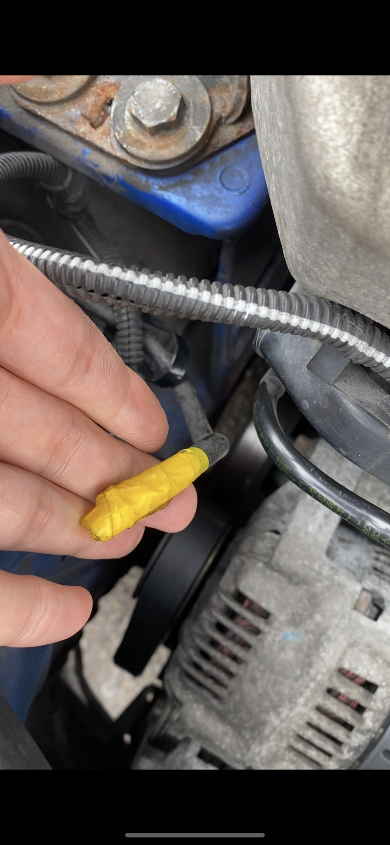

It's the other end to that bit you found the other day. Part of the carbon canister I thinkIt runs to the rocker cover by the looks of it (if it’s not clear on the video)
Video not showing for me...
Take a picture.
Its not great but it’s running from my rocker cover under the inlet manifold to the back of my drivers headlight and it’s just covered in electrical tape .
Yeah that will be to what was the carbon canister. Hard plastic pipe is it?
You can remove it from the inlet and fit a silicone blanking plug.
can you remember what size blanking plug I need?
15mm on the 172! Bought one now.Might be different on the 172 i think, but my 182 i used an 8mm.
Might want to check.
