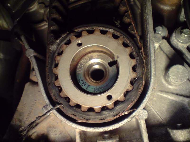

Well no, it's never a good thing having a belt snap, but if the aux belt snaps on the f4r they're particularly prone to wrapping round the cam belt. Hence the bent valves and knackered engine.
On the 8v it shouldn't affect anything

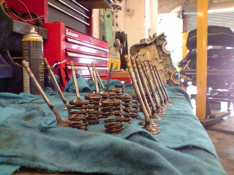

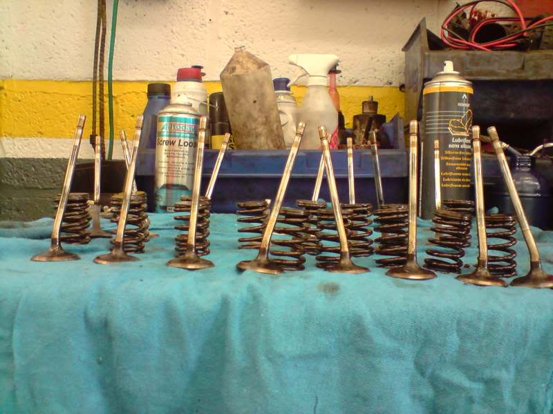

Is it just me or can I only count 15 valves there

4th in from the left is snapped :rasp:
