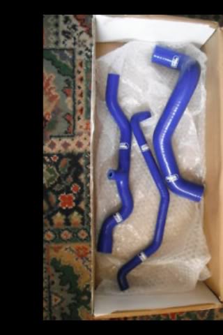

Wich coolant hoses are these?
Car  182
What hoses are these on the 182 i cant work it out lol?
I don't think they are 182 ones?
As the main one is one hose?
When i replaced mine the ones from the radiator to the engine, bottom of the bottle was one single hose
middle hose is top of stat housing to header tank
right hose is top engine outlet (at stat) to rad top hose
left hand hose looks like it's been cut as the lower section of hoses is a complex series in one piece. The part that's there goes from the bulkhead to the outlet under the temp sensor.
Ones bottom of rad to engine (next to the oil filter) the others top of rad to water pump, The others headertank pipe, hope this helps. The one at bottom of rad is a bugger to fit!
