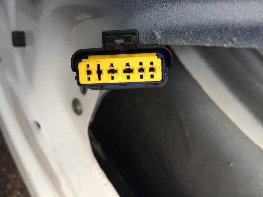

Ive stripped it all off and yes to be honest looks damp in there! a felt covered wire is pretty sopping wet.
What Part(s) would need to be replaced? Would i be able to do it at home?
Is the terminal on show here. Or behind the metal skin?

Take the yellow insert out of the connector with a flat blade screwdriver and u will see the discolouration tell tale sign it's the cause is if it starts working when u reconnect it but I would put money on water ingress being the issue
  Clio sport 172 cup
To sort the problem u will need a new door loom and possibly regulator depends if the unit on the regulator has ingress on the terminals
