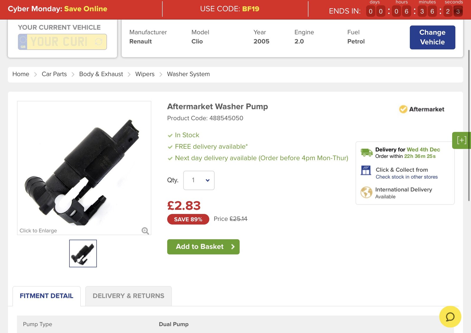

I bought 2 of these a few weeks ago..£13 each..now they're £1.90 with the discount! I'm buying 2 more for spares....

I bought 2 of these a few weeks ago..£13 each..now they're £1.90 with the discount! I'm buying 2 more for spares....View attachment 1443053View attachment 1443053
I purchased 2 of these thanks for that cant believe how cheap they were haha!
