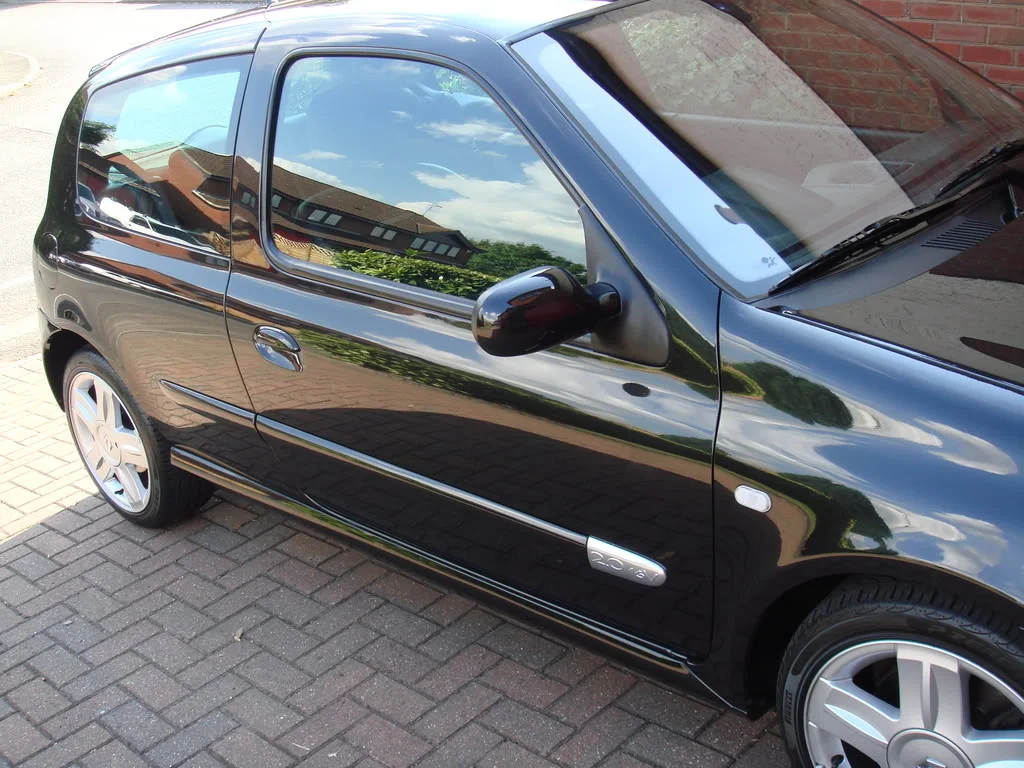

A few shots of the 172 after a "proper" detailing session in September, wish I took more photos from a distance, I got carried away with close ups and details to get an overall look at the car lol. Will do next time!
Anyway, spent 3/4 days a few hours at a time prepping my car as best I could for winter and for returning to uni as I knew I couldn't spend much time there cleaning the car.
Did the whole process, exterior, interior, engine bay - down to cleaning out the glovebox and wiping down the crummy leather folders which all the car's documents are kept in. Only thing I couldn't do which I would have liked to was properly seal underneath the car and paint the brake callipers gloss black - I hope to when I get more time.
Anyway, process was:
Exterior.
  • Pre-soak with mixture of Chemical Guys Maxi Suds and Super Snow Foam, delivered via Super Spray system. Will be getting the Karcher and Autobrite Foam Lance over christmas if I have been a good boy ;).
  • Wash using lambswool mitt and 3 or 4 bucket method - can't remember those details! Chemical Guys Extreme Wash N Wax was used.
  • Clay using Sonus Green and a mixture of shampoos and QDs and water.
  • Rewashed with using above method.

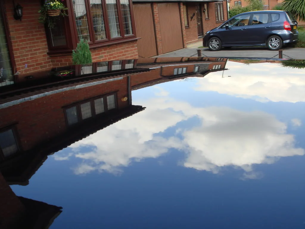

  • Machine polish, Menzerna Intensive Polish, Final Finish and Autoglym Super Resin Polish via PC, using Sonus 6" and 4" pads.
  • Sealed first using Chemical Guys Wet Mirror Finish, a coat of Extreme Gloss Protection then another of Jeffs Acrylic spray sealant for good measure!
  • Waxed using Collintes 476, and then layered with Swisswav Onyx. This was the first time I used Onyx and even now 3 months later still looks awesome - will be using this again very soon! :cool:
  • Wheels polished using Autoglym Super Resin Polished, sealed with Chemical Guys Jetseal 109 (sample courtesy of Riz, cheers mate) - a couple of layered, then finished with some more 476s.

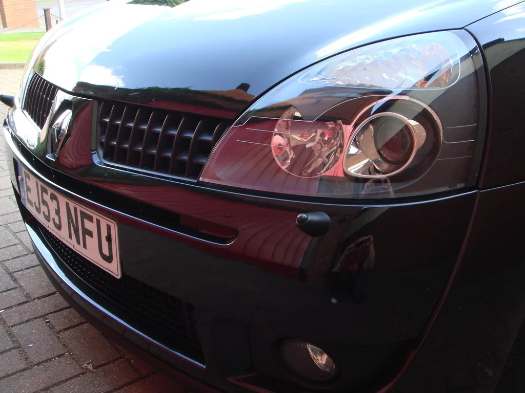

  • Arches cleaned with Autoglym Engine and Machine cleaner, sealed with Sonus Motorkote.
  • Tyres dressed with Blackfire Tyre Dressing and some Chemical Guys New Look dressing.
  • Windows polished during machine polish stage, sealed with 476s.
  • All plastics dressed using a variety of products.
  • Enginebay cleaned, dressed and sealed, with many of the products mentioned.

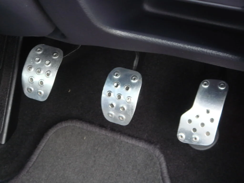

  • Metal polished using Autosol and Super Resin Polish.

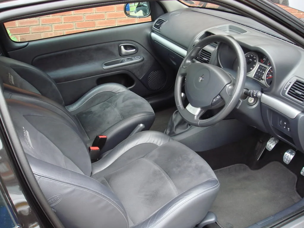

Interior.
  • Hoovered out, although was pretty spotless before hand.
  • Matts cleaned using some generic valet brand cleaner - does the job!
  • Alacantra wiped down using a slightly damp microfibre cloth.
  • Leather cleaned and conditioned using Gliptone products.
  • All plastics dressed with Chemical Guys Silk Shine dressing.
  • All faux-metal pieces buffed with a microfibre towel and some QD.
Anyway, sorry for lack of pics - and also the size of these images, if anyone knows how to resize let me know please! Also how to do those cool black borders I keep seeing! :cool:
Cheers
Tom
  Skoda Fabia vRS
what are you using to resize your images ?.......they dont seem to have turned out very well
  106 GTi
Looks superb only 3 months late, love that flake pop on the tailgate but can see the final niggly few swirls that a mare to remove.
  Mito Sportiva 135
Cheers.
Yeah Rich noticed those marks too - you can't see them in normal conditions, I think the sun being directly on them brought them out - but I do accept leaving some minor marks rather than risking going through clearcoat, I am anticipating keeping the car for a while and there a few marks from the first owner (Although he kept very good care of it!) so want to keep a decent amount.
